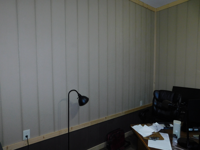

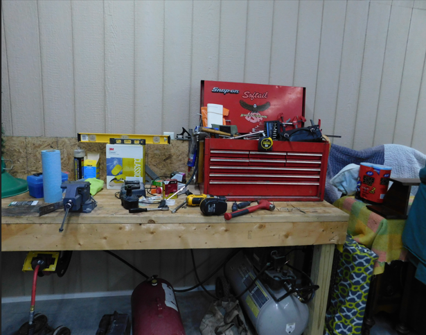

We just built a place last summer. Ours has 10' walls, so what we did might not be the best answer. We used 4 x 8 primed Smart siding. We left it all the same in the shop area (no trim other than a vinyl 1-x along the floor). We put metal on the ceiling along with LED lighting. The Smart siding made it easy for us to do the wiring ahead of time versus having to use conduit or leaving wire long to get placement correct.
We used same stuff in our offices, but put a wainscot along the bottom.
When we bought this, it was $35 a sheet. I think at the time, metal was $50 for a 3 x 10 sheet.
We did drywall the small rooms (we put closets in each office and a full bath between them) as there is lots of waste in a small room with the 4 x 8 sheets.
Not sure if this is a good plan if you are going to be cutting / welding near it. Water is no issue as this is an exterior product.
Maybe a wainscot of metal.

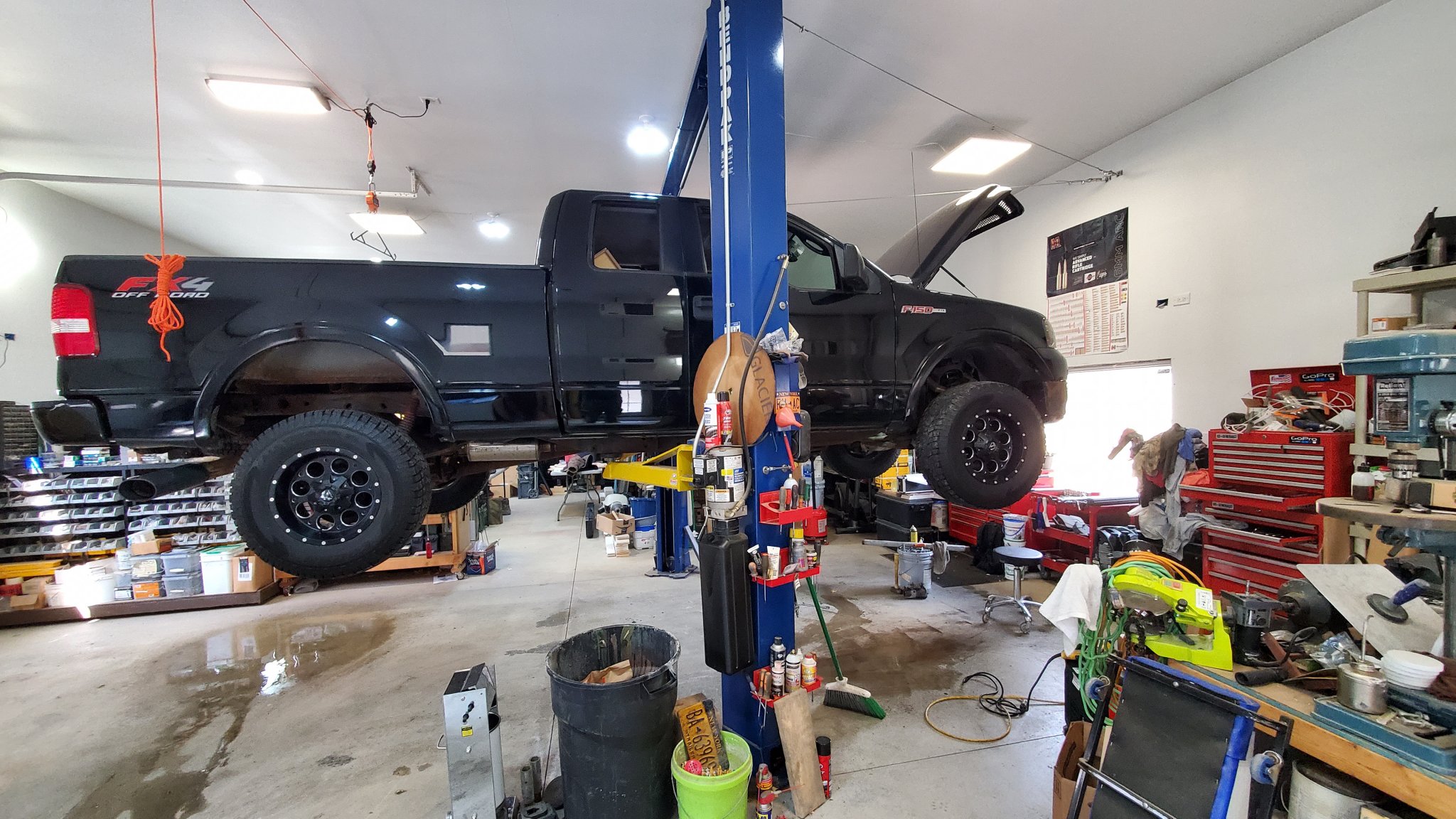

This is the only photo I have on my phone of mine, my sides are a tick taller at 24' and mine is 20x30. Personally I really did not care and don't care what the inside looks like as long as it works. IMHO there is no such thing as too much light, you can have light in the wrong place however. I guess you have the bathroom and such in the shop so that is out. Only thing I can add if you don't need that height everywhere, I needed it that tall for a two post lift in the center, you can build storage along the sides. I have been for the past month doing just this. It is almost done, hopefully one more weekend then the wood will be done.....I hate wood. Then it is moving tools and junk to that "second level" and making some floor space.

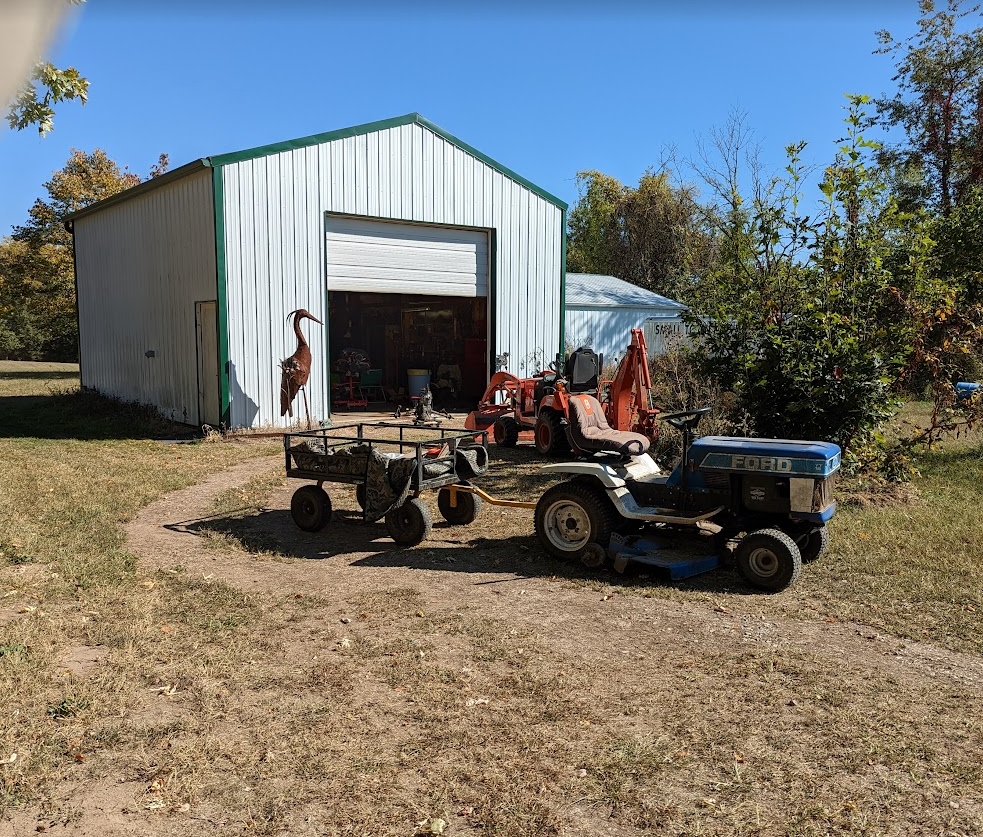

A pic of my shop, I just put in a sink last summer, it is so nice to wash your hands. I just use rain water off the building.
For reference the big crane (bird) is over 6'.
Just re read that for errors, sure there are some. But I am building a loft. It is 8' over the floor, and comes our roughly 5' from the edge of the building. It will basically run down the side across from the crane.
