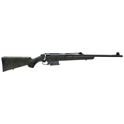

Check out the Tikka Drover model specifically! Iron sights, CTR 10 round Magazine, threaded barrel (not sure of pattern). Looks like a sweet model

I used to own a version of this in 9.3x62. They are an unreal setup.
Why is this the first I've heard of that? It isn't even on the choose.Tikka.Fi site. I wouldn't use it anyway but it is good to know of to help others.
Yeah I happened to find it just by scrolling Eurooptic. Couldn't figure out the thread size, but if I were in the market for a hunting rifle... I'd do something like that.
Reactions: LeftyJason
I looked at the drover quickly today actually. Thanks for all the good tips. I'll give it another look. Does anybody know if those iron sites come off? I would imagine they do, and I would imagine they would be in the way of my low small scope.
