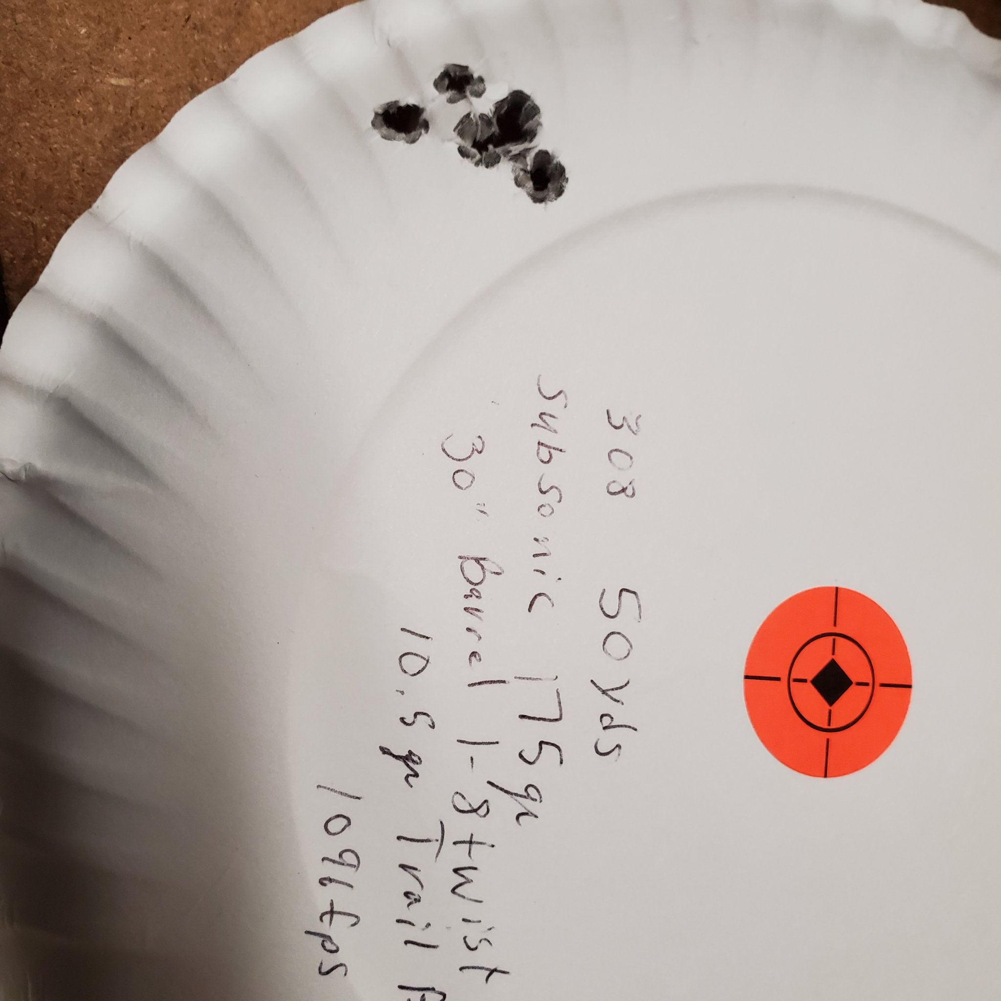

I run 308s in 12, 11.35, 10, 9, & 8, 16" to 30" barrels, auto, bolt, SA and LA.
I prefer 9 and 8 twists for most uses.
The 8 twist 30" barrel is very accurate with supers and subs 130 gr to 230 gr Atip. 250 gr works too but needs a longer throat for real performance, in supers, but have not tried it with subs.
I have shot nice groups with 308 subs with 175 gr match bullets, with most of the above twists.
Even used shotgun primers in 308 subs, in modified cases.
