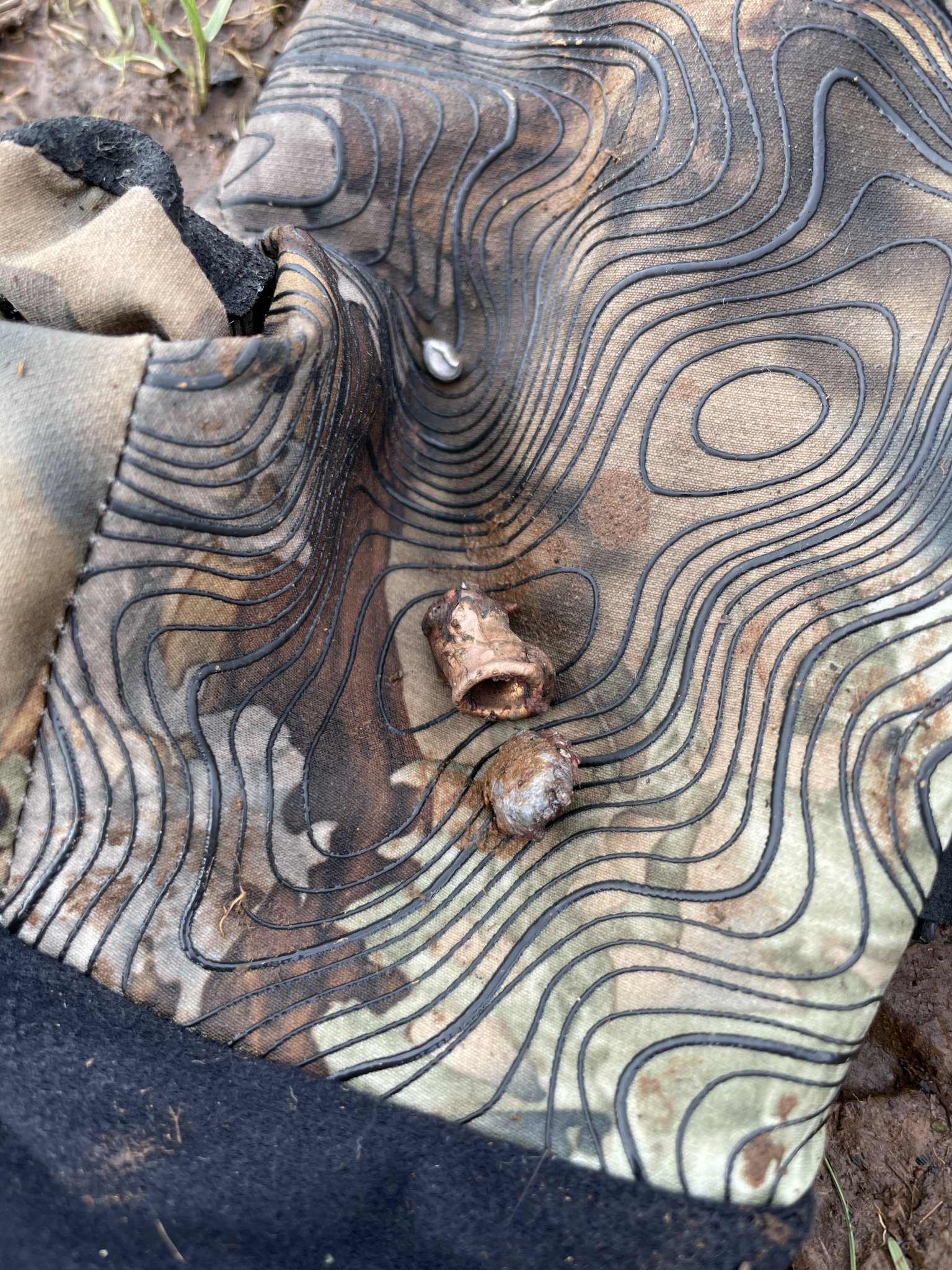

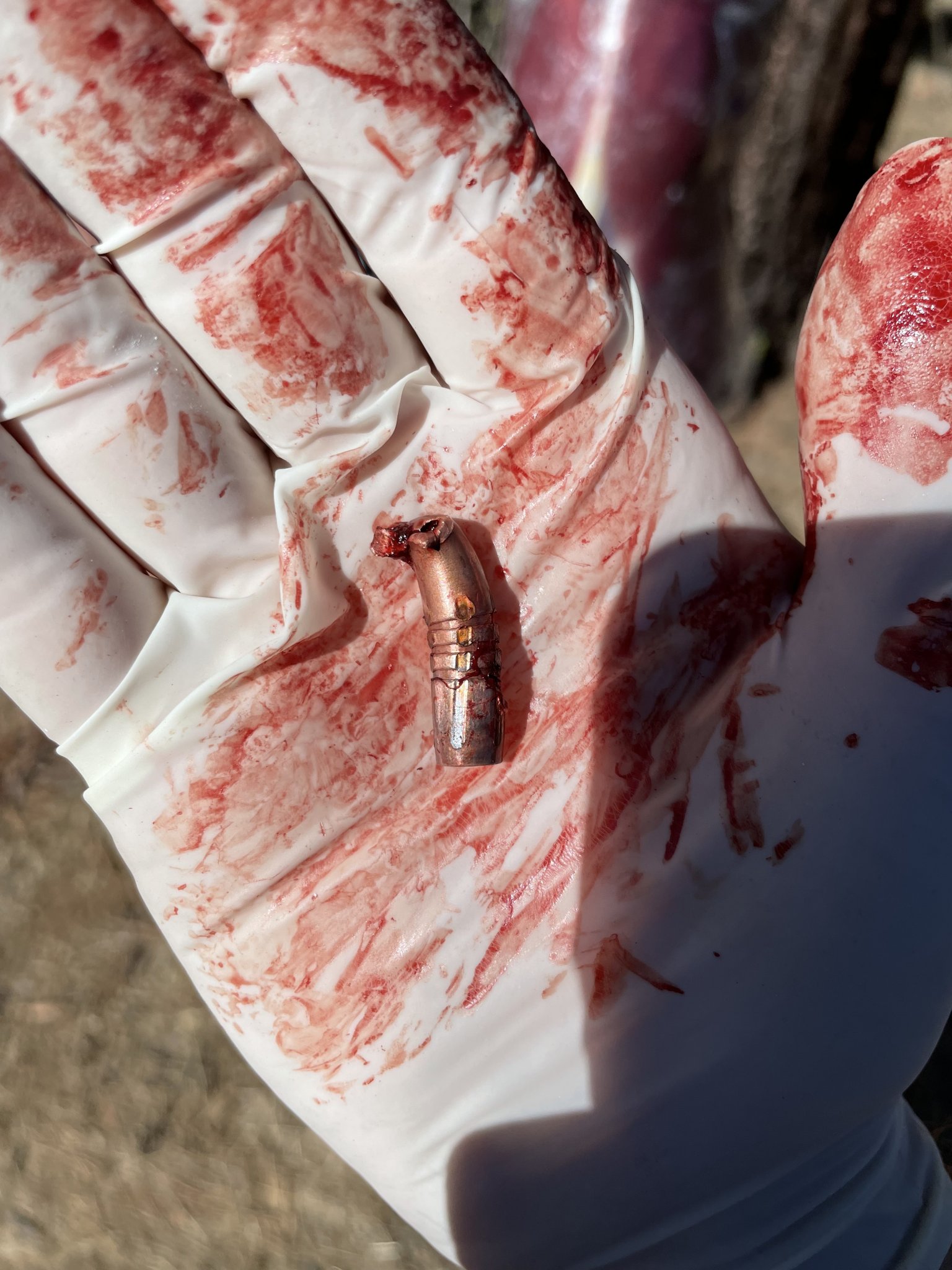

I hate solids, they do a poor job of expanding and many guns are very picky about shooting them well. A buddy point blank shot a deer two seasons ago with his 300winmag, maybe a 7yd shot, and the bullet went the entire length of the animal without expanding.
What bullet is this that did not expand?

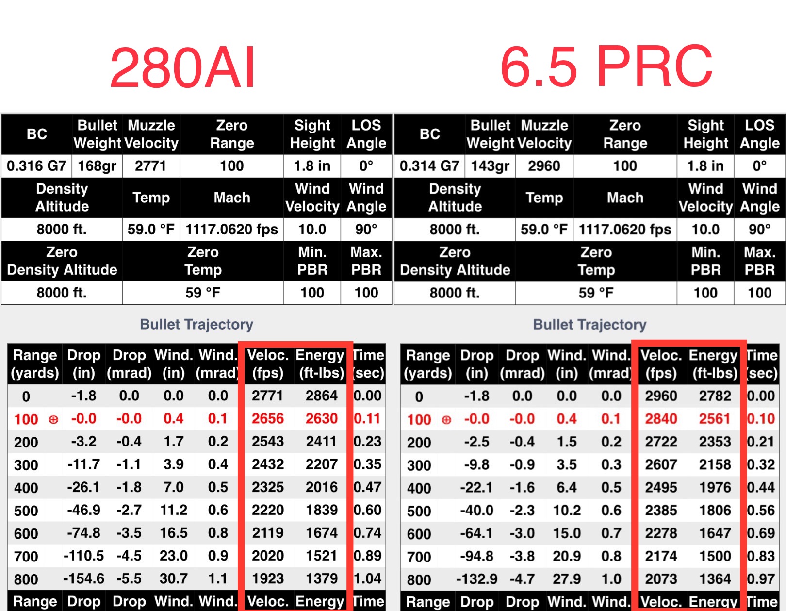

6.5 PRC is an awesome choice. Plenty of great options for boxed ammo. If you go the handload way, the brass is readily available from Peterson, ADG and Lapua.
Here is a comparison between my former 280AI Hand-loads 20 inch barrel and factory Hornady Hunter Ammo 143eldx 24 inch barrel. As you can see it maintains 1500 ft lbs out to 700 yrds ( at 7200 ft above sea level 50° day)
I believe these are pretty modest numbers, compared to what you can get out of it handloading.

Except for that 1,000 round barrel life on the 6.5 PRC, and you can probably double that easy on the .280 AI.
I know... I have one. I wasn't telling the OP that's what he should build, I was pointing out barrel life difference is massive between the 6.5 PRC and .280 Ackley, despite them putting down similar performance, because that's what the person I quoted used to compare.

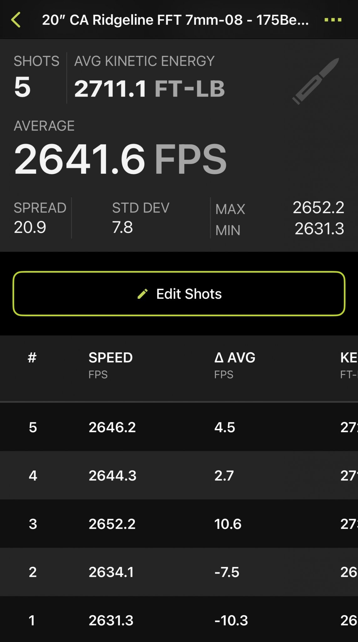

I agree... They should try seating some Berger 175 Elite Hunters as long as possible that still fits and feeds in their rifle (which will be a long jump, but will be ok), with StaBall 6.5 and CCI 200's in their 7mm-08...
Definitely don't try that at all once you realize you can push them upwards of +2,600 FPS MV creeping up on the heels of the external ballistics of a .280 AI with the same bullets... 😈

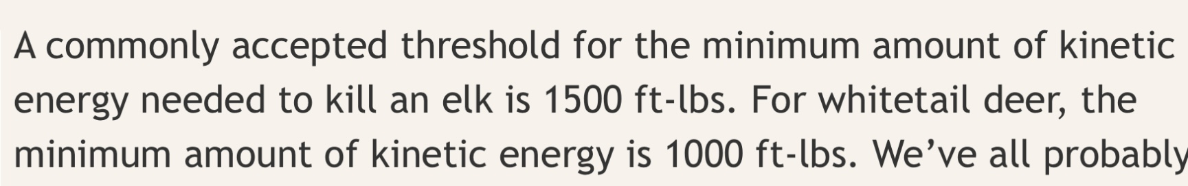

Well hells bells, I guess somebody forgot to tell all the elk Ive killed at ranges beyond 225 I guess. Funny that CPW says a 35lb bow is fine but you need 1500lbs energy with a rifle. LOL.
Yeah that was just a quick source. I probably should have picked a better one in my haste. Sadly even Wyoming Game and Fish here, is being infiltrated by a bunch of wokesters. Sad because when I started hunting here in 2012, they were nothing but awesome folks (the ones I interacted with).
On your point about arrows, you are exactly right. I’ve said this many times to people when talking about how much power is needed to drop an animal. Shot placement is more to the point.
