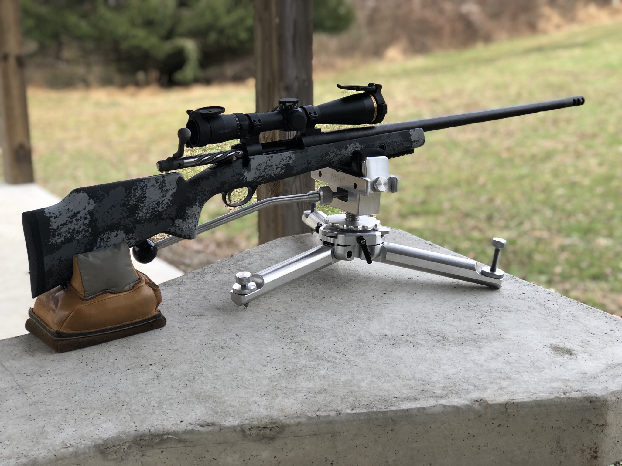

Defiance Rebel Sheep Port intermediate length
Proof carbon fiber barrel 24in
Manners carbon fiber stock
Jewell trigger
Talley rings
Leupold VX5HD 3-15x44
300WSM
Under 8lbs as it’s sitting. Absolute hammer
