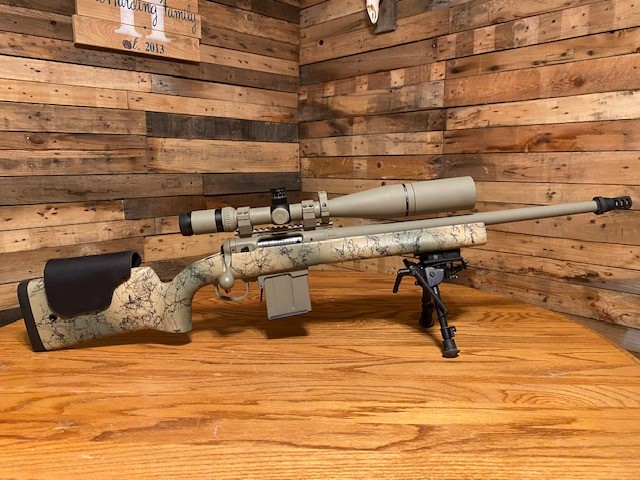

My Bighorn Origin feeds swimmingly. The big 10 round MDT BR mag is big and heavy and expensive but feeds very well. Most of the time, I just run a 5 round Magpul. The bolt will stop if something is pushing up on the Magpul mag, but will push forward the moment pressure is off the mag. I'm sure I could cure in with 5 minutes with a file, if I'd just take the time.
Brass is Lapua. Which ain't cheap, but nobody complains about sucky Lapua brass. Run Redding Bushing dies, as their standard FL die has a WAY undersized neck. I run a .259 as a step down on 6mm, then a .250 to finish and re-size. You could also do a Hornady Bushing or a Forster with a custom honed neck, just steer clear of the Redding FL. It will buckle shoulders.
I do have donuts, which can be a bit tough to chamber on the first firing, but they've pretty well worked themselves out after a couple firings. You can neck turn, if it's that big of a deal to you.
Mine's a 15lb rifle (all up) with a Rem. Varmint contour barrel in a KRG Bravo with a 9" SAS Arbiter Suppressor. I don't have to check the primers to be sure it went off, but it's close.:)

For those that are interested here is the finished product. 22BR.
Rifle Specs:
Savage 12 Target Action w/ Target Accutrigger
Criterion SS Match, 20", 1:8, 22BR, Lite Varmint contour
Manson 22BR reamer, .252 neck, .050 freebore
YHM QD brake
YHM Turbo 5.56 Suppressor
SSS Improved ejector/extractor
Accurate-Mag AICS bottom metal
MDT 12rd 6BR magazine
HS Precision M24 stock w/ custom cheek rest (my design)
EGW 20MOA base
Vortex PMR rings
Vortex Viper HS LR 6-24X50 FFP
Current Loads:
Lapua 6BR Norma brass, necked down to 22cal and neck turned to .248 (loaded)
Sierra 77gr TMK
Alliant PP 2000-MR
CCI #450 primer
400yd ladder showed a very nice node from 30.4-31.0gr, grouping 1.120 vertical by 1.300 horizontal at approximately 2940fps. I can push these over 3100fps from my 20" barrel, and there is another node at about 3050fps but not as tight as the lower node, so accuracy wins. Couldn't get the 80gr ELD's to shoot in this rifle at all so I was pretty bummed about that, but the TMK's will be fine for my purposes and I'll get a little more practice judging wind. Waiting for a calm day to stretch it out and shoot a 700yd ladder, but wind speeds have been high around here lately.
