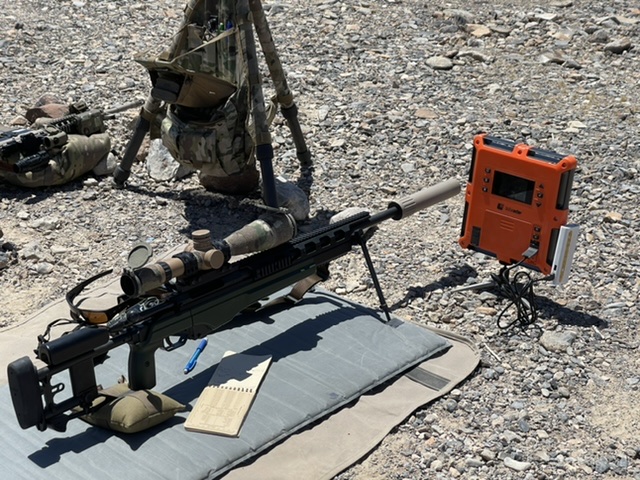

22” is as short as i would go in the win mag. I have no problems hitting steel out to 1200m on calm days but any wind does toss the bullet (185 berger jug) around like a rag doll beyond about 800m.
ETA: Im getting ~2900 fps w/185 jugs.
Here’s a shitty pic of my trg42 w/22” bbl and AAC Titan.
