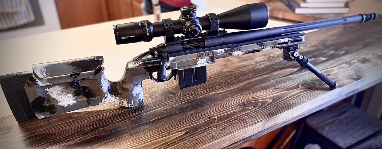

I’ve currently got a rifle that I’m trying to dial in and hoping for some help to keep from chasing a issue since ammo is hard to find at the moment.
Picked up a model 12 FV a few years back on a Black Friday sale in .308 came with a 26” barrel at the time. I wanted something to throw in the truck and do whatever with.
Paid 275.00 after the rebate so figured I’ve wasted more money on dumber stuff so why not. I chopped the barrel down and rethreaded it at 16.5”. Dropped in it a Boyd’s and rocked on.
Believe it or not it was a sub MOA rifle before taking the barrel down to 16.5”. It shot a 150gr great. It doesn’t seem to like them anymore and I also tried 168 SMK’s. Same results. Shoots about 1.5 MOA now. I’m shooting it suppressed so wanted to know if there was anyone out there with a similar deal who has had good luck with something else. Thanks for the help.
