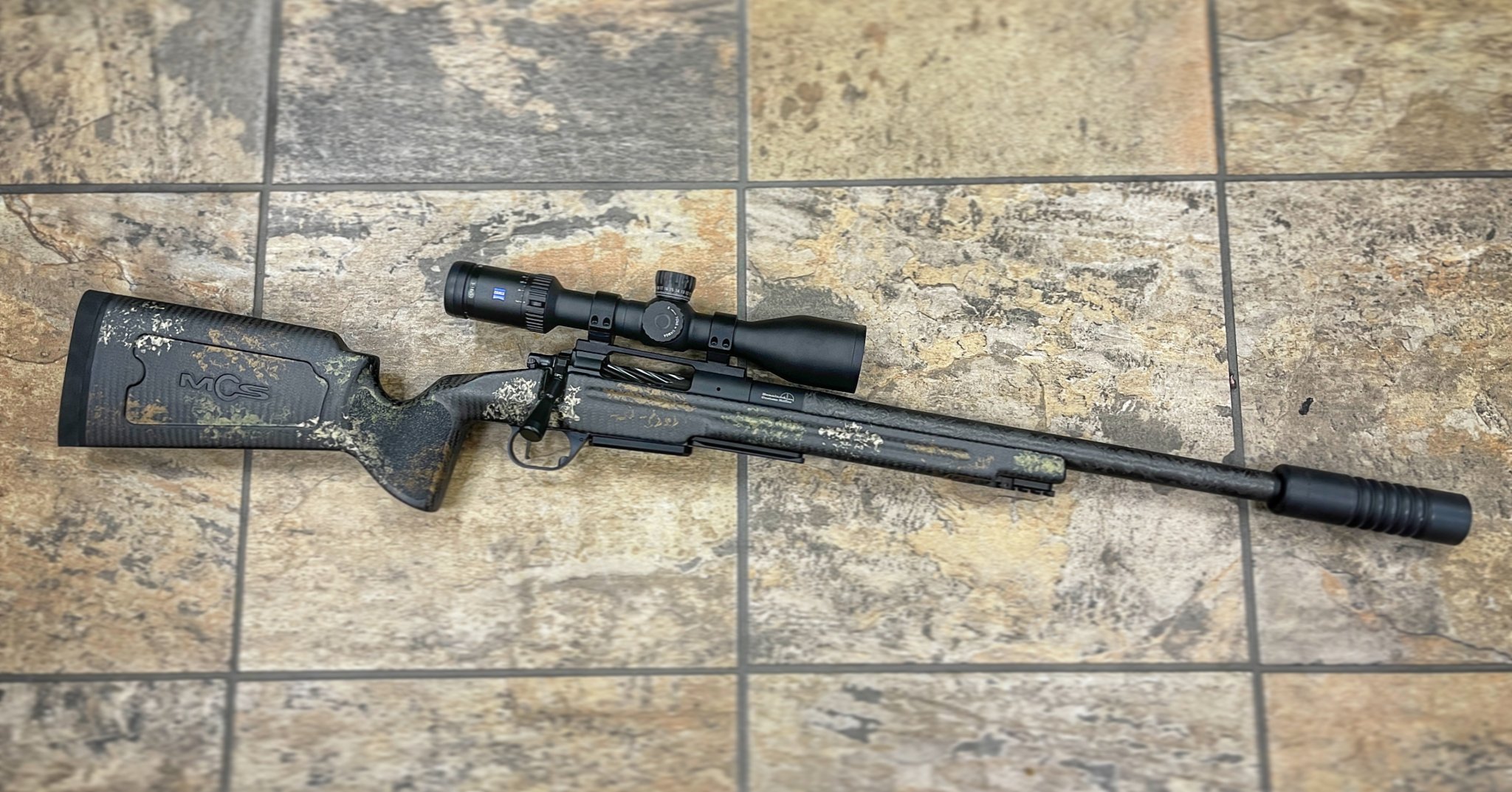

Short barrel 6.5 prc
Midt
Nov 24, 2017
11
2
Considering building one as hunting rifle . We mostly sit in blinds, by the time you hang a suppressor on the end of it, rifles get long and awkward to maneuver inside .
Was thinking 16-18 in barrel .
Don’t fool with reloading, don’t have any time for it . So everything would just be factory ammo .
With the short setup, am I just eating time/money ? Will it offer anything better than a good ole 308 setup similar?
Original plan was 300wm w 18 inch barrel, but based on reading so far sounds like that’d just be a really cool fireball making machine .
End goal is basically a short barrel elk rifle for lake of better description

I have a 16.5” 6.5 creed barrel that runs a 123 Scenar at 2820 fps, a ways below max load, with h4350.
Awesome handy rig.

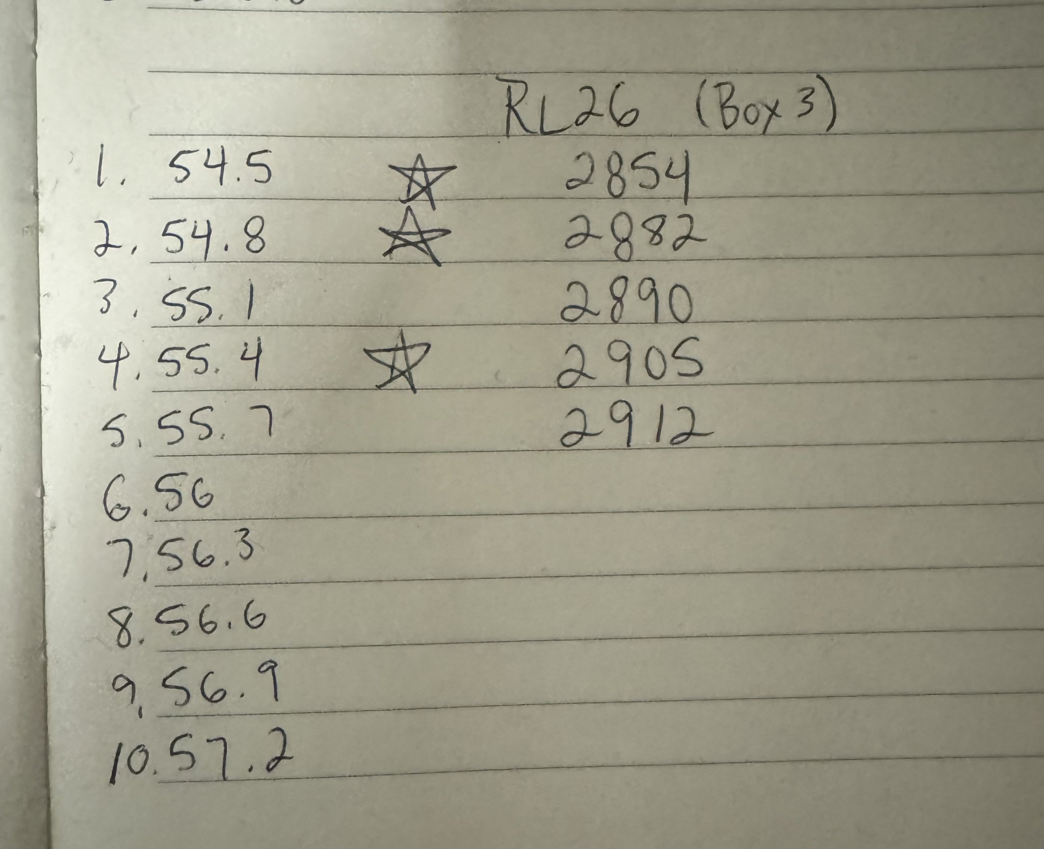

Holy hell. Care to share that recipe?
I'm getting 2706 fps from factory 143 eld-x in my 20" barrel. Sounds like I should be able to push a 140 to 2,950 fps.
It’s that magic dust, RL26. I stopped after 55.7gr as I was seeing some pressure.
Edit: this is lapua brass and br2 primers
I hit 2,950 with a 140 elite hunter in my 20” 6.5PRC with 58.3 grains N560. Lapua virgin brass, F210M loaded to 2.950” COAL. Barrel only had 30 rounds down the pipe when I took it hunting. Might pick up some speed soon once it settles in.
