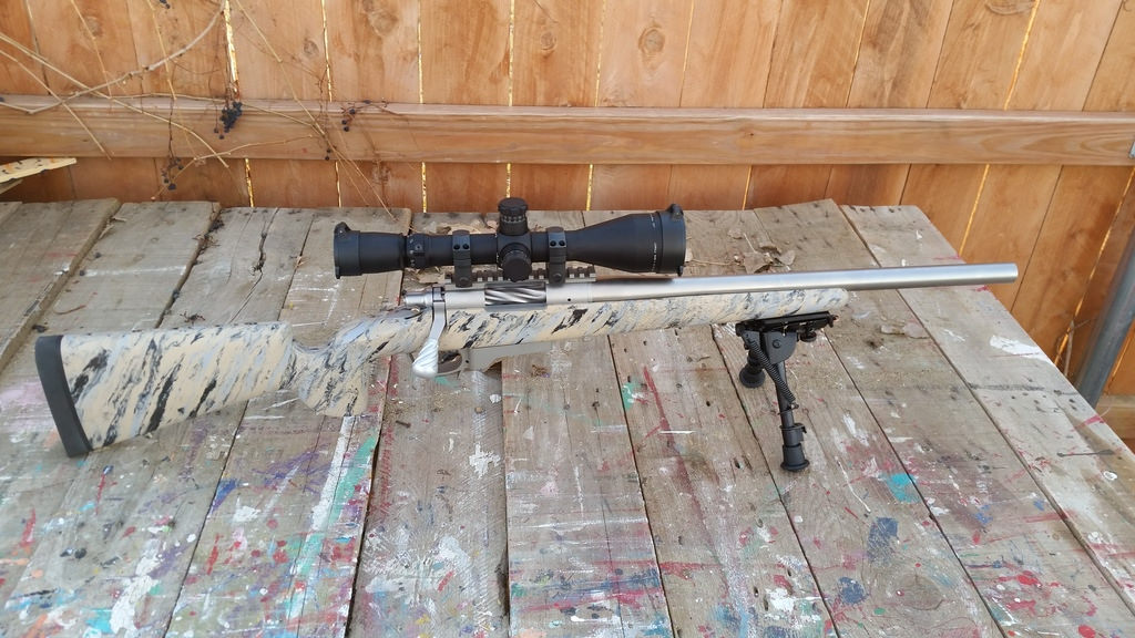

18" Rem 700. It shot the Hdy American Gunner 140gr HPBT factory ammo into tiny groups. Velocity was ho-hum, but very accurate.
Very nice. Looks like I'll stick with the 6.5mm, all the recent chatter about 6mm had me second guessing myself.
