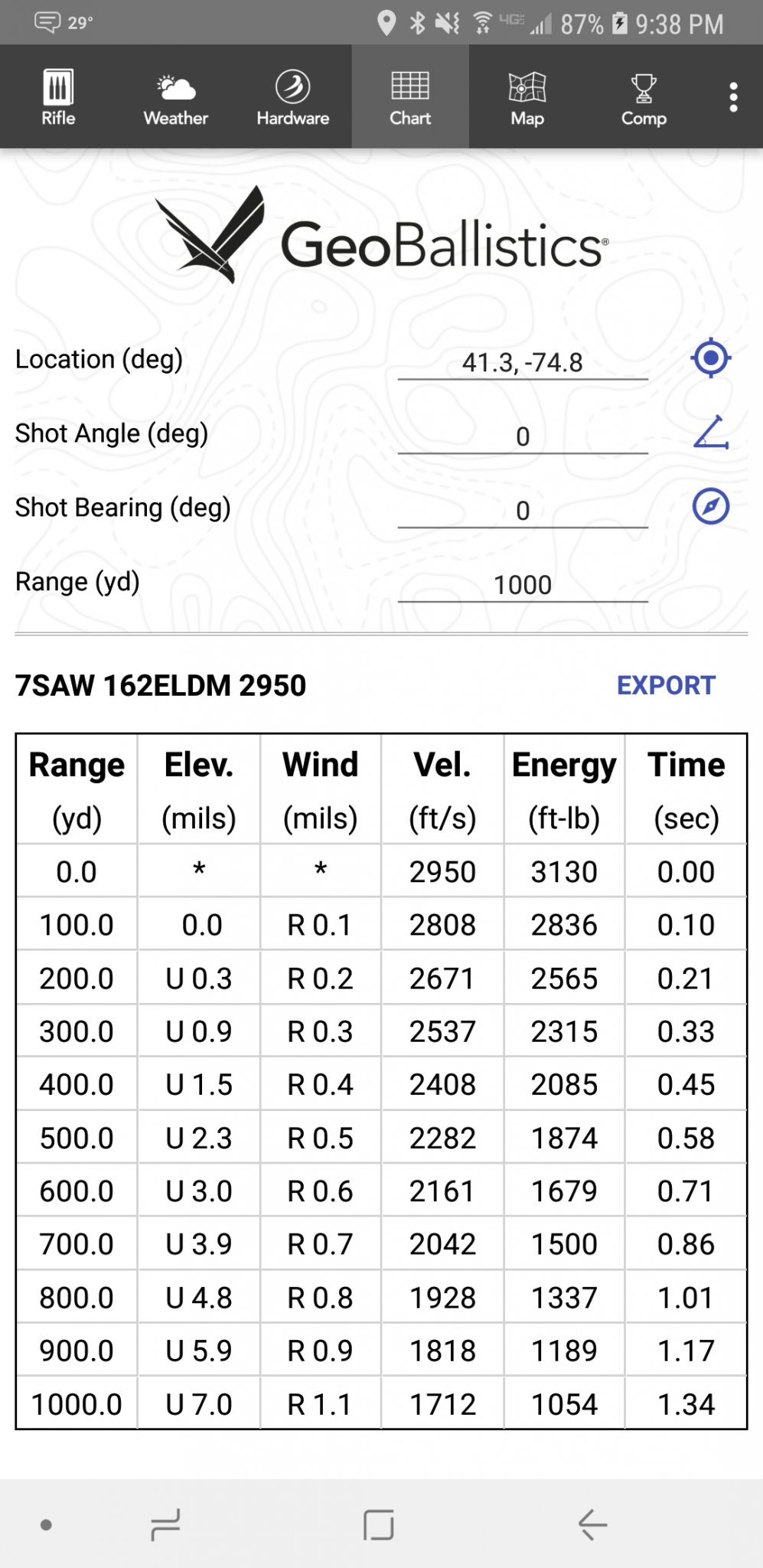

down there. But 7SAW can push a 162 around 2900+ and a 180 around 2700+. 1k energy at 1k yards. Starts life as 308 small primer brass and just run through a die.
A 7-08AI gets close too, but with fireforming
7.5mpg wind for reference(100y intervals matching .1mil)
