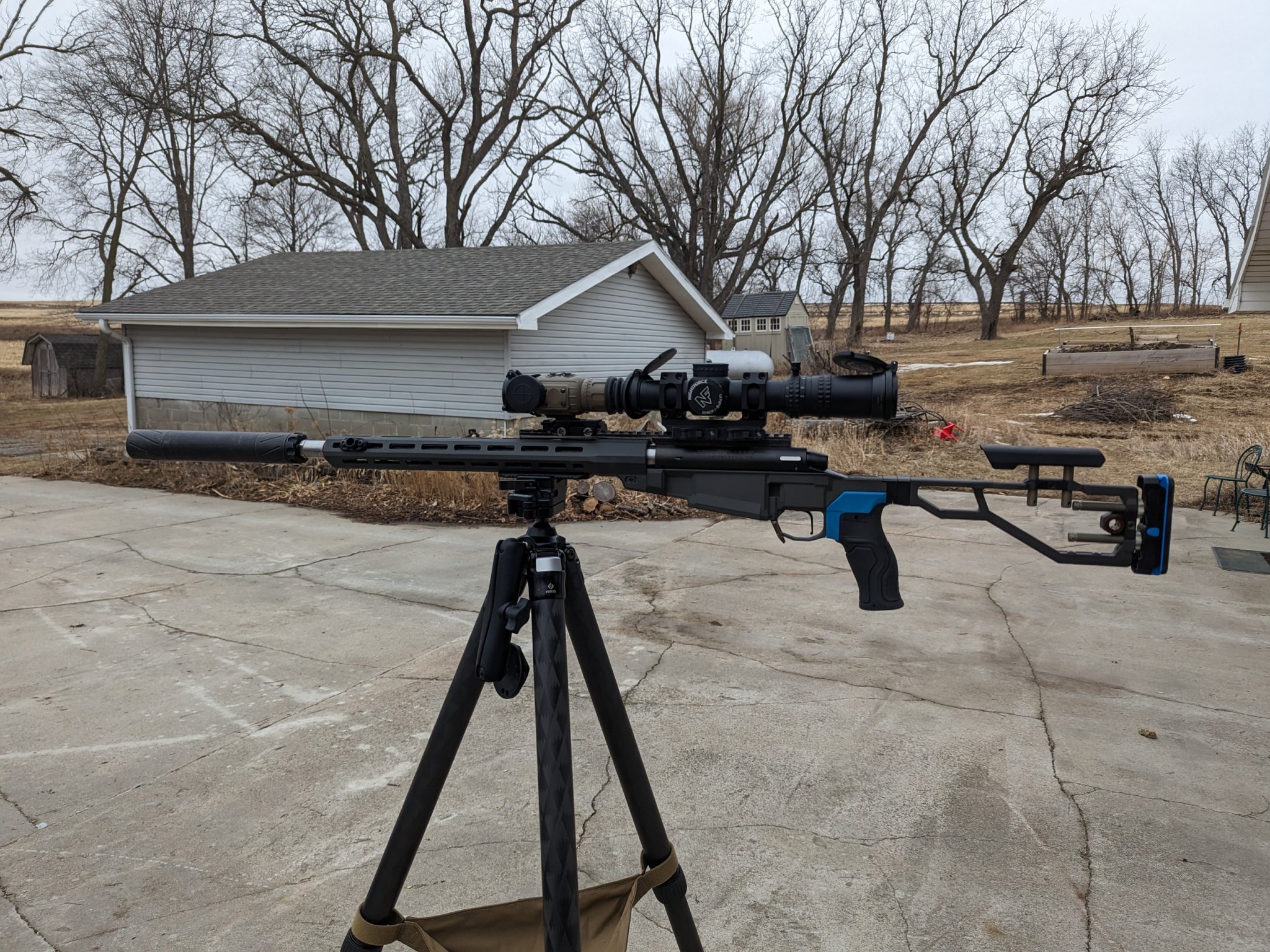

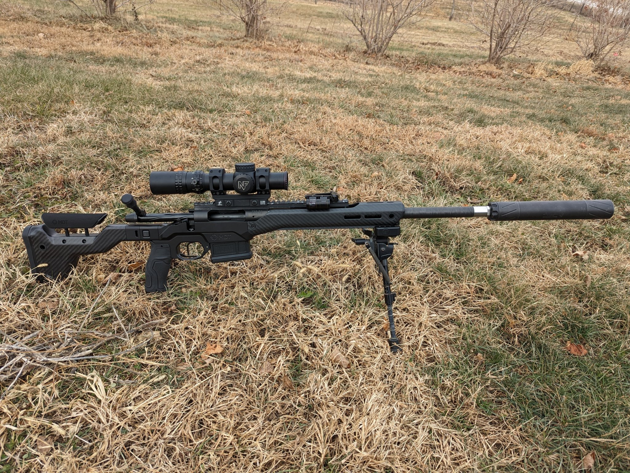

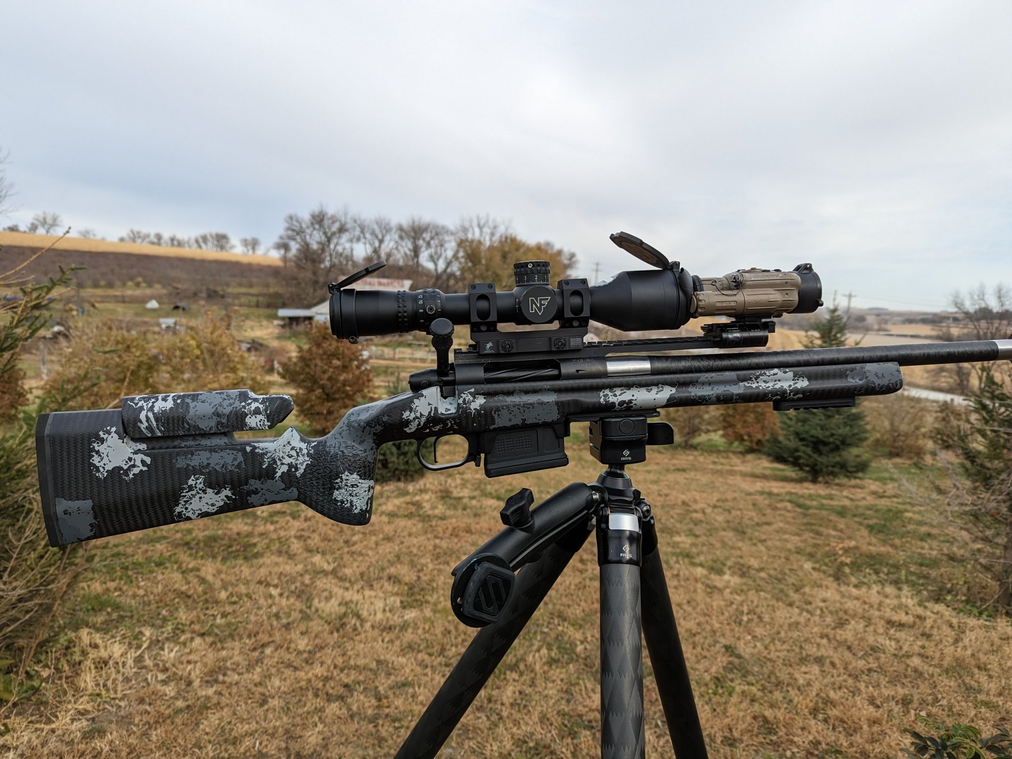

I have 3 22gt barrels, 16.5 Proof Research, 18, and 20" lengths from Bartlein. Running only 1 powder/powder charge of H4895 at 36grains and only 60grn VMax bullets, I have gotten speeds of : 3450, 3550, 3600fps. Great groups at or under 1/2", and those velocities were within 10fps spread at those averages in each barrel. 2 Bartlein carbon barrels, 1 Proof carbon. The Proof is the fastest twist (7.5) and the "worst" of the bunch. The Bartleins are 10&11 twist.
