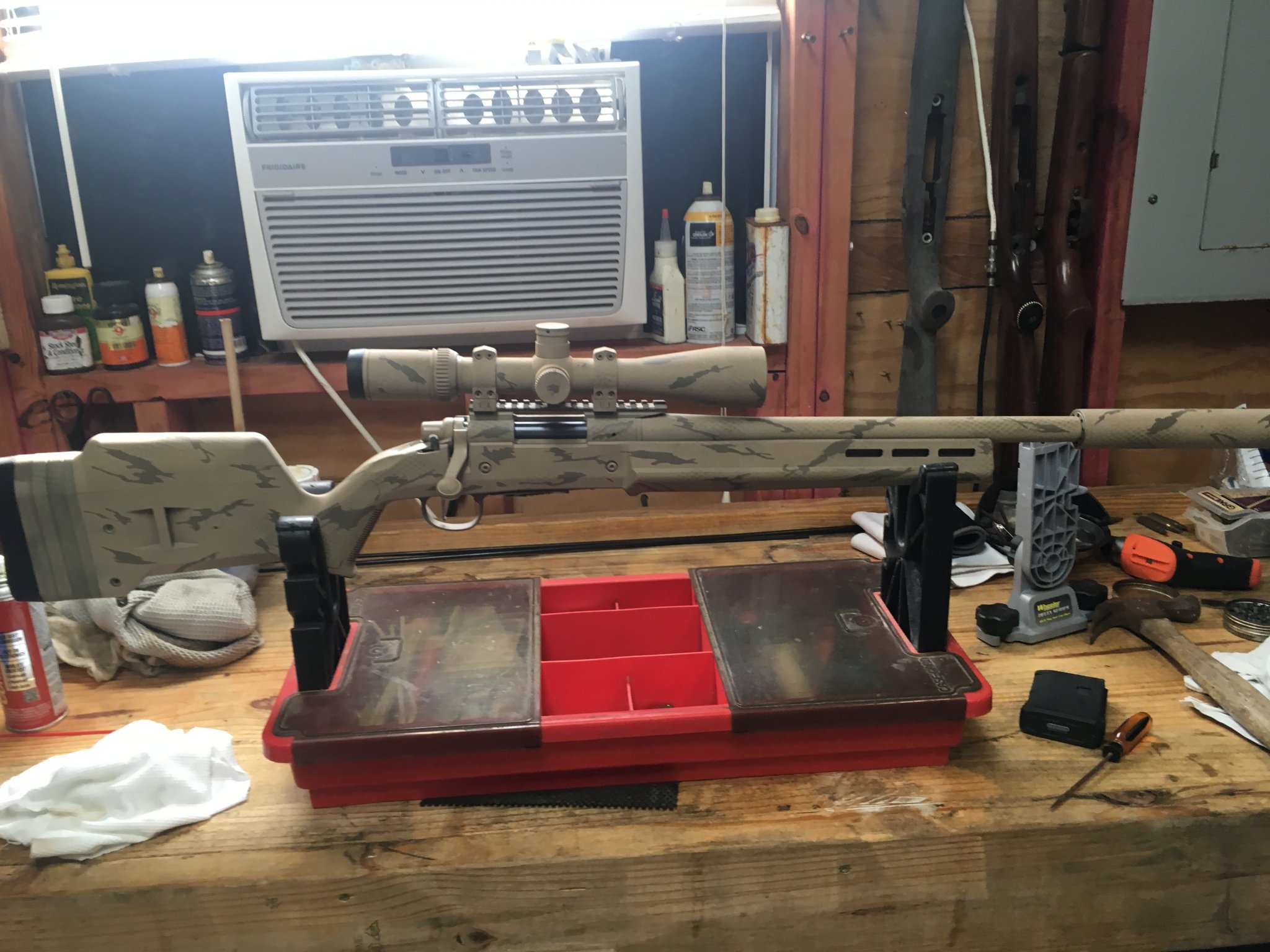

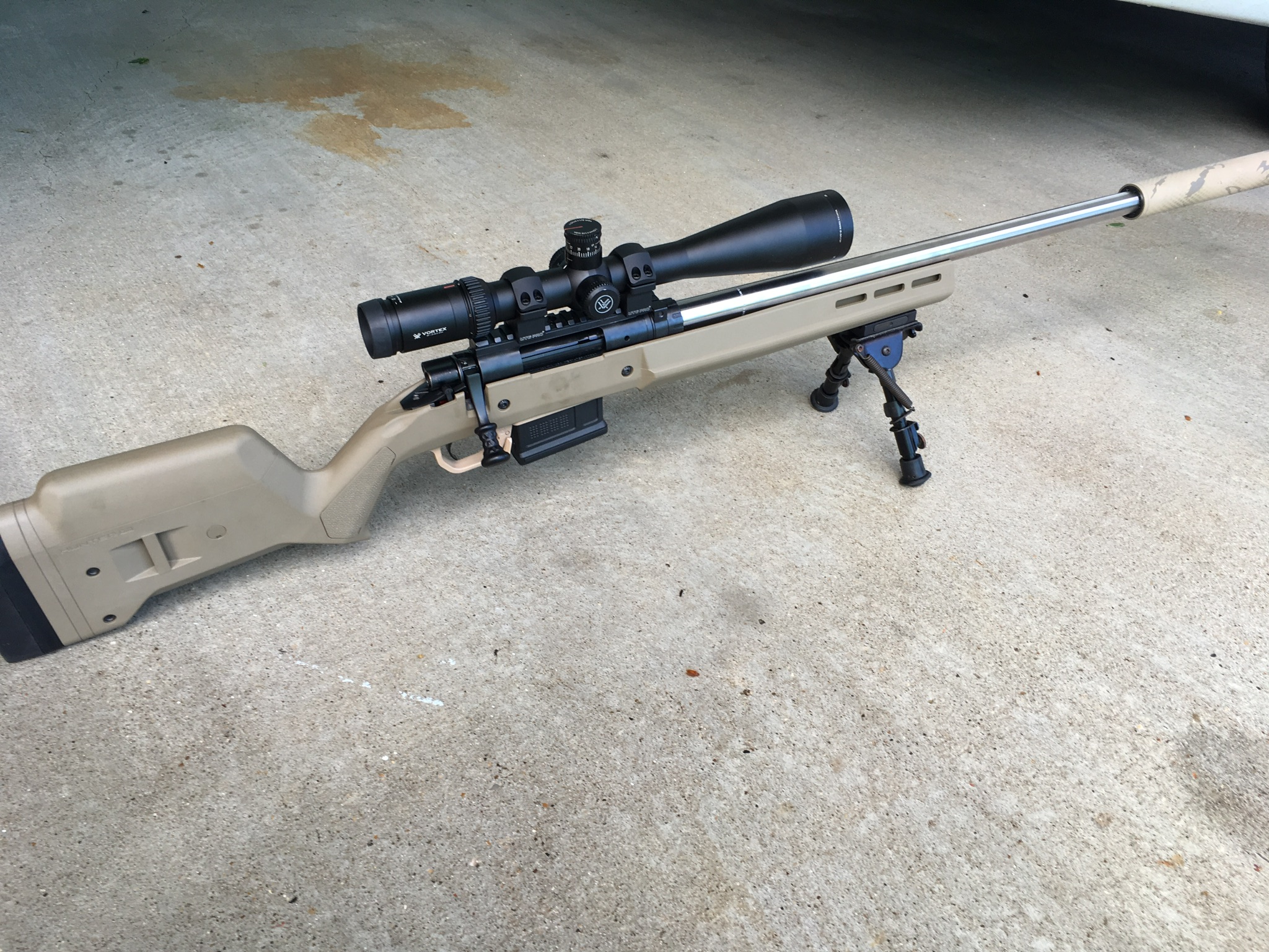

FWIW I have a 16” DT Covert .243 Win and Run 115 gr DTACs at 2821fps and same ammo in a SAC 22” runs 2900 so that gives you a bit of insight on the velocity loss with the shorter barrel.
Both guns perform well. Have taken many deer and antelope past 350 that dropped DRT and few coyotes out past 500 but lost two in a row last year that we’re shot between 500 and 600 yards saw the hit spun them around. Walk over and there is blood and they are gone. Guessing gut or ass shot them.

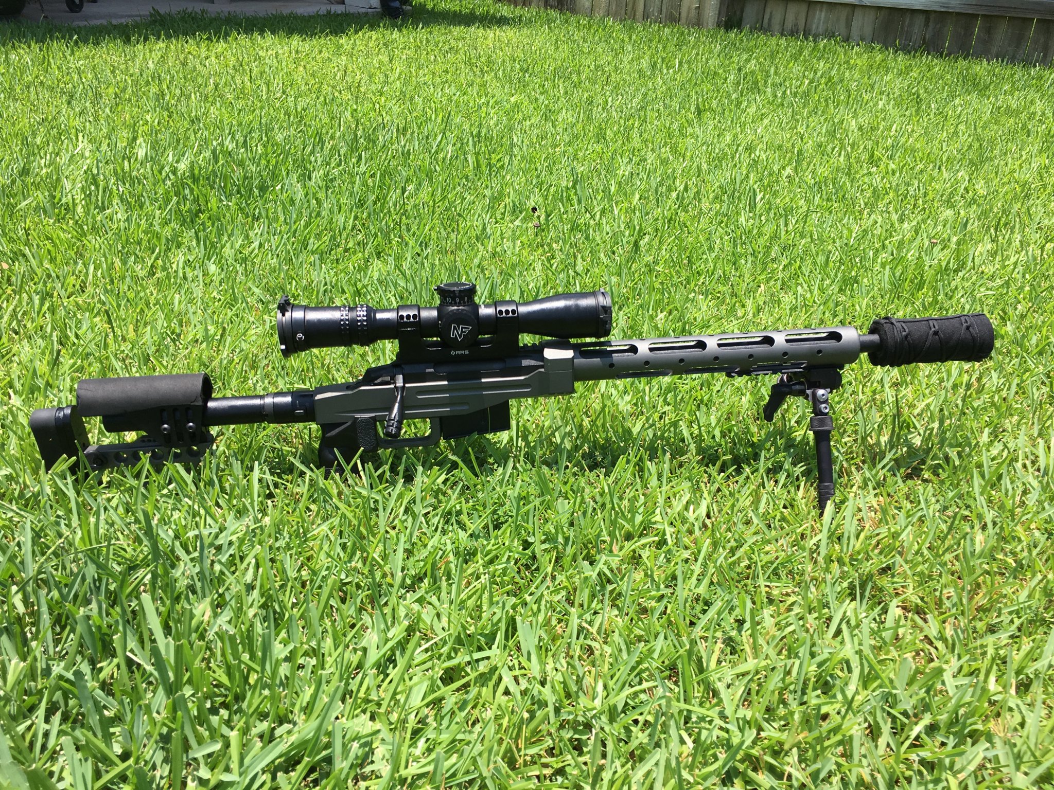

with Barloc barrel change system so I can change barrels in minutes. The rifle was shooting less than half MOA groups at 300 yds. I’m going 18” max, .260 Rem, 6.5 Cr, what else should I consider? And also I broke my back 2 years ago and have stopped shooting my .308, It is amazing what I feel after shooting a box of ammo through it.
