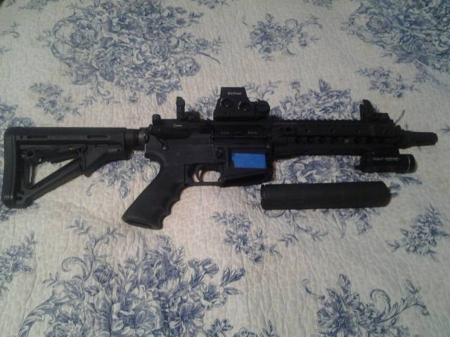

One of the best shooting SBR’s I’ve built and owned, and there have been more than a few, was built with a 10.3” BA Hanson barrel, LMT Enhanced carrier with a Sionics bolt completion kit. It’s attached to a Vltor MUR-1A upper with a LaRue MLOK rail. For years I had a 9” LaRue Tactical quad rail, but I’m warming up to their mlok rails, the are a little lighter but still use their awesome mounting system. That setup is subMOA from a bench. It suppresses real nicely with a 762 SDN-6 can which I often wish was an M42k or mini 4, but it is what it is and it is quiet for an SBR. Unless you’re pretty experienced in the short barrel world, I’d hesitate going shorter than that. Sometimes going shorter can be/possibly be problematic from a cycling perspective.
I carry it in a low viz satchel type bag and honestly it’s incredibly smooth for the barrel length. It doesn’t have a pistol brace on it, but a Troy PDW stock. A pistol brace like a SB Tactical PDW brace would be a really solid set up.
Also I wouldn’t focus on accurate to 50-75 yards” as you posted. As mentioned damn near any quality barrel will give you that and I’ll go out on a limb and say even a mediocre barrel will give you a measure of accuracy at such a short distance. Focus on parts that are proven and reliable. The the setup I gave you has proved itself. On average we run mixed mags when running drills. Crappy steel case to Magtech just to keep testing our setups, and also to work through FTF’s when we run into a bad primer or something - and aside from those few crappy primer issues it has been nothing short of stellar in function, reliability (maybe that’s redundant) and it’s freaking accurate for what it’s built for and I’m dead serious, it’s a smoother shooter than my DD 12.5.
So your entering the short barrel world, what optic are you considering?
