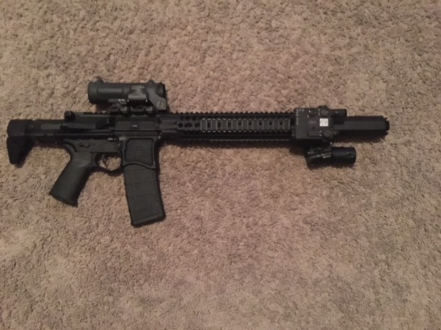

figured I would add some pictures of my sbr's with cans on them
I was informed it is good down to an 8" 5.56 so long as I'm not doing mag dumps and getting it crazy hot. I guess I know what my next project will be!
I use a SilencerCo Saker 556K on my 7.5” and 10.5” without any issues. I run a muzzle brake on the 7.5” and flash suppressor on 10.5”. I’ll post up some pictures up later. Still waiting on 762 Saker as well.
Top is my 7.5" Battle Arms lightweight upper & Lower, Battle Arms PDW stock, SLR adjustable gas block and SLR handguard.
Bottom is 10.5" Seekins Precision upper & lower, B5 sopmod stock, SLR adjustable gas block and Geissele handguard.
