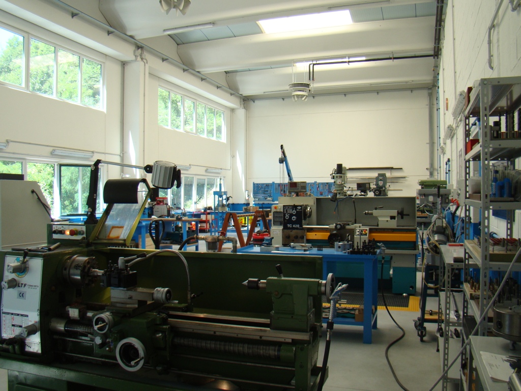

Hy guys,
in our workshop we use two lathes: a short spindle one that take care of threading+chamber short barrels (< 24") and a long one dedicated to longer barrels... (see attached image)
to increase rigidity and precision, we prefer to fit the barrels through spindle hole, indicating both ends ( 6-jaws chuck from chamber end, spider 4-grains from the back end)
if we'd decide to use the big (long spindle hole) lathe, that would be preferable as it's really strong and solid, is there a reliable and accurate mean/jig to fit short barrels through the spindle and center both ends (of course it's hard to reach muzzle end of barrel to indicate it, since spindle hole is so long..).
Thanks in advance for your help and Greetings from Italy!
