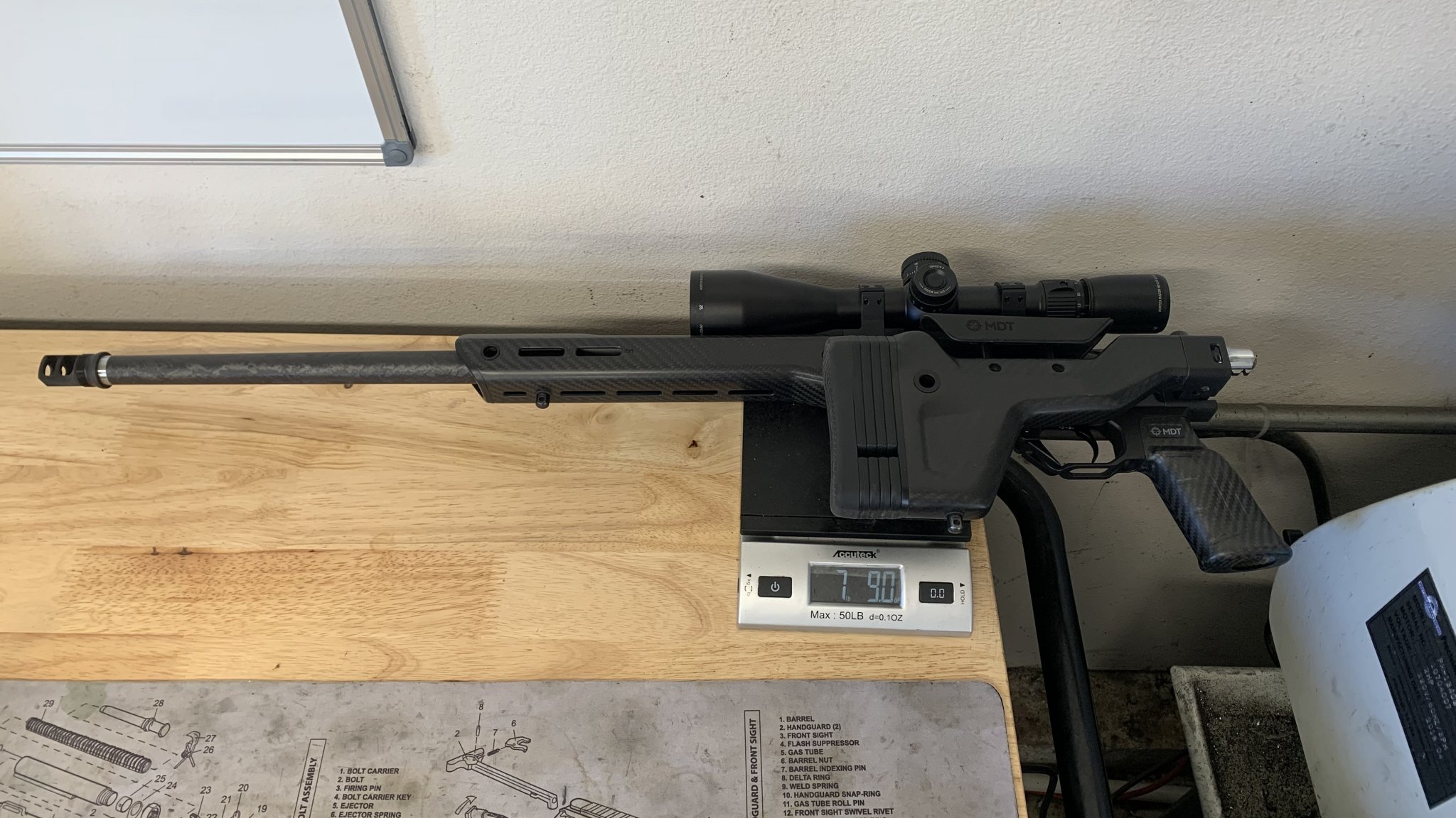

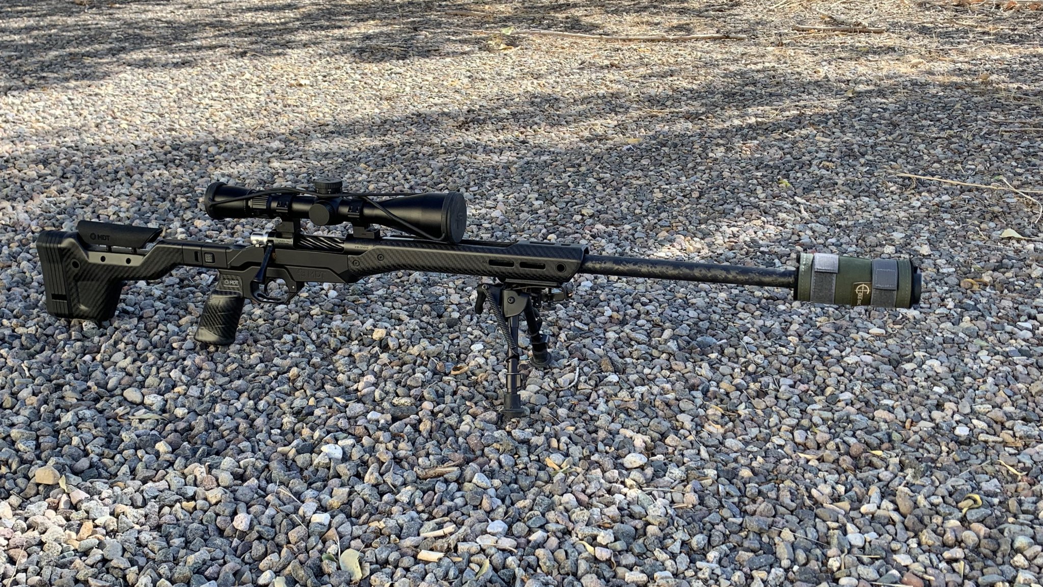

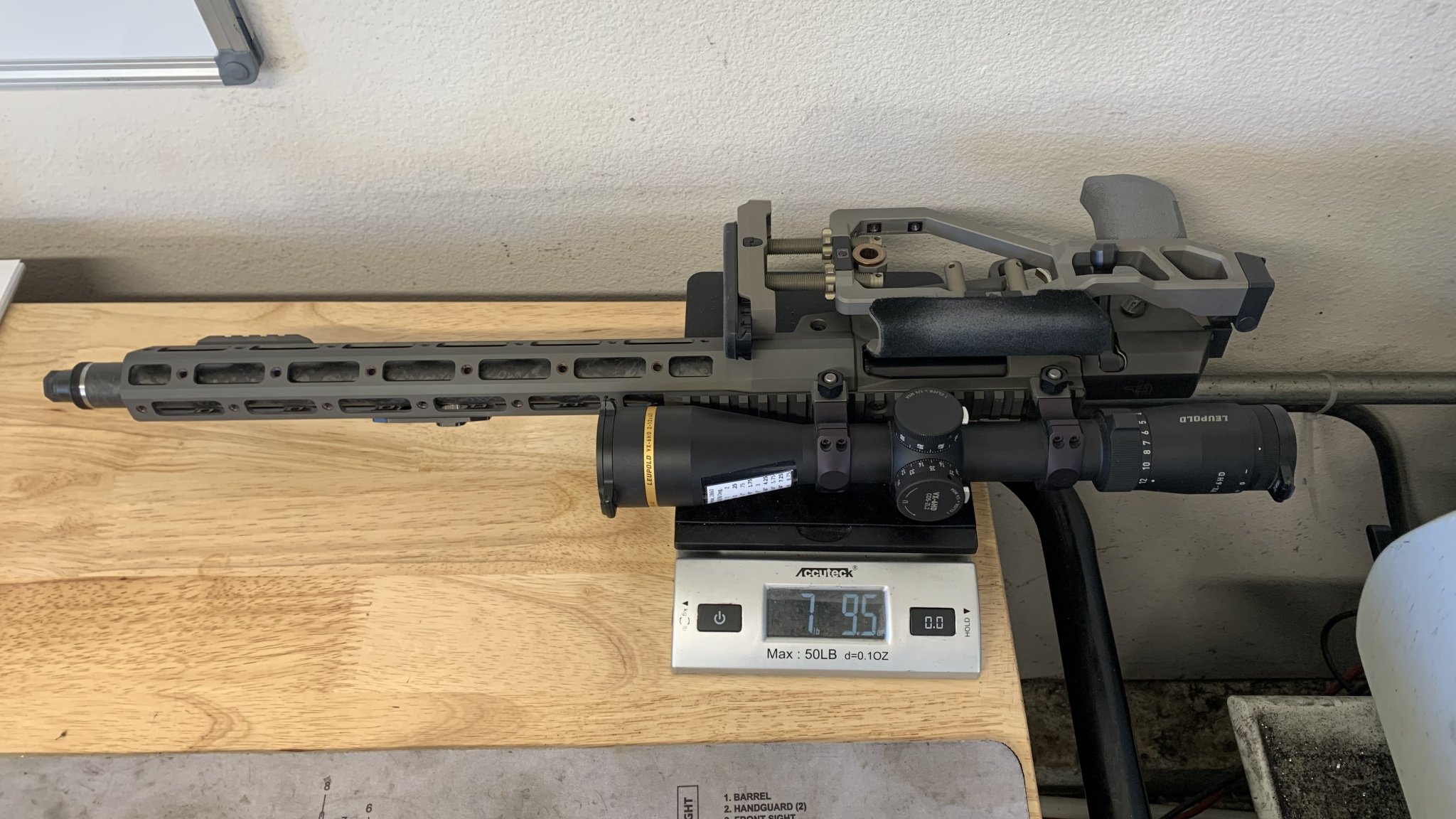

6.5 cm’s dont thrive in long barrels, that's just a weird internet myth. You’ll lose 30 fps per inch of barrel from your 24” barrel approx. Other than that, no reason you cant build the rifle you envision.
Edit: The top gun is a 6.5x47 with a 16.5” barrel. 129 ABLR’s at 2550 fps, which is exactly 1k ft/lbs at 500 yds. I run TBAC Ultra 5’s on both.
View attachment 7985188View attachment 7985189

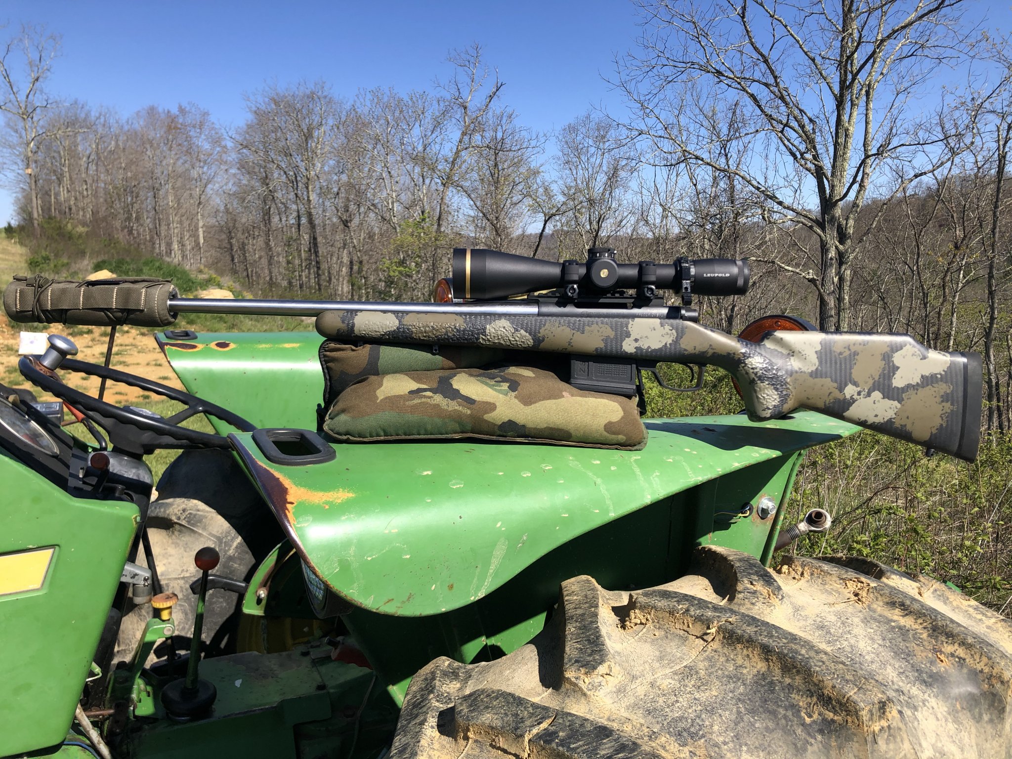

Specs on lower rifle?
Reactions: Sullivj3
Defiance Anti(non-X), 22” proof Sendero light in .260, Geissele two stage trigger, MDT HNT-26 chassis with their flush fit 3rd polymer mags. Scope is a Razor LHT 4.5-22 in Talley Lightweights. I just finished it. Hasn't been coated or marked yet. Interestingly the scope is 5 oz heavier than the Q Fix scope, and the barrel is also 5 oz heavier, but overall it weighs the same as the Fix.
