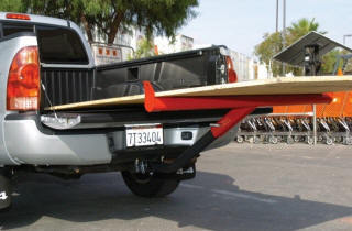

If you're gonna use a bed extender, get this one. It's called the T-bone. Very strong, very stable and is available in lots of colors if that's important.
My wife bought one for me and its been used to carry kayaks, a Gheenoe and plenty of lumber
I like the bed extender.
