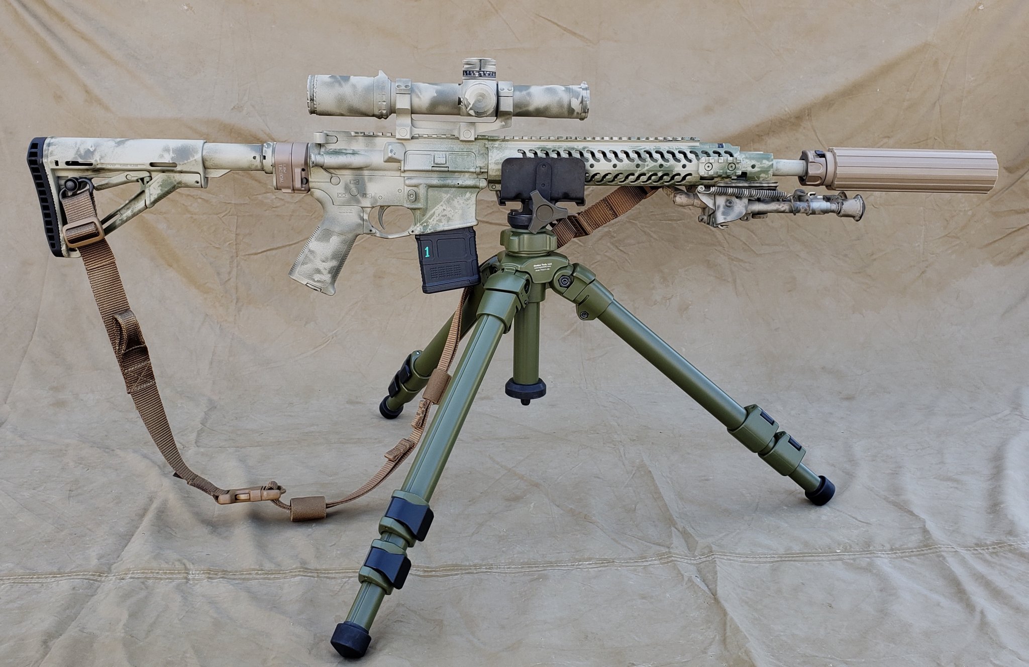

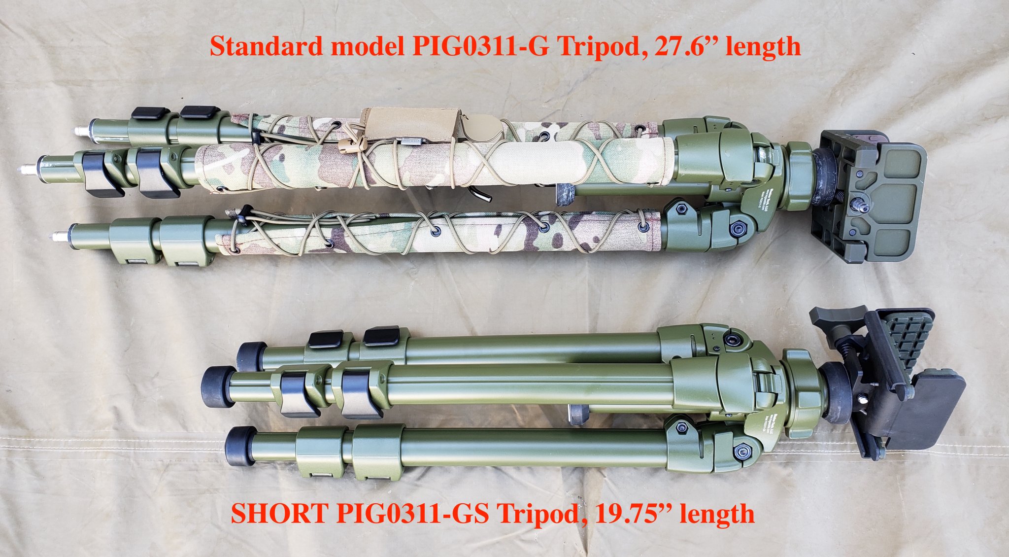

This is our new PIG0311-GS SHORT tripod. Made specifically for coyote and deer hunters who primarily hunt from sitting & kneeling positions. This SHORT tripod packs smaller and sheds a pound of weight, compared to the standard PIG0311-G full size tripod model.
If you don't anticipate taking a standing shot on an animal, then there is no need to carry a larger/heavier tripod. Pack light, pack smart.
Compared to a four section carbon fiber tripod, the weight & folded length specs are very competitive.
The PIG0311-GS SHORT tripod should make a great pack companion for those who hunt off of hillsides or out of deer blinds.
Folded length 19.75"
Extended length 39.5"
26lbs load rating
Weight 4.75 lbs
Info Link: SHORT PIG0311-GS
Very cool. What I want to know is where can I get some of those leg wraps!!!
Rauch Precision is sewing them for us, specifically for the PIG0311-G tripod. We will most likely do a small run for the short model also. They work great for attaching vegetation, dope cards, or random range tools while spotting.
