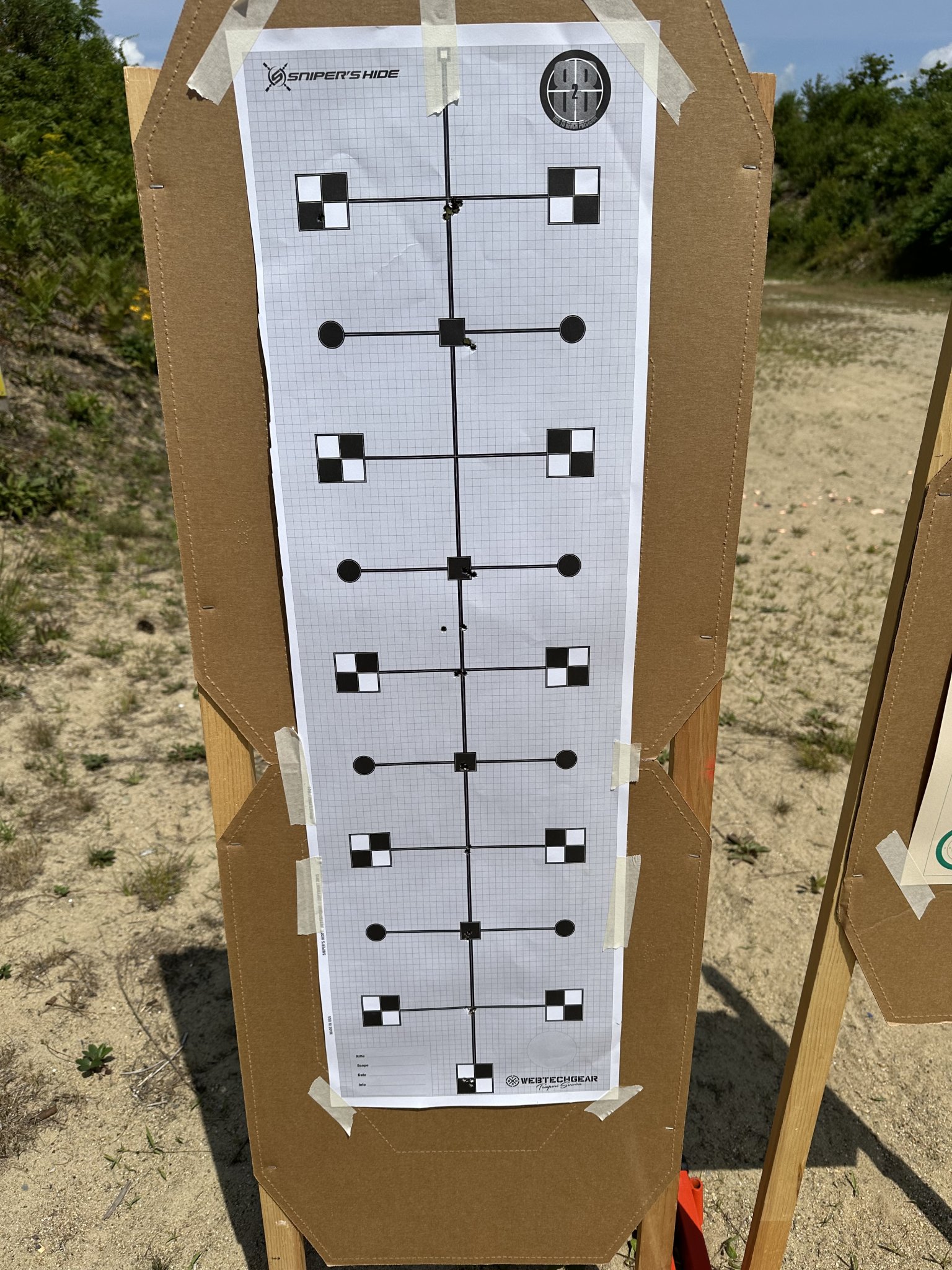

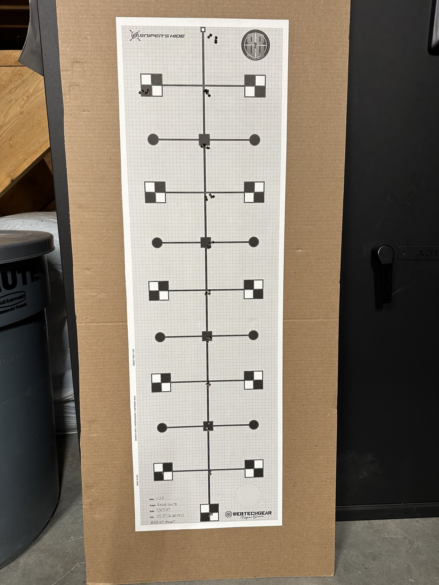

I remounted my Vortex Razor Gen III 6-36x56 (MRAD) in the Area 419 One Piece Mount.
Used a Short Action Customs Final Scope Level mounted in a Wilton Vise and Plumb Bob. Confirmed the MDT Level mounted to the Scope Rings Showed 'level' and the reticle was 'plumb' with gravity.

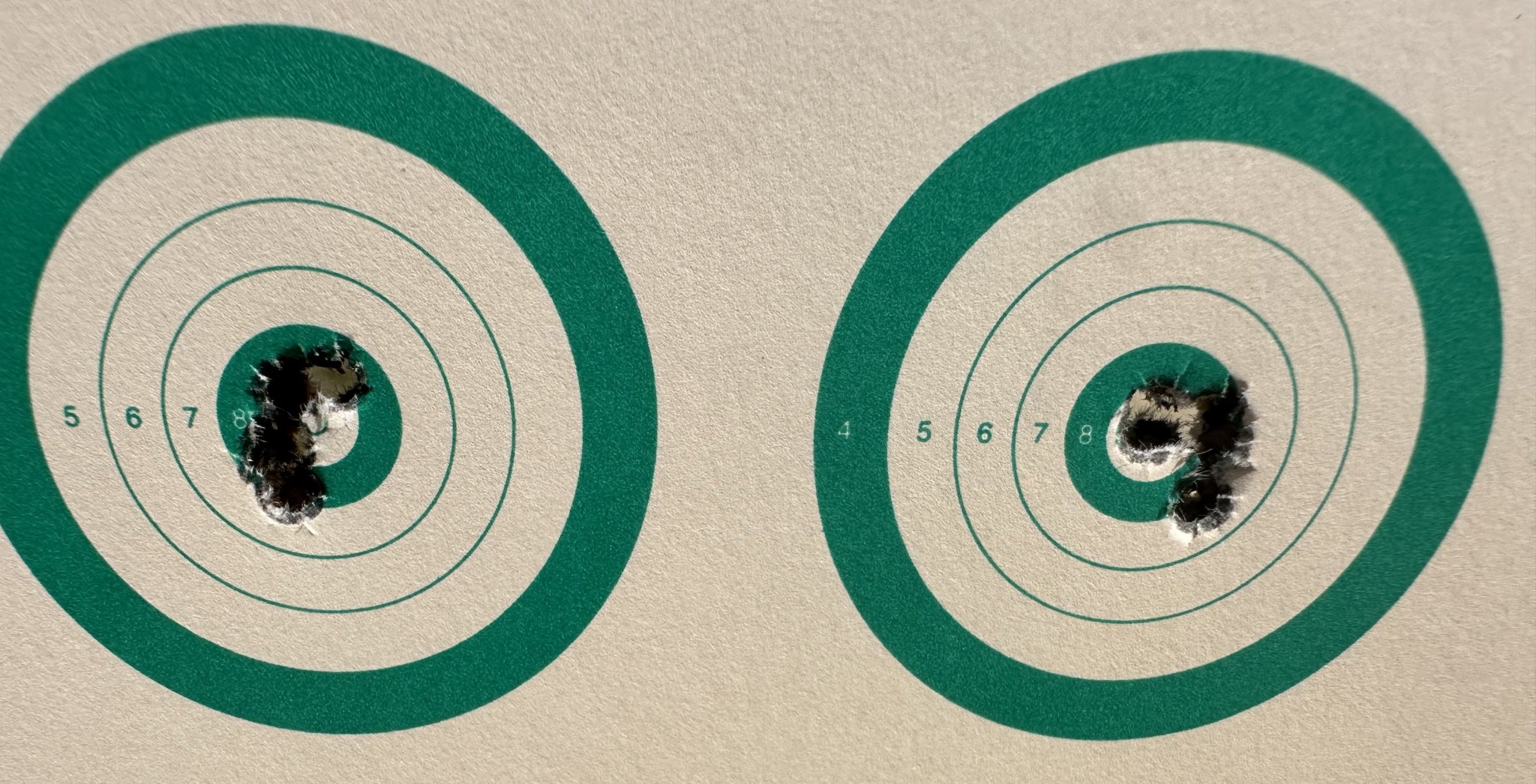

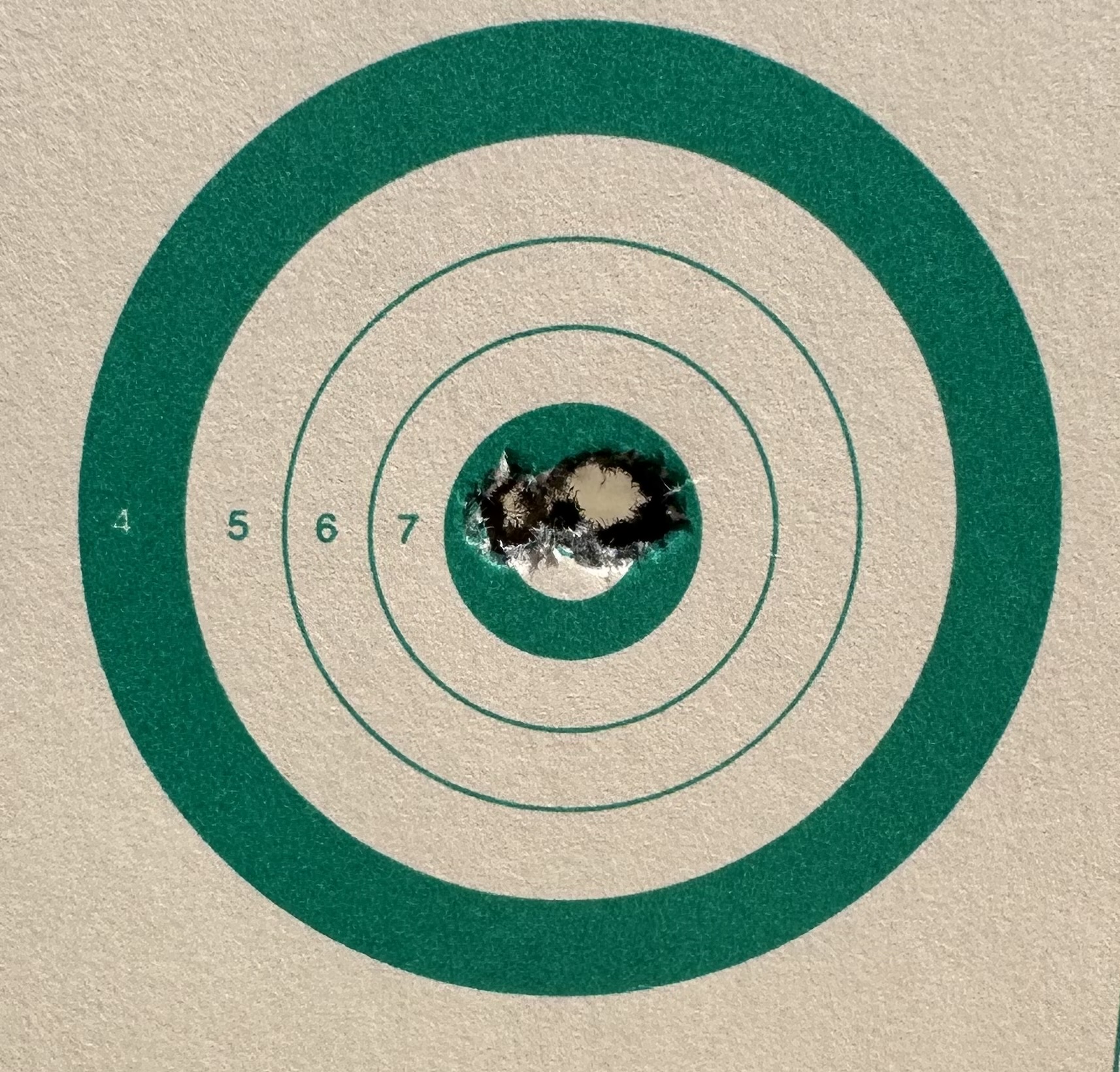

Shot some groups, slipped the turrets and fired these (3) 5 Shot Groups @ 50 Yards (Lapua Center X with 1072 FPS Average and 9.2 FPS Standard Deviation over 50 Shots)

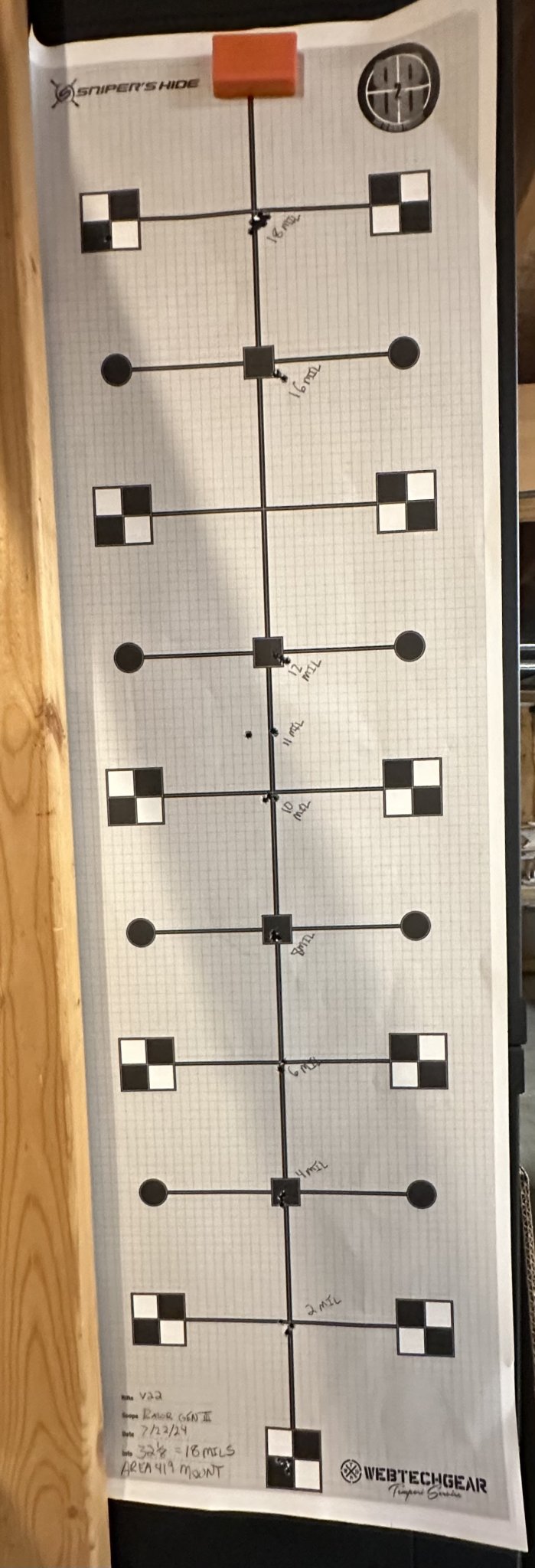

Moved on to so a Short Range Tall Target Test (50 Yards). At 50 yards I was dialing '2' Mils to move the rounds '1' Mil on the tall target target. I got sloppy (hot / tired) toward the end. It shows after the 10 Mil Dial (I went up '1' Mil instead of '2' and pulled a round). Determined what I had left for elevation on the target and dialed '18' Mils and tried to take my time / make sure the MDT was showing level.
All in all I'm happy with it. I did it at 50 yards to try and eliminate wind and capitalize on accuracy.

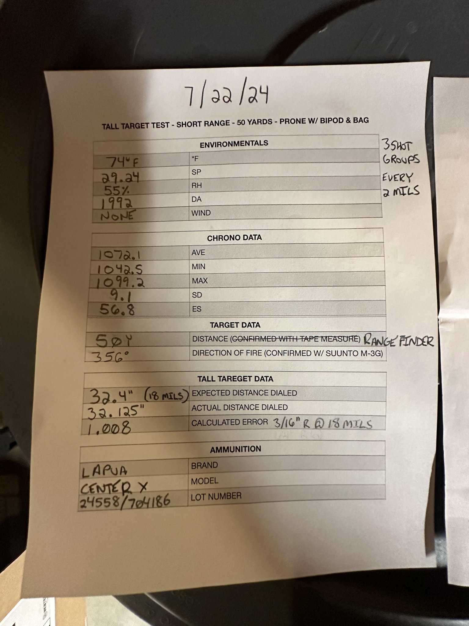

Correction factor calculated from 7/22/24: 1.008

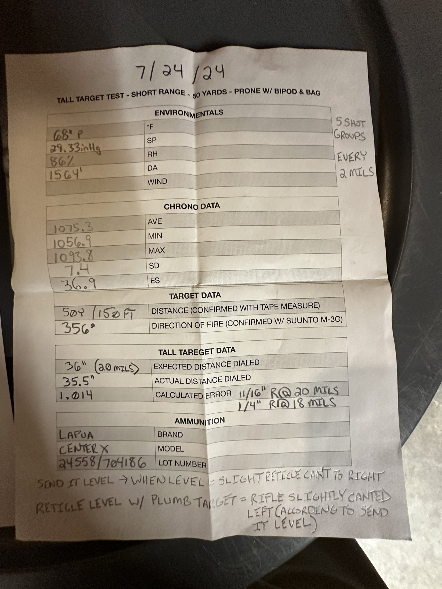

Correction factor calculated from 7/24/24: 1.014
I think something or a combination of things is off by a total of 1 degree (leaning right). It doesn't show its head till around 10 mils of elevation are dialed.
Either way. . . for my NRL22 Rifle and even Rimfire PRS I don't think it's worth messing with at this point. 10 mils of dialed elevation puts me in the ball park of 250 Yards. After 10 mils it looks like I would miss low and right if not applying a correction factor.

I recall Bryan Litz doing a tall target test video. In it he said an error of 2% or less is acceptable. Probably because there is always ways for the environment or the variability in ammo or shooter error effecting the test.
There is a rimfire specific tall target test off in the resources section that I’ve designed. You can print it on a 11x17(with no scaling) and test your turret tracking to 8 mils.
Greatly appreciate that. I printed 10 of them off this morning. I have a few rifles to run through that test.

I'm happy with the how close the results were to each other doing it on 2 different days with the same ammo.
1.014
-1.008
0.006 difference... I can't out shoot that or correct for that.
