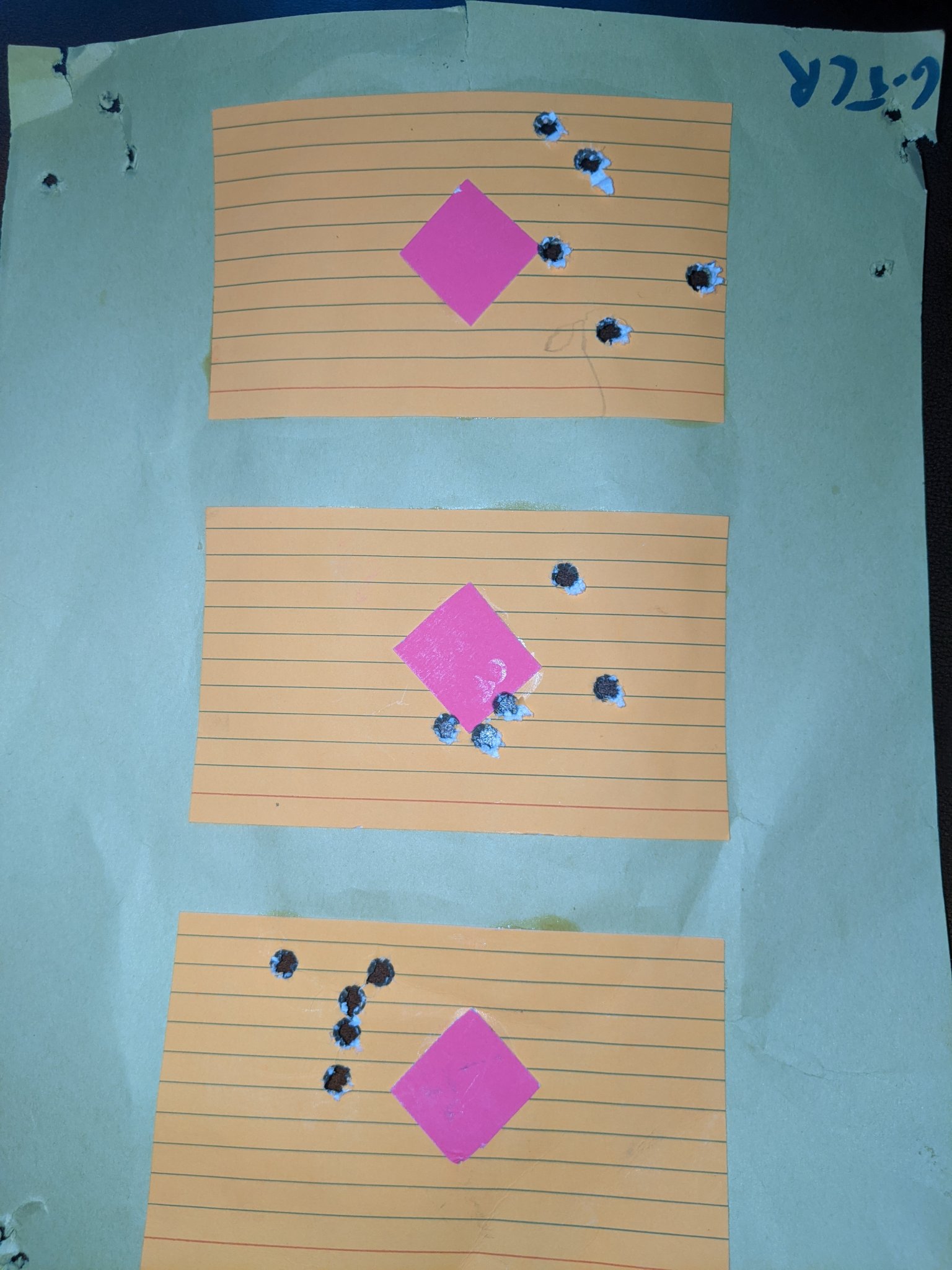

First off thanks everyone. Got a journey for you guys. Was going to just swag this. Buy some tools and play around. I managed to find a person through work with connections to a gun smith. We used a stoney, found my throat was super short but not as short as I thought. Max oal was 2.78 for a creedmore. He also thought the throat had burs in it, explain my nasty stuff marks. He scoped it, it was super rough. He hypothesized that, since 6.5 cr is super popular, they just rushed this one out with a really raggedy reamer.
Ran a ptg through it, opened the throat up, and now I have max cbto (I didn't really care for coal atv this point my mag is pretty roomy) 2.20. ran a berger ladder test at 130 yards. Would normally run it at 150 but was pressed for time had to stay local. Anyways. Started at cbto 2.196, 2.192, then 2.188. All of them with a 41 grain charge of h4350. last group is at 2.188, measures out to .0776 moa. Sd is a little off at 16 but my barrel clearly liked that seating depth. Berger vlds are so sensitive to where they want to be seated. hoping a increase in charge weight will tighten up that vertical stringing. Long read I know, but I'm so glad I have this thing figured out. I now own a bunch of cool tools and leaned a ton from this experience. Appreciate the advice!
Ps. Pink squares are 1x1 inch

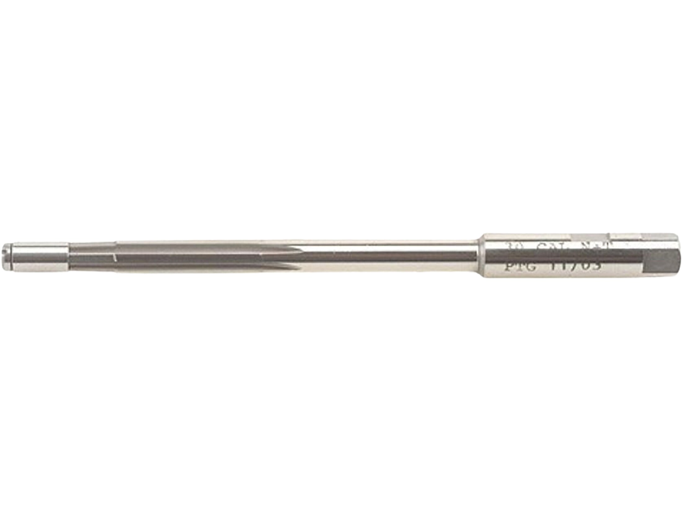

Thank you for the video. Now I think I could use the tool confidently, but not sure its the right tool. I'm not seeking to cut away lands - and not sure I like the idea of creating a long lands ramp. What I need is something that opens the freebore section slightly - like .001 - .002 so that it no longer touches the bullet.
Sure you're not missing a zero in those numbers?
Makes no sense to attempt to extend a throat by one or two thousandths. You'll lose that much anyway in 100 rounds or so...
