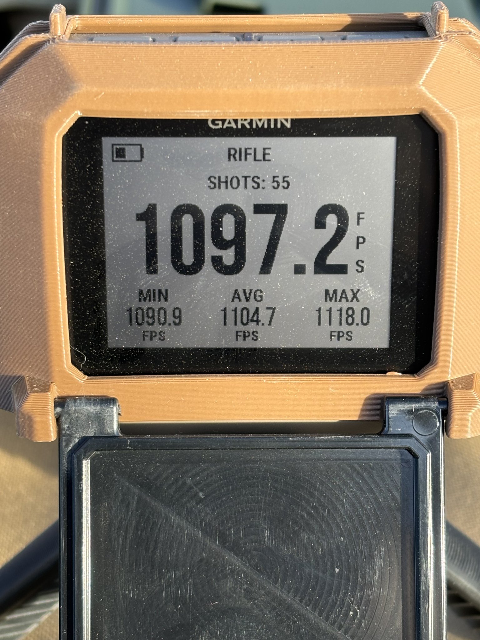

I do know the same ammo subsonic in my T1X 16” shot through my 18” bergara will go supersonic on occasion. SK match won’t do it very much but my lot of SK LR does it more frequently

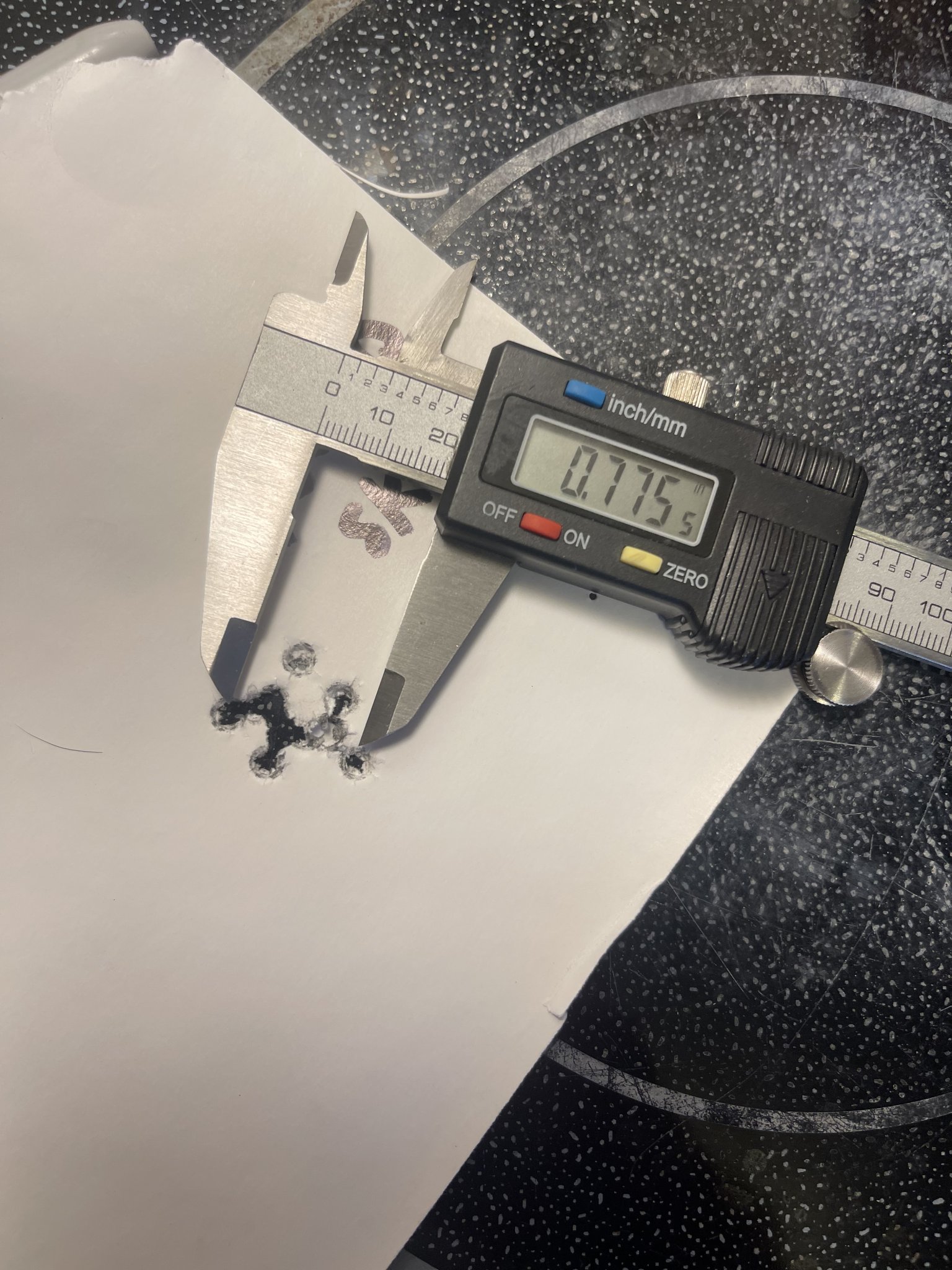

Here’s a 100 yard 10 shot group with SK LR in the Bergara. I had at least 3 if I remember go supersonic and got the “crack” vs the others. Shot through a griffin Optimus Micro. In my case at this range it made no difference

Here’s a 100 yard 10 shot group with SK LR in the Bergara. I had at least 3 if I remember go supersonic and got the “crack” vs the others. Shot through a griffin Optimus Micro. In my case at this range it made no difference.

That’s the only 100 yard group I shot with the gun.
Shot a bunch of 50’s but I use it for hitting long range steel with my buddies
This was more or less to point out that even though some left subsonic and some didn’t they all landed in the same spot. How that’s looking at 200 I’m not sure

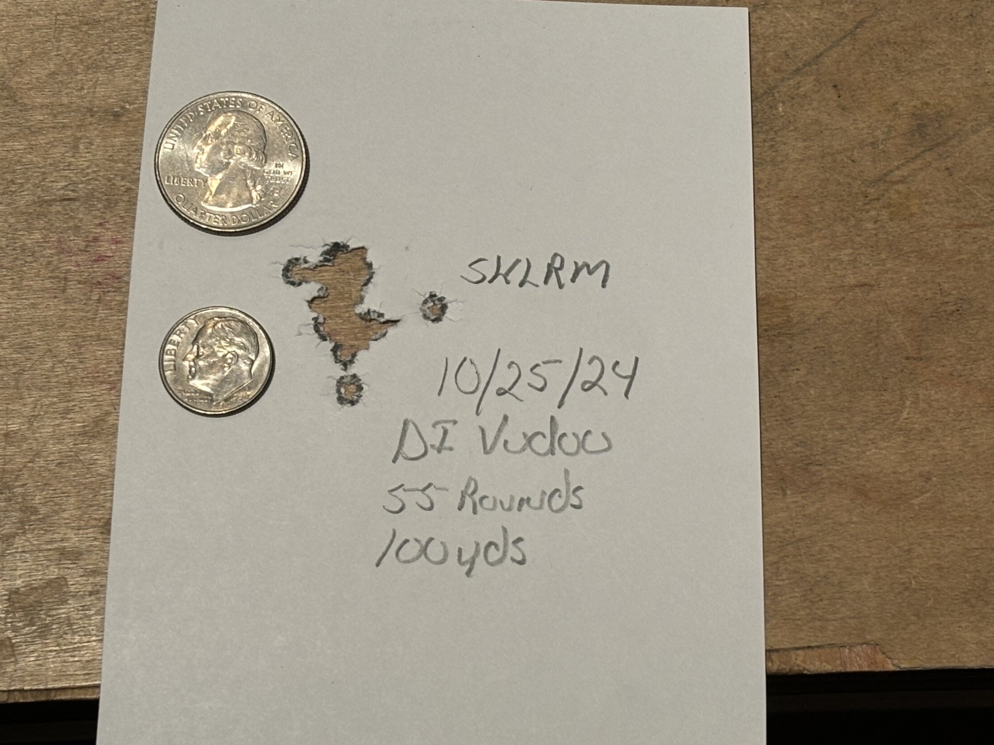

How many Lapua test center results do you need posted?

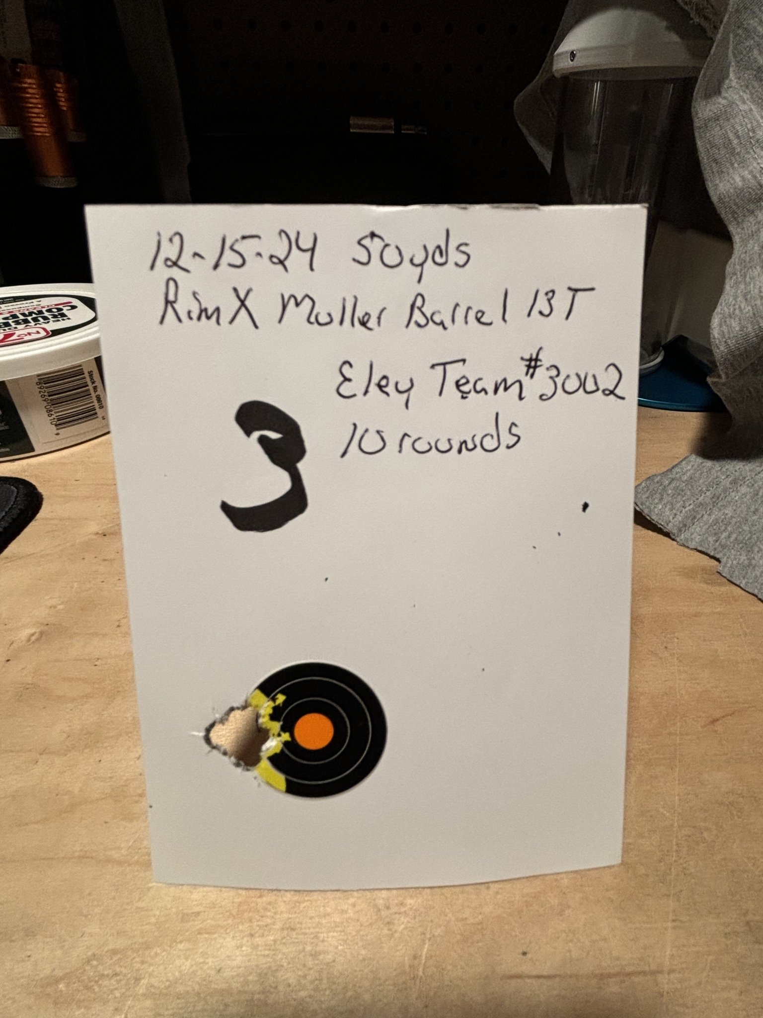

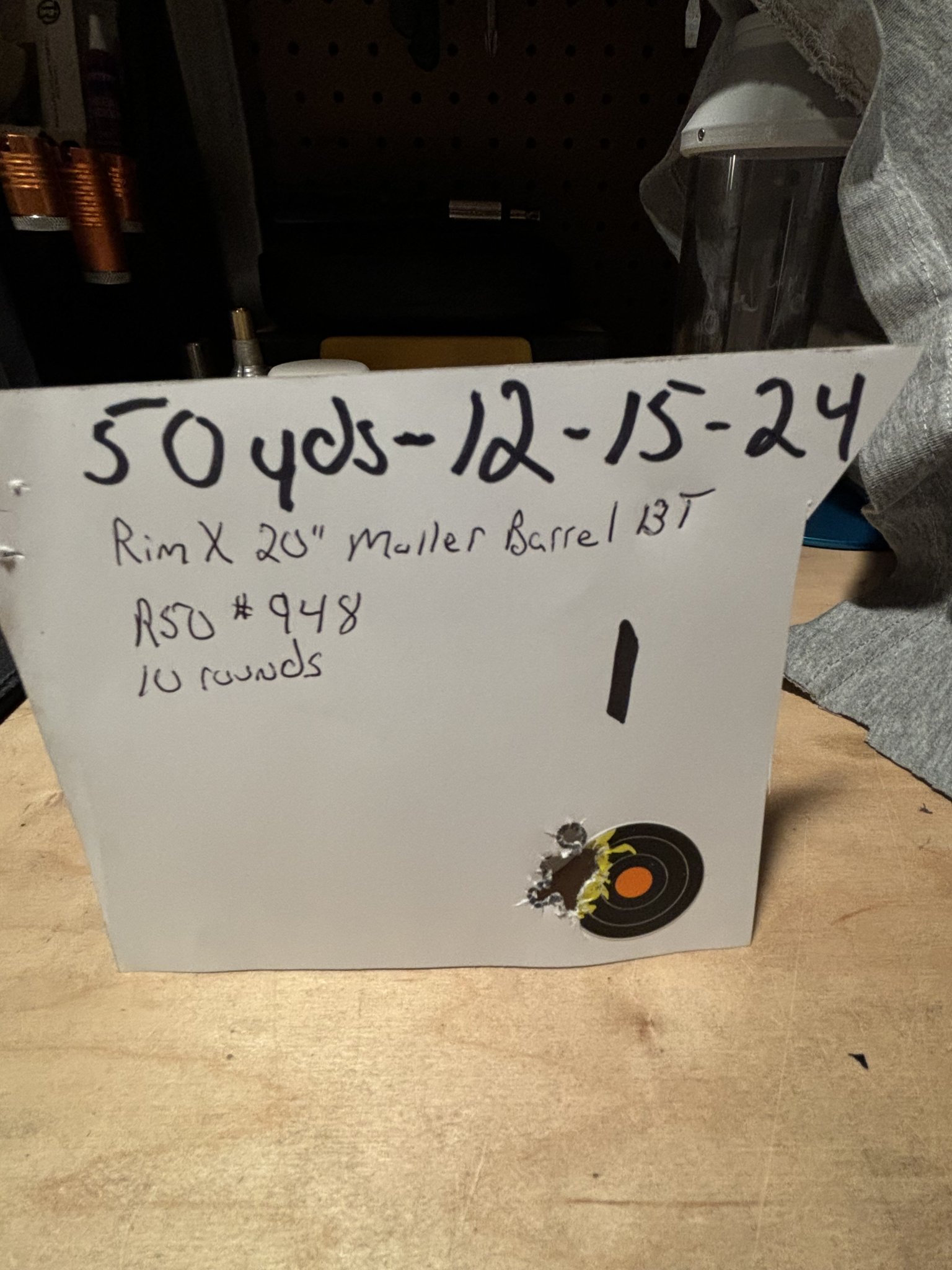

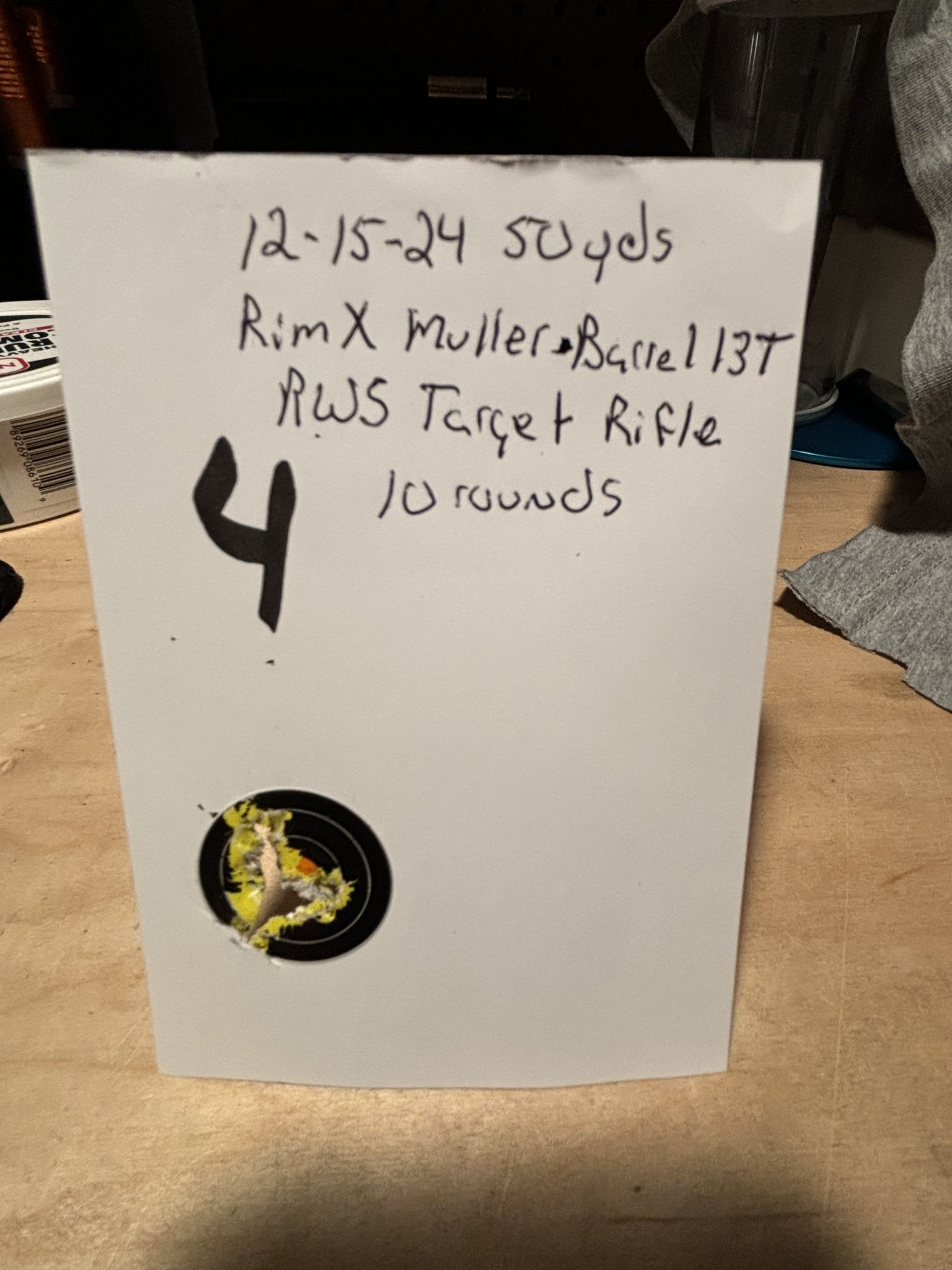

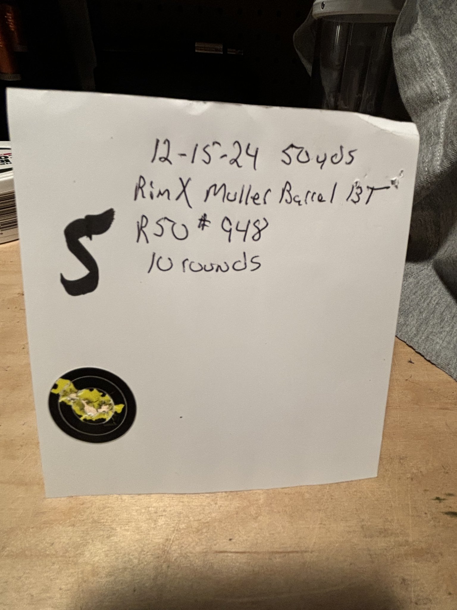

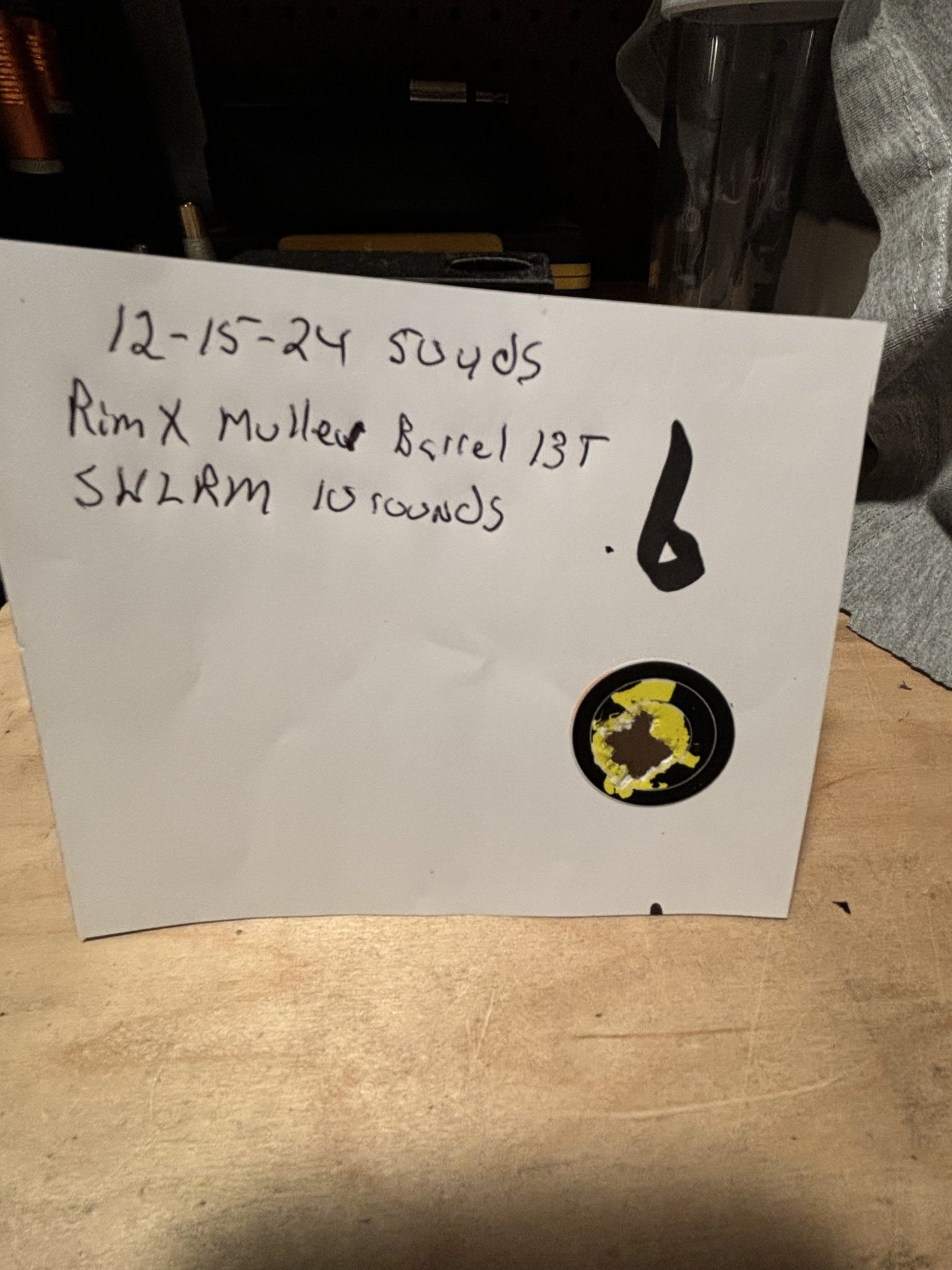

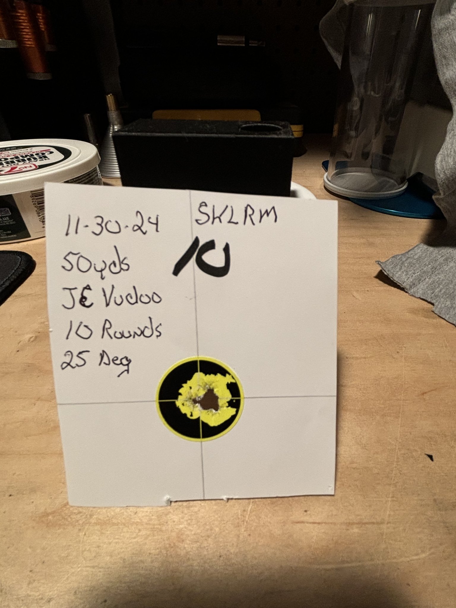

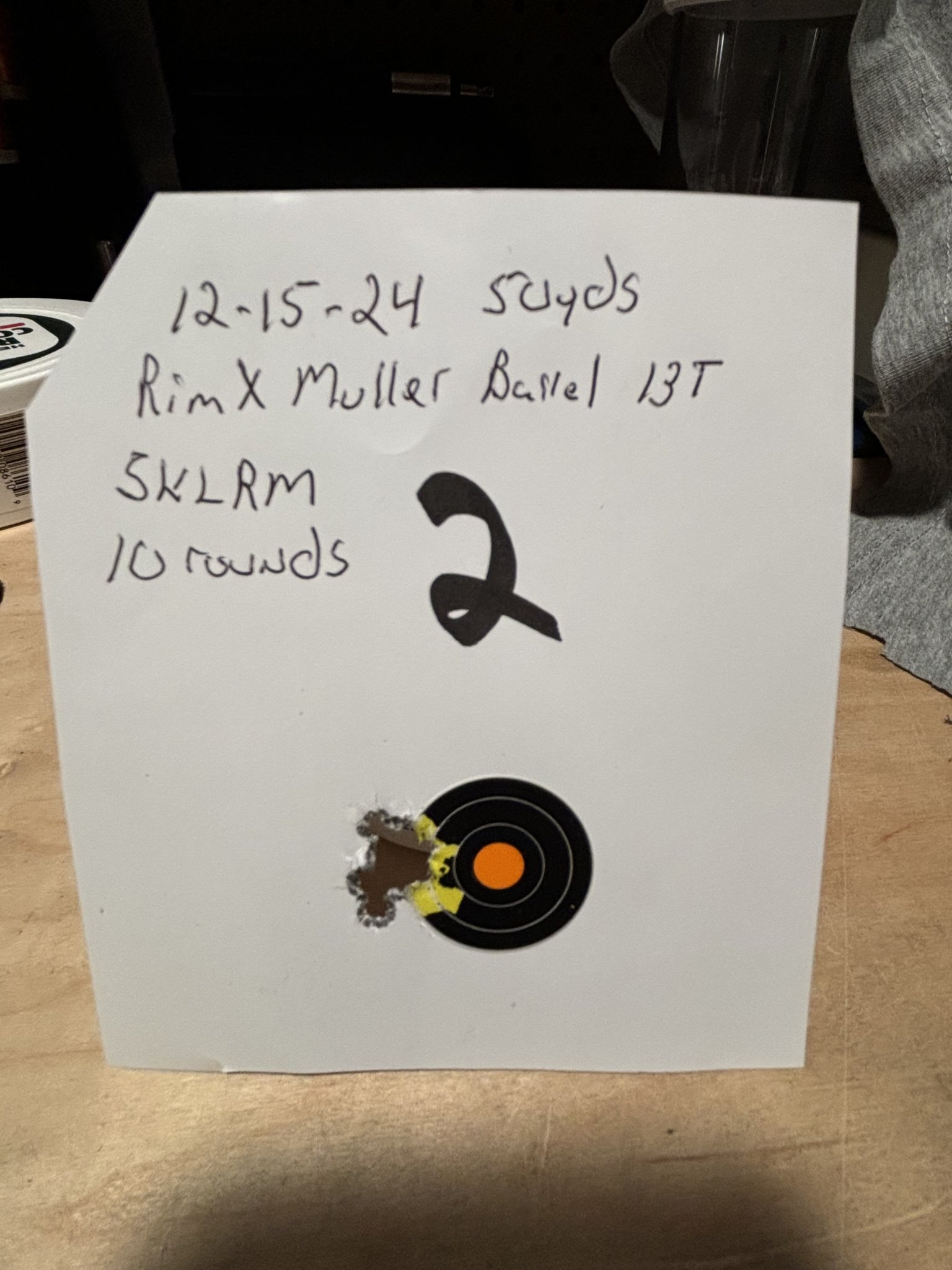

DI Vudoo 360 21" 13 twist Muller works barrel built by @David Lott low round was round 1 from a cold clean barrel round to the right was a bad wind call Garmin pic is the rounds fired no cherry picking
All targets dated 12/15/24 is my most recent rifle from Mike at Manzella Precision RimX action with a 20" 13 twist Muller works barrel, the last pic is the same day, rifle and ammo as picture #3 but shot on steel at 100yds, the round just left I am pretty sure was a slight wind pick up
Target #10 is a 24" 16 twist Krieger built by Johnathan Elrod at MCR
All of these barrels are 1.25" and all will shoot 1/2" or better at 50yds
