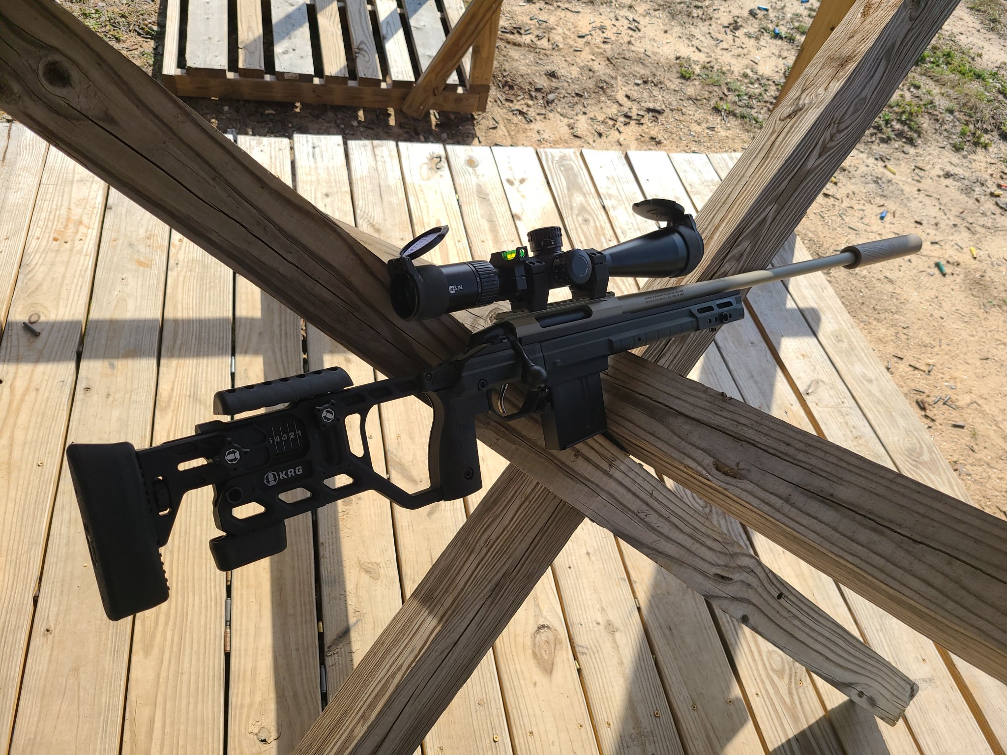

So question,
I have a tikka t3x with a SS 24in barrel, recently I got a TBAC ultra 9 to go with it. However I didn't really realize how long this gun ended up being.... for reference we are talking about 53 inches. Or am I off that mark and that's a normal length for suppressed bolt guns.
I was wondering if shortening my barrel down to 20 in is even a thing, or even worth doing considering buying a new barrel is close to $500
Thanks!
