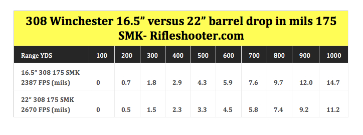

Nothing specific. Just want something short enough and light enough I can strap it to my pack and ruck around but still reach out and touch something. Leaning towards something in the 16-18" range.
It's just one load but it will give you an idea of how much additional drop you will experience at distance. Good luck in your quest.

Trying to build a folding shorter, lighter, more compact bolt gun than my m24. What length barrel would you dudes suggest? It’s going in a AI AX chassis.
I have some 14.25" three O hates with P&W SiCo ASR suppressor adapters.
They get about 2,500 fps with Fed T308T and Hornady TAP 168s which is plenty to give good terminal performance.
We've actually clocked some factory LTRs and 700Ps that were barely doing that with their longer barrels.
No problem on 2/3 IPSC steel at 750 but you better have your shit together if the wind starts blowing.
Pretty sure you will be super safe with a 16"***
*** You did not mention whether you plan on shooting suppressed. If Yes, you will be happy with any of the shorter lengths. If No, you will have a cool looking rifle that is an obnoxious MF'r with a short barrel.
IF you plan on running No suppressor AND adding a muzzle brake, you can at least double the obnoxious quotient due to the short barrel..
