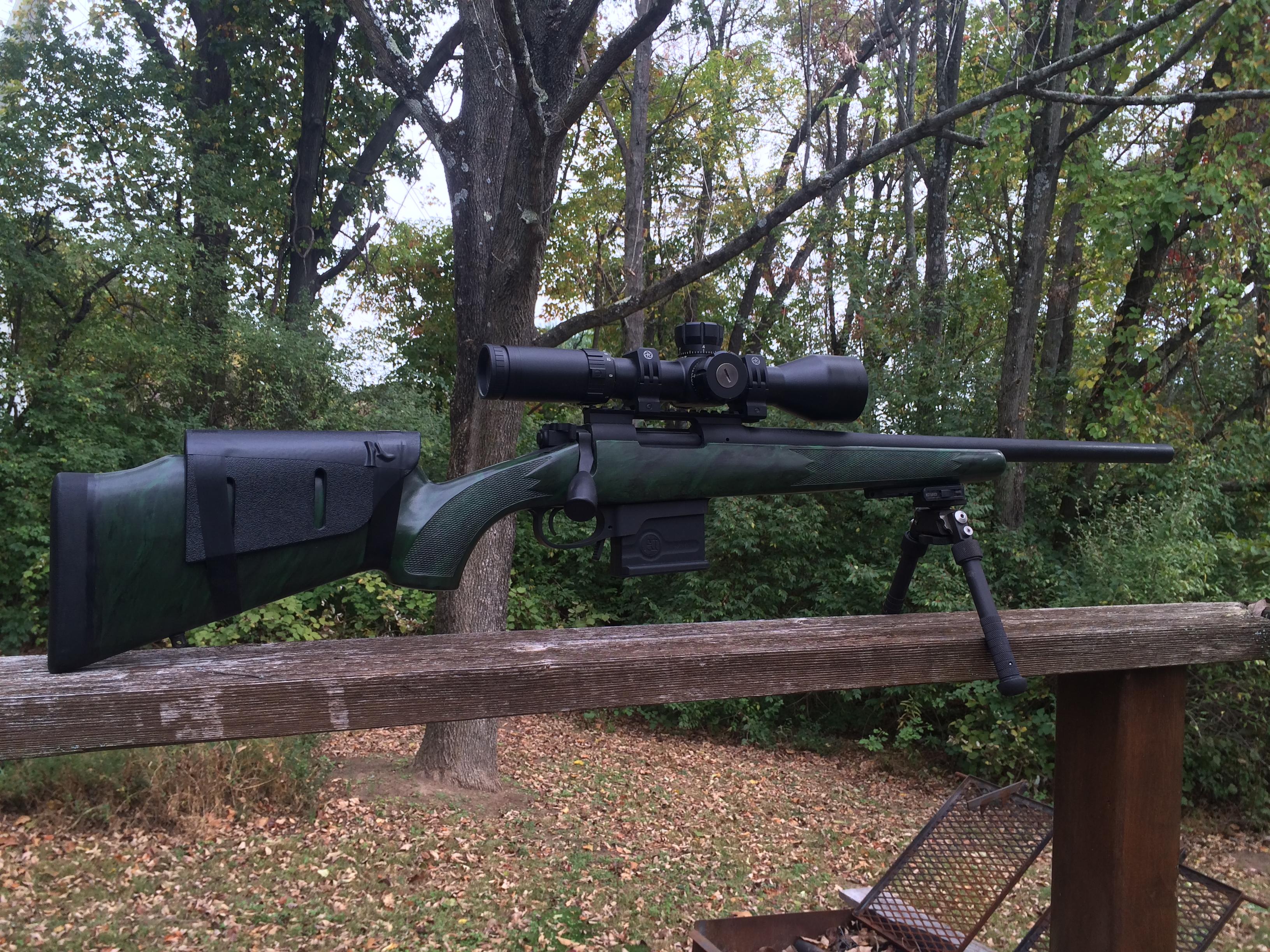

19.5" here., threaded for my suppressor.
I've shot it in the high desert out to 1200 yards.
I shoot 75 AMAX's over a stiff charge of 8208XBR in LC brass with a bushed bolt face.
It's really hard to beat the AMAX's BC/cost ratio.
Pardon the Mickey Mouse cheek riser.
I had it on hand and it works for the time being.
