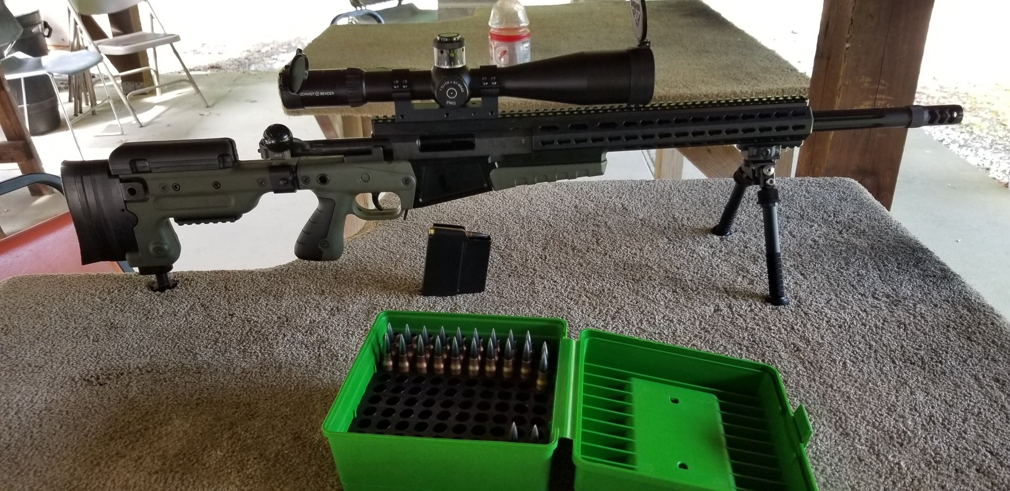

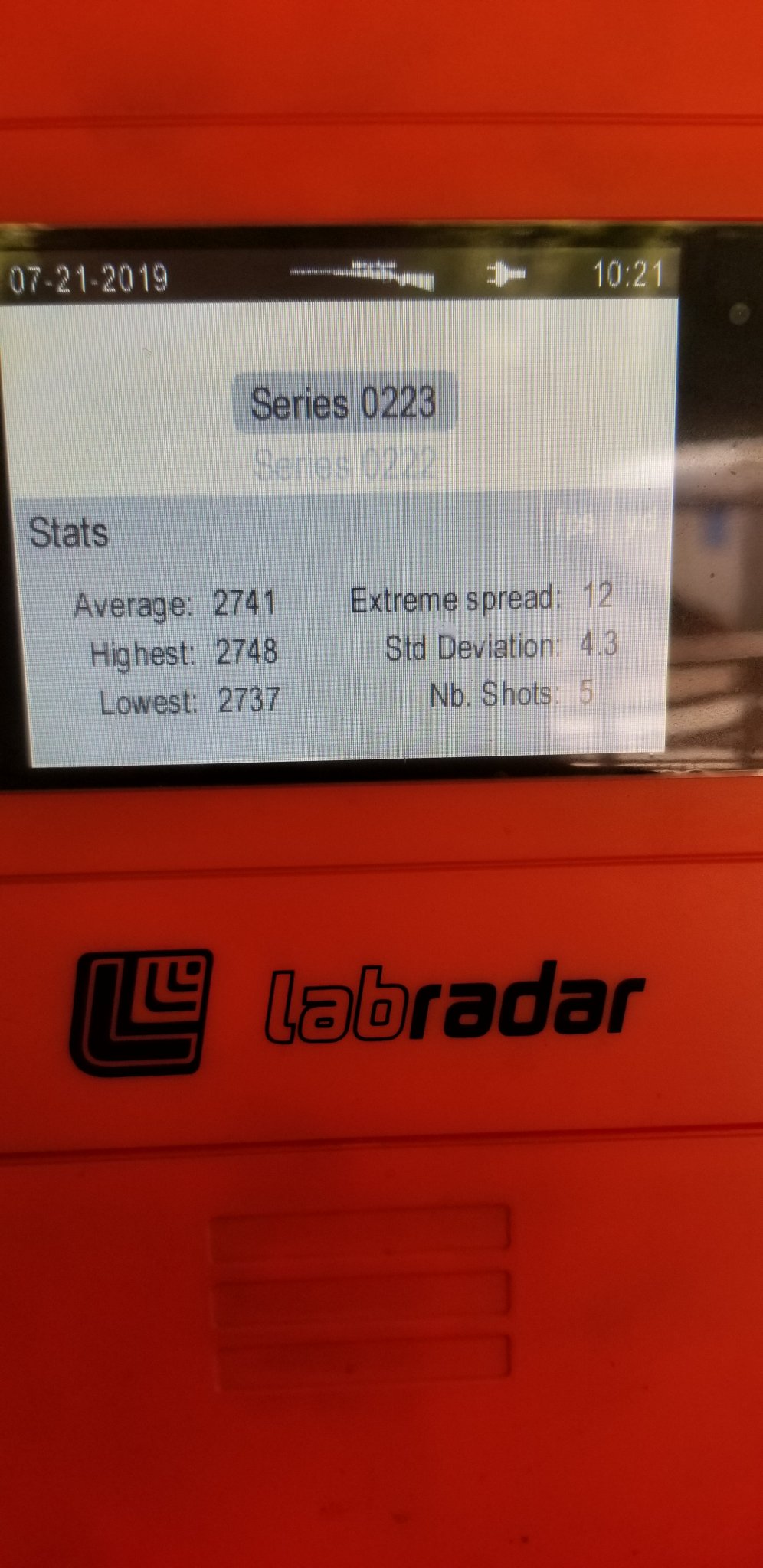

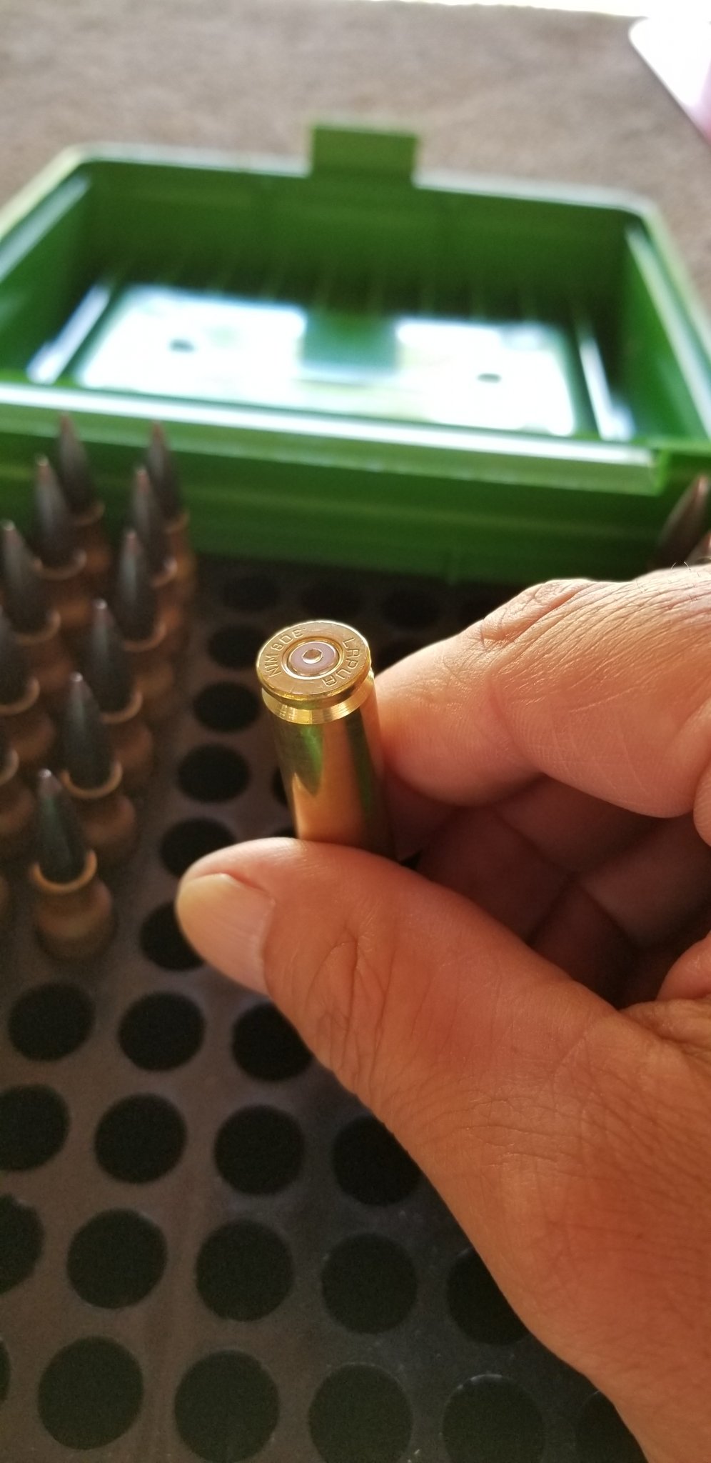

It takes some work and experimentation but you can get decent velocities out of a 308 w/20 inch barrel.
I using Lapua brass, 210m, RL-15, Hornady 178 ELD-M @ 2740 FPS with ES 15 and SD 7 out of my AX.

I've loaded for more than a few 20" barreled 308s. IF you are getting 2740 fps with a 178 ELD-M in Lapua brass, using RL-15 you have a unicorn. 99+% of the 20" barreled 308s out there are not going to see 2740 fps w/178 & RL-15 w/o trashing brass. Nominally, 2580 to 2620 is the velocity one sees with 178 from a 20" barrel. You are blessed with an exceptionally fast barrel, a special lot# of RL-15 and a perfect combination of components; enjoy it while it lasts as it is unlikely to be reliably repeated with new barrel, new lot # of powder.
Nada to do with work and patience. You are 120ish fps above what is achieved with a fairly warm load from a 20" barreled 308. Chamber, barrel, burn rate of that lot # of powder, etc are allowing something special. 2740 is pretty warm from a 26" barreled rifle, much less a 20" barrel.
918v's calling BS is valid, you are claiming something that 99+% of the time is going to yield excessive pressure, blown primer pockets or worse.

Both of your loads are likely 70k PSI or higher per Quickload, and well above SAAMI pressure max specs. Just because they have good SD/ES doesn't mean they are reasonable and safe pressures.
Generally speaking, going to a faster powder will result in higher pressures for any given velocity. Yes you have the potential to make more pressure because you can fit more powder in the case and have more total energy potential, but going to a faster power to make better speed is not usually the recommended approach.

Here are some shots from today's range session.
