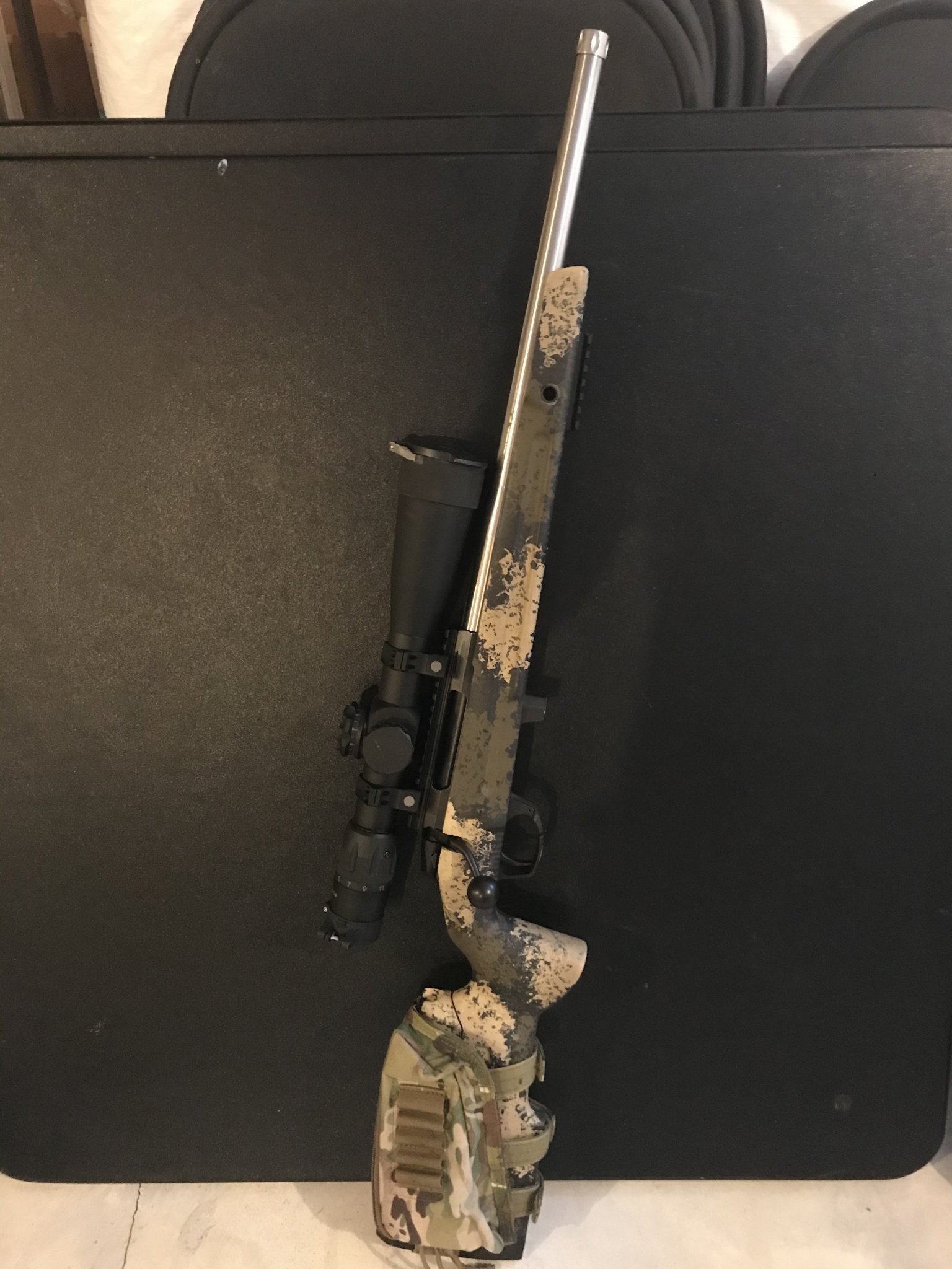

Did somebody say 7mm-08?
18” and shoots the 150 ELD-X’s very well. Not as sexy as new stuff but an old timey classic. Worth considering, but then again I’m clearly biased.
