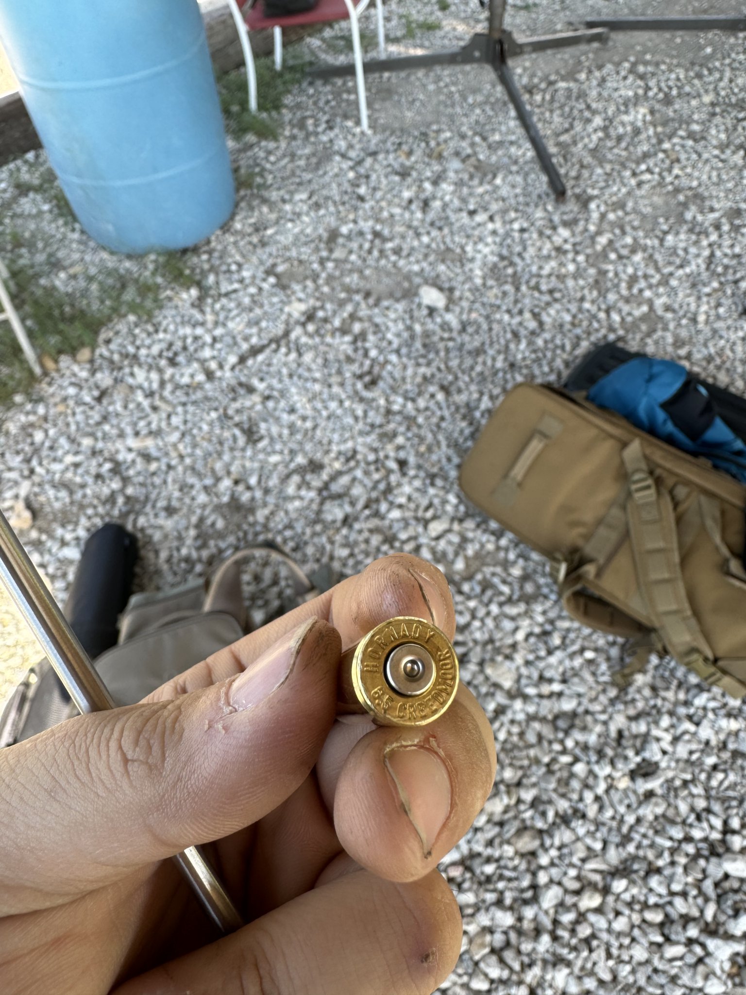

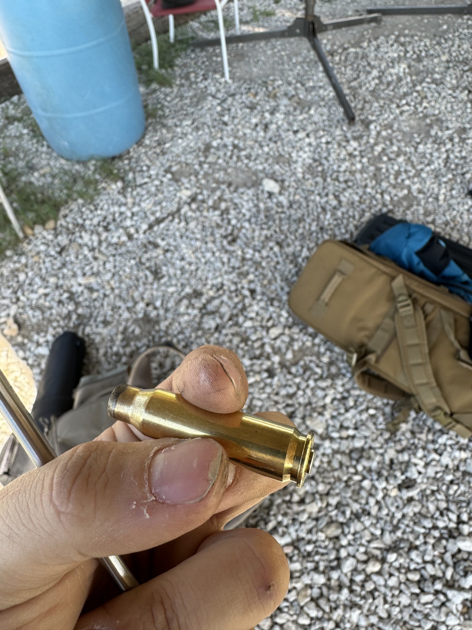

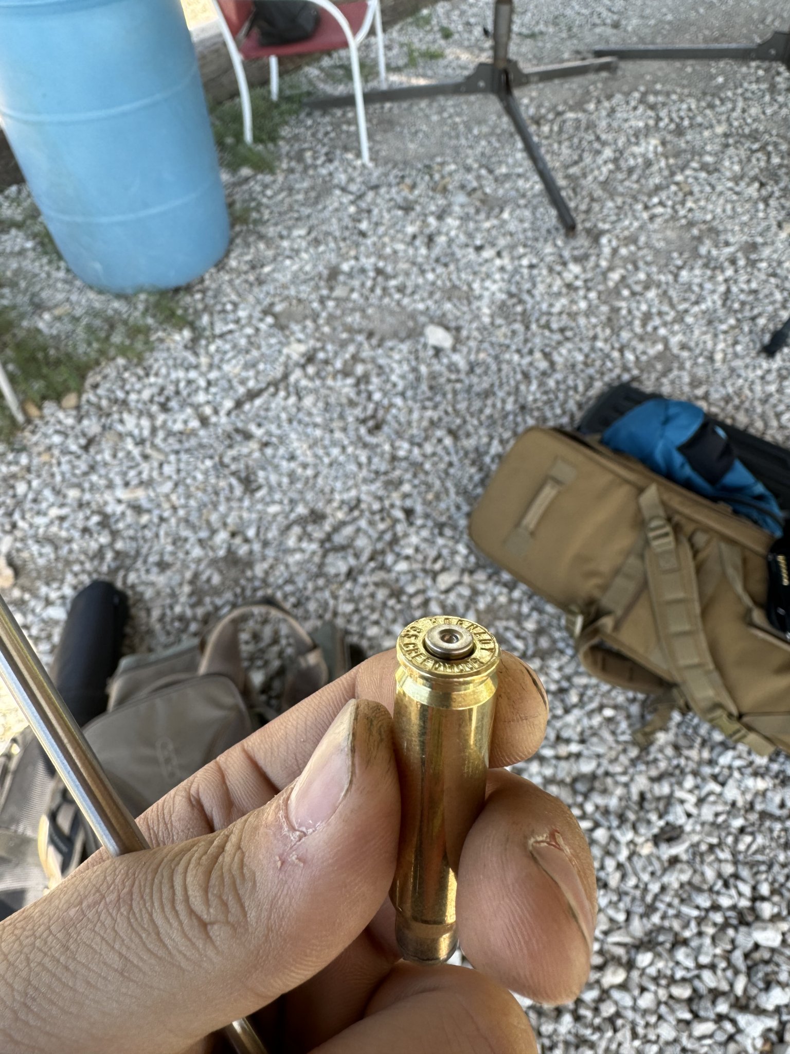

so I was with a friend on the long range today, I had a 6.5 and he had a 308, we are both shooting Hornady. he handed me a mag to try his 308 rifle, and when I fired it didn’t sound right, almost no recoil and very soft sound. I tried to eject the case and ejector wouldn’t catch the brass, used a rod to get the brass out. I figured something was wrong so we inspected the brass and found it was a 6.5CM and the primer is blown out of the primer pocket, brass it self does not look deformed. My question is, Will firing this 6.5CM out of a 308 rifle damage the rifling?

Luckily, copper and lead are much softer than barrel steel... So, like was said, 1 round shouldn't have damaged anything. It should be just fine.
And look on the bright side... Now you have a fire-formed piece of 7.62 Creedmoor brass handy.

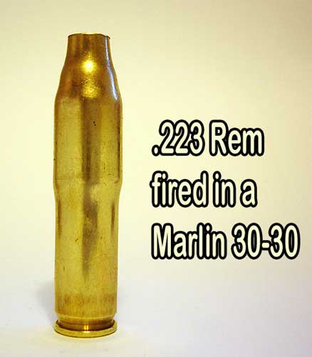

Buddy of mine borrowed my 40cal Glock and shot 9mm through it couple of years ago. No harm done. But plenty of people blew up their 223 by chambering and shooting a 300BLK round.
Reactions: MikeMiller
That's because it's like trying to shove a '59 Cadiallac into a doghouse... 😂
You can always bounce a smaller bullet down the bore, but bigger = problems...

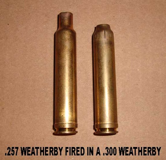

I accidentally ran a 243 round through my 7mm-08. I completely missed a 4'x2' board at 100 yards. I was sighting in my wife's 243 and my 7mm-08 for deer season. The Fiocchi soft points we were using had nearly identical boxes. The 243 easily chambers in a 7mm-08. I'm not proud of it and I have no idea where that bullet landed but thankfully gun was unharmed. It shoots sub MOA as it did before I screwed up.

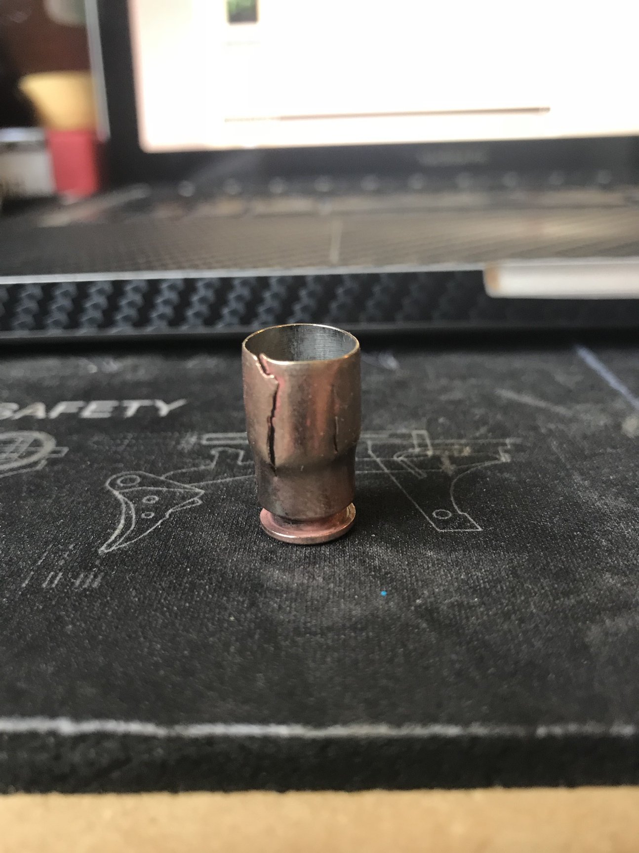

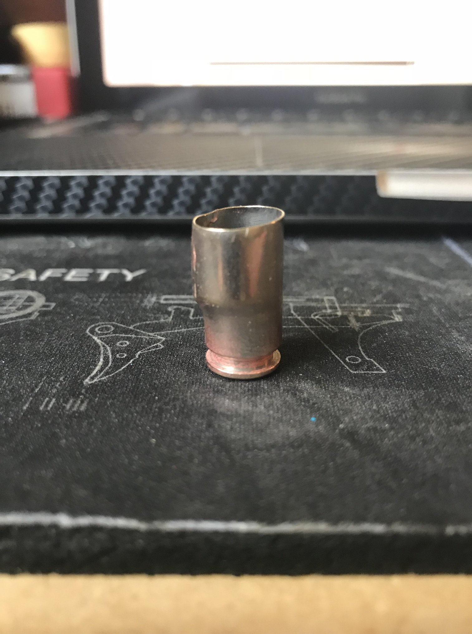

You absolutely can... Same base diameter, and same length case, just bottlenecked down for 9mm instead of a 10mm...

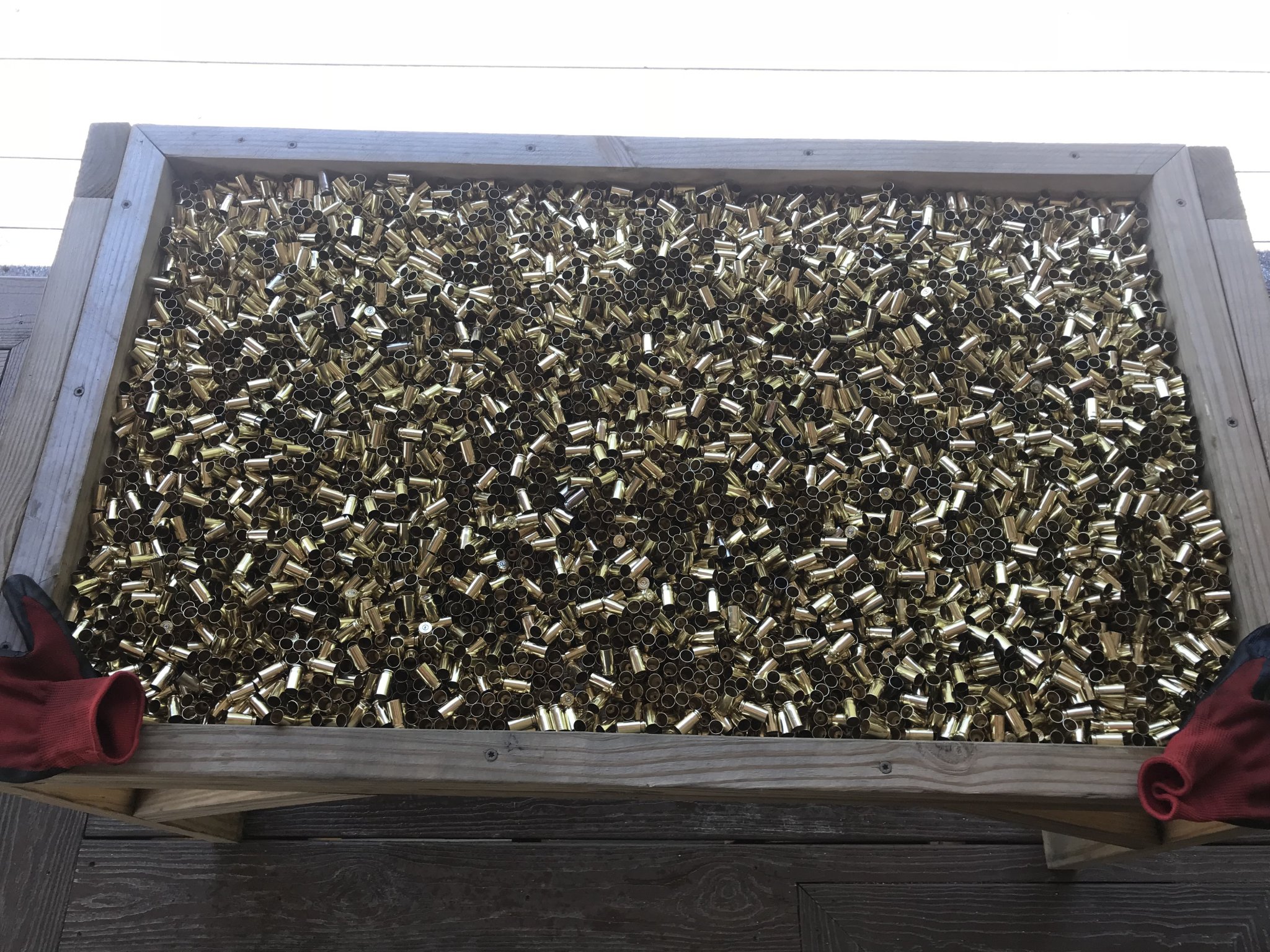

When I worked at the machine gun range, and ran the ammo plant, we would pickup brass that we shot at the range (and some we purchased from police/LEO ranges) and process it, and reload it, and I found MANY 40 caliber rounds that were blown out to a .45 (I'm guessing someone load the Thompson mag while not paying attention... 🤦🏼
Sifting through brass like this on the drying racks...

Yup, I am sure it was fine but just want to give my friend a piece of mind so I figured I’d come and ask some people with more experiences, I managed to hit 700 yard steel right after we cleared the 6.5 brass and chambered an actually 308 lol.

Clean the bore and shoot it before you dick around with it. Clean only because you might have a fragment or two you don’t see with the naked eye, and that could cause issues when you fire a correct diameter bullet.
When I was young and poor, I bought a few “shot out” rifles and after scrubbing the bore, they shot fine. Barrels are tough.
As some said above, the steel barrel is way harder than the bullets you were shooting.
