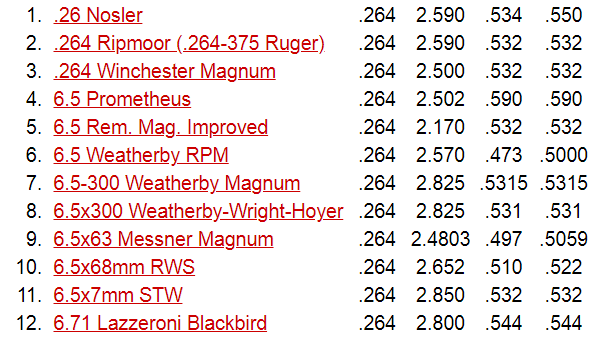

What application / site is that chart from? And what is columns 2-4?
Ammoguides rechamber tool, it will only show cartridges that will physically work.
I believe columns are: Calibre, Length, Rim size, Body size.
As you can see on the Weatherby 6.5 RPM, similar to your 6.5-284, it's body is thicker than its rim (rebated).
