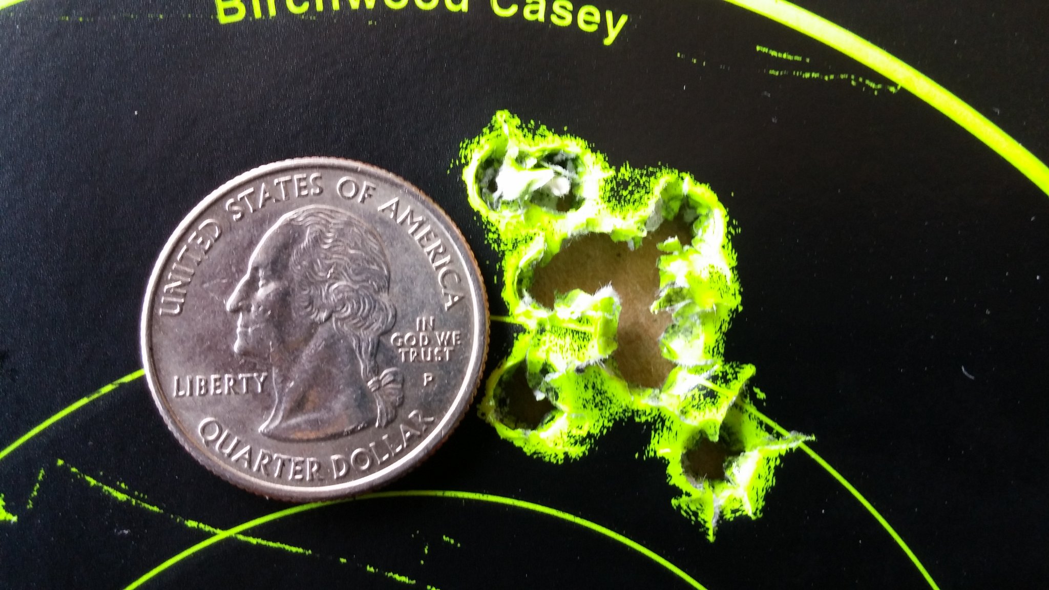

Hi all, obviously first post. Looking for some feedback from folks with experience. I shoot, for the most part, at a DNR range in SE MI, 100 yards. If I drive for an hour + some, I can shoot @ 300 yards.
I shoot for fun only, off a bench w/sand bags. My version of fun at 100 & 300 yards is getting the tightest group(s) possible with factory ammo as I'm not a reloader.
A few years ago I picked up a Savage Model 25 Walking Varminter in .204 Ruger. Have a SWFA SS 20x42 on it. As far as a "shooter", rifle is fantastic! Pic is, if I do my part, a normal group @ 100 yards (no wind). Now......although the rifle shoots great, the mags are AWEFUL and it definitely has the Savage cluncky action. Chambering a round has always been less than satisfying. It's rare that I can chamber a round without multiple attempts. Read a lot about it and apparently I got what I paid for....and that's fine.
Now that I'm a little more practiced at doing my part, fighting to chamber each round kind of takes some of the enjoyment out of going shooting.
I'm looking at getting rid of the Savage and picking up a Howa HCR in 6.5 Creedmoor. But, want to shoot just as tight, or tighter groups.
Questions is.....is it worth the money to step up to the Howa for the better action? Doing my part, can I get just as tight of groups out of the 6.5 CM? Asking here because I can read (and have) all the "reviews" on-line but now days have no idea what reviews are "paid for" and what are not.
Anyway....I won't ramble on anymore than I have already. Any input is appreciated. I don't want to spend a grand on the Howa if it's not going to give the same or better results than the Savage.

I'd have a tough time putting that into a Howa personally. The other thing is that your ammo costs are going to go way up shooting the 6.5 Creed if you are moving from a 204 Ruger. I guess that is assuming you reload. I have no idea what factory fodder in either of those calibers goes for. Additionally, the paper will never tell the difference in your investment in larger powder burn and heavier projectile. I would look at the Tikka offerings in your price range and maybe the Ruger PR. I'm a bigger fan of custom guns, but you won't get there on a 1k, nor do you need to, to shoot paper at a 100 yards. For that matter, you could even get a nicer rimfire and shoot tight groups at a 100 and really save money per shot fired.

That's pretty good shooting if that is a regular group, using factory across the board.

If that is a typical group you are doing pretty good in that department. .5" groups @100yd are pretty good. Sure some custom rifles will do better, even significantly better, but there are a lot more groups well over .5" than you would expect even at benchrest matches. With factory ammo you are doing great with those groups.
