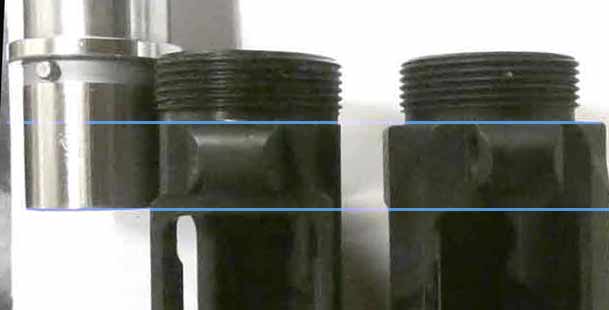

I keep referring to this image for barrel stability in an upper.
Clamping an extension to a faced upper holds the barrel to the thin threaded nose nice and tight.
If the extension has taper and fits loose inside the upper back where the upper has more strength
then expect it to move, wobble, when fired.
I'm guessing extensions bulge a little in the threaded area when torqued onto the barrel.
Nice tight fit for last 1/4" just means the extension doesn't fit the upper.
Blue goo, or my Spray On shim will fill the uneven gap but how do you make a tapered shim?
