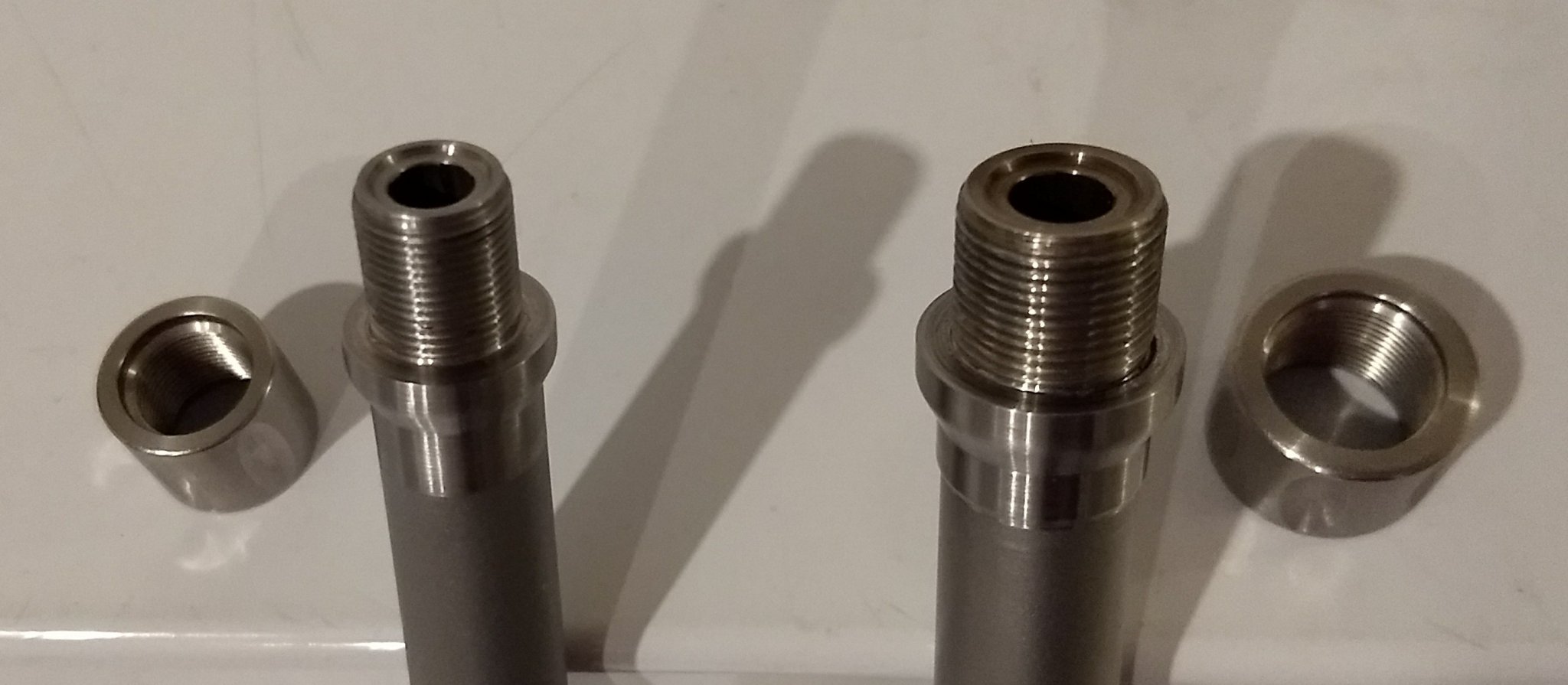

My Kimber is cut to 20", so I had to have Ecco Machine thread it and mount/machine a collar to create enough shoulder for the can to seat solidly. Same with my 18.5" X-Bolt with 5/8x24 threads, works well:
I usually use DT cans on my hunting rifles though, if you'll be using CB muzzle devices anyway, I don't really see a down side to just having TBAC thread your barrel and index the device to the muzzle. As long as you have enough barrel thickness for the 9/16x24 CB they offer (you're probably safe with the Tikka, but might well not have enough meat on the Kimber).
