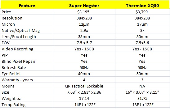

Have you ever compared the super hogster to the pulsar thermion xq scopes?
Here are specs comparing. The Thermion will be more conducive to use on a bolt gun due to it's more traditional scope design. The Super Hogster has a longer warranty, doesn't use proprietary batteries, is half the weight, comes with a locking QD mount, and is less expensive. Night Goggles sells both and both are nice thermals, but I own the Super Hogster.

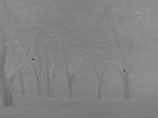

Here is a picture of the worst case scenario for using thermal, in fog,mist or rain where everything is the same temperature. Even in this thermal shines over everything else. Here are two squirrels in two trees after the rain where everything else is washed out due to the temperature similarity on everything. This is at 115 yards. As you can see the two squirrels still stand out quite well and would not have been seen with my PVS 14’s or a white light.

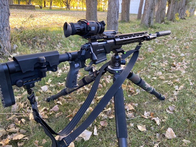

Kirsch - nice rifle set-up, new toy derived from the fur sales last year? Asking for a friend.
No, just wanting to try something. I love my 22-250 AR, but suppressed ARs tend to run very dirty, and they are a little noisy. I have only used it one night so far, and the bolt gun worked great. I have to use it more if I want to train my brain to automatically work the bolt. One of these days I am going to squeeze on a 2nd coyote, and there will be a spent round in the chamber.

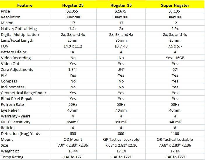

The 35 and Super Hogster look the same externally. Same size, weight, buttons, etc.
HOGSTER DIFFERENCES:
FOV:
Super Hogster 7.5°, R-35 10.7°, R-25 14.9°
Base Magnification: Super Hogster 2.9x, R-35 2x, R-25 1.4x
Recording: Super Hogster Internal, R-35 and R-25 Video out
Wifi Integration for Super Hogster only (Android) including screen streaming and viewing/downloading videos and images
4 Additional Reticles with Super Hogster
Compass and Inclinometer included with Super Hogster only
12µm for Super Hogster vs 17µm for Hogster 35 and 25
Zero adjustments are smaller on the Super Hogster at .67" vs .94" and 1.34"
Super Hogster image doesn't degrade as much with digital zoom as the R-35 and R-25
The chart below compares them:
FOV and magnification is a personal choice. However the more a person hunts areas like heavily wooded areas where the field of view is somewhat limited, the more a wider FOV becomes critical. Also, the more a person hunts large groups of animals, such as large sounders of hogs, the more a wider FOV can be helpful.
As for comfortably shooting, the R-25 has a comfortable range (with PIP turned on) of around 150 yards. The R-35 to about 200 yards, and the Super Hogster to about 300. If you ask me would I rather shoot a coyote with the Super Hogster at 200 yards or the R-35, the answer is still the Super Hogster as the animal will look a lot bigger, and I can make a more precise, confident shot. However, if I have 50 hogs at 50-100 yards, and want to shoot at as many hogs as possible, I would go with the R-35. If I was hunting in heavy woods, I would go with the 25, etc.
Yes, that is correct. The 25, 35, and Super Hogsters have been super reliable. When your thermals work, they don't need firmware updates. I used a prototype model all last year and it worked great. I have requested Bering add a firmware update to the Super Hogster since it can act as a drive since it stores video files. It isn't available right now but maybe in the future. I have used many brands of thermals and at this time in my opinion, there is no better value in thermal than the Hogster line up.
