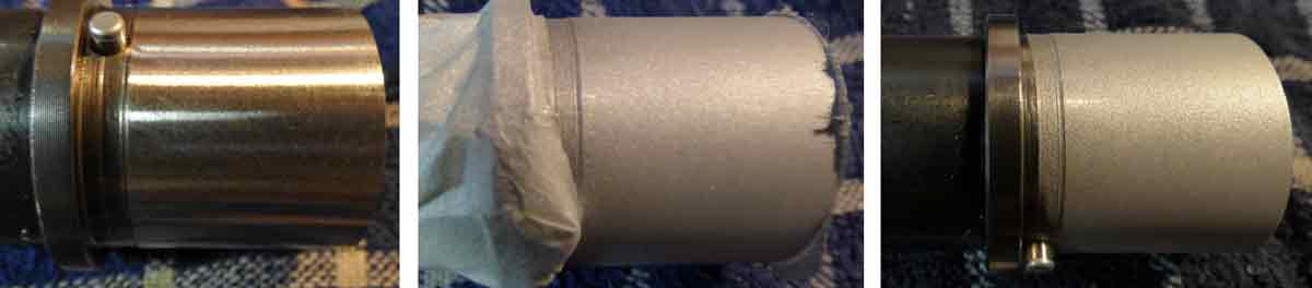

I use a slightly different approach.
Spray on high temperature paint on the extension, masking the flange off.
I think it's possible to apply a thin, somewhat uniform 0.001 to 0.002" coating, burnishing it smooth, chilling/heating for a thermal fit then assemble. Paint doesn't have the compression strength of stainless steel shim stock.
I feel lapping and shimming creates a more solid joint.
Heavier uppers add a little resistance to flex.
It's that two inches or so in length around the joint that is the basis for upper stability.
