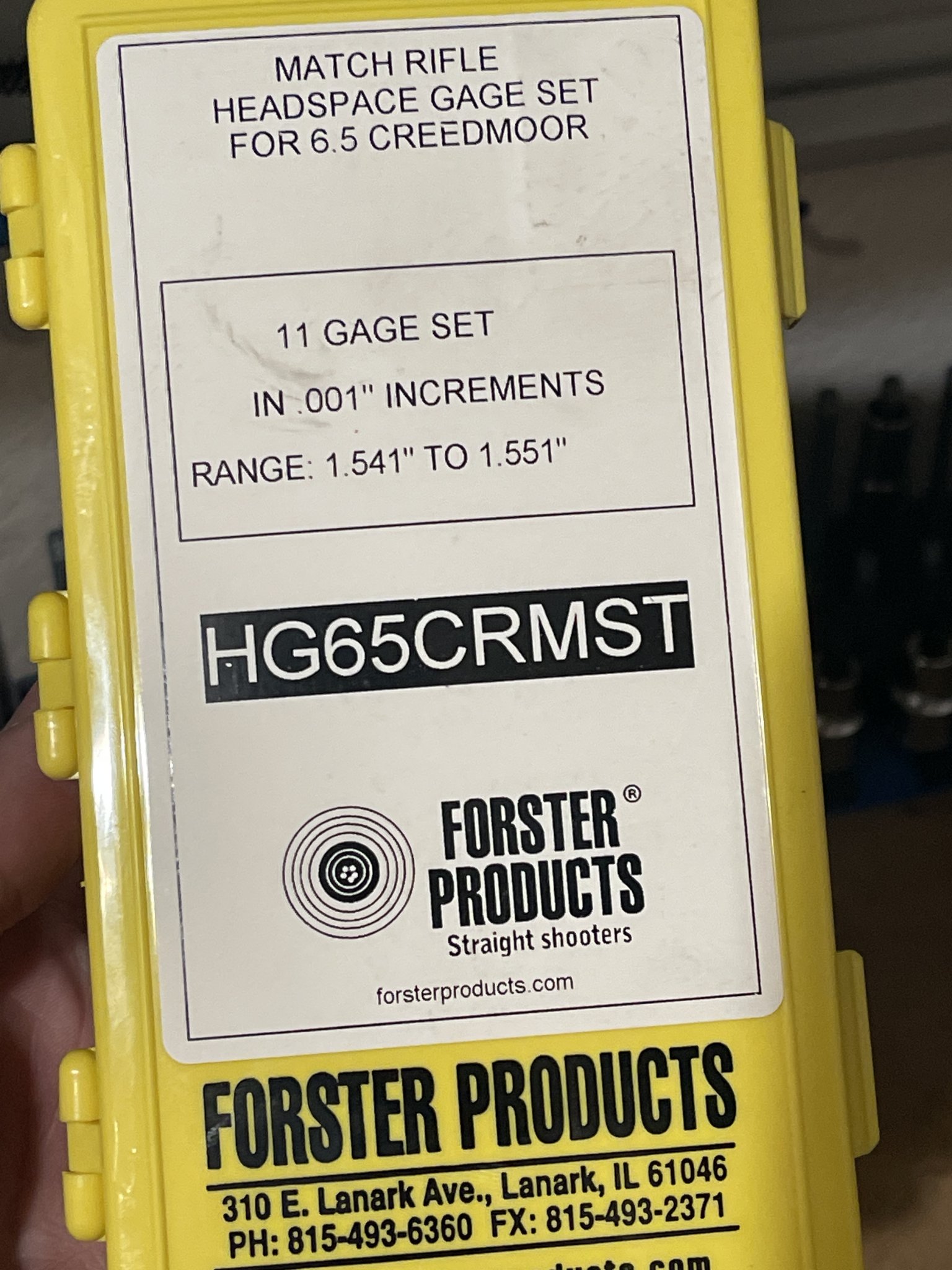

Here’s saami spec headspace range for a 6.5 creedmoor
I use these gauges to set up my fl sizing dies for .308 and 6.5CM. For other cartridges, ill use the reamer diagram to start and adjust from there.
Ask for the drawing...
Reactions: Max_The_Phoenix
Your measurements are all over the place. Something’s wrong with either your tool, how its set up or how you’re using it.

I start inserting gauges into the rifle until i get one that fits cleanly, starting with the longest. Then I set that gauge in the comparator, zero the indicator then stick a piece of brass in the press.
Size, measure, adjust until the indicator shows -.002.
Reamer print: i size a piece of brass until it matches the reamer print dimensions then adjust until i get -.002.
I then test fit to ensure bolt closes cleanly.
If i have neither reamer print nor headspace gauge, i rely on fired brass from factory ammo or a handload with a nominal charge weight. Most of the time, fired brass works (my measurements are all within .002 or so, not all over the map like the OPs).
Ill put pics using the gauge if the above explanation isn’t sufficient.

I like nn8734‘s approach and I have a similar method. The Forster HS gauge set is nice but Forster stopped making them. I use a go gauge and then use aluminum foil on end with a smidge of paste to find exact headspace (reg foil is about .0004 - .0006” and ” and heavy foil is right at .0008”). I do this on a newly chambered barrel and then I have a set target number for the rest of its life. If I want .002 bump, all I do is index off of the go gauge. I will confirm case fit in chamber for early sizing.
regarding the use of a reamer print, I believe all such prints just show the SAAMI HS range Min to max. This is because the gunsmith sets the actual HS with a go-gauge and normally does it at SAAMI min but the customer can specify.
