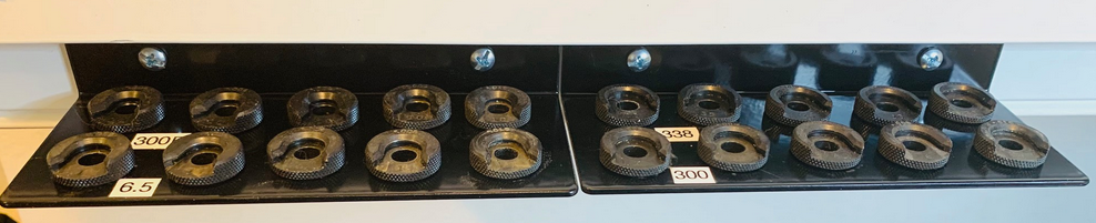

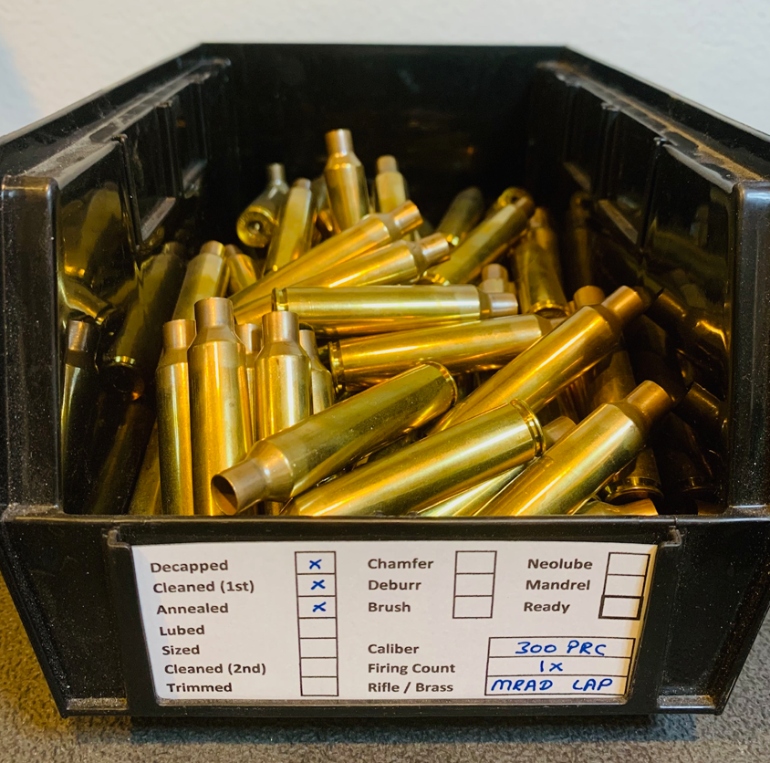

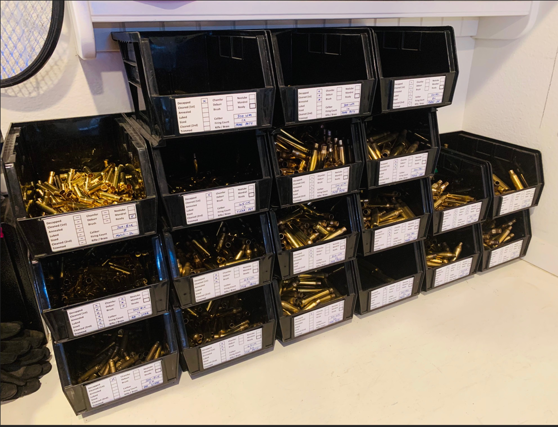

I agree ... if you're just doing 15-to-20 cases. But sometimes after a match or ignoring my brass, I'll have 100 or more cases, and lubing each and every one is a PITA. For that, I throw 50-ish cases into a big zip-lock baggie, and spray in a bunch of Hornady Lok-n-Load case lube. Then I shake the baggie around, and add spray lube a couple more times. At this point, I've used enough spray lube, and shaken around enough cases, that everything is good and lubed. I just work that pile of brass that's been decapped, cleaned, annealed, and lubed ... and get it ready for the post-sizing cleaning. I keep track of status and sequence for each firing and process step, with the ACRO bin tags shown below. Kind of OCD, but it definitely keeps me organized. If you have a couple of different firings, on four or five calibers, in a variety of case-prep states ... staying organized is important. If you only reload one caliber ... not so much. I reload 300-BLK, 6.5-CM, 300-WM, 300-PRC, 300-NM, and 338-LM. Side note: I haven't seen a bump difference between sizing wax, and spray lube.
View attachment 8407291 View attachment 8407292
