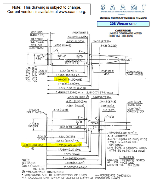

This is the saami print. Notice that the case tolerance is 1.634-.007" so anywhere from 1.627-1.634 would be expected.
The chamber tolerance is anywhere from 1.630-1.640. Thats .010 total, you have .025 for 2.5 times the allowance.
Now, a gas gun thats over gassed and starts unlocking early may allow for some additional growth over those specs but still... .025 is a hell of a lot of difference.

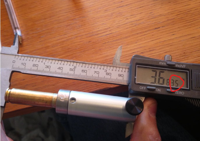

The factory Lake City measured here is the baseline for my tightest chamber. That measurement using my Sinclair bump gauge is 3.635. That number is dead smack in the middle of the number Spife highlighted above! I can't go anymore 5 thousandths over that or it starts to bind/drag. So I have a baseline measurement that works and is within the SAAMI spec. Hopefully the new dies will be more precise on adjusting.

Your variance of .005 in shoulder set back seems strange. Do all of your brass from that lot measure 3.683-3.684? If so then something is amiss if they are that inconsistent.
Also, with the gauge on the calipers close the jaws and zero it so we don’t have those dumb wrong digits. Just makes it easier to interpret.
What is your lube process? Could be under lubed causing it to stick and resist sizing that’s leading to the .005?

The PPU brass could have been made worse by an incomplete stroke or not enough pressure during FL sizing I just don't know and probably not worth spending anymore time on without the new dies and the controlled measuring before and after that you mentioned. Went back however and did some measuring of new PPU rounds. Un-fired, they are either 3.6840 or 3.6845 with most of the sample at 3.6845 or out of spec!
Those calipers are brand new and holding zero every time i checked them. I use light Royal Purple as my lube. Press is a Lee 50 BMG single stage.
Ok so besides me reading the wrong decimal place on a digital micrometer, I have this figured out. First issue is the "play" on my press. The shell holder tension ring (on the press) accounts for at least .002 of variability. I confirmed this with a feeler gauge. This is why the preloading (over just the touching of the die and shell holder) in my case is required. Second issue is possibly die itself. I can now "feel" when the shoulder is or is not bumped. Precise control the amount of bump is really difficult. No matter how a fiddle with preload, the bump is a minimum of .002, typically ends up at a .003 increment.
Fixed all my brass, now know how to properly measure the shoulder and understand the variability introduced by the press. Miracles do happen!
