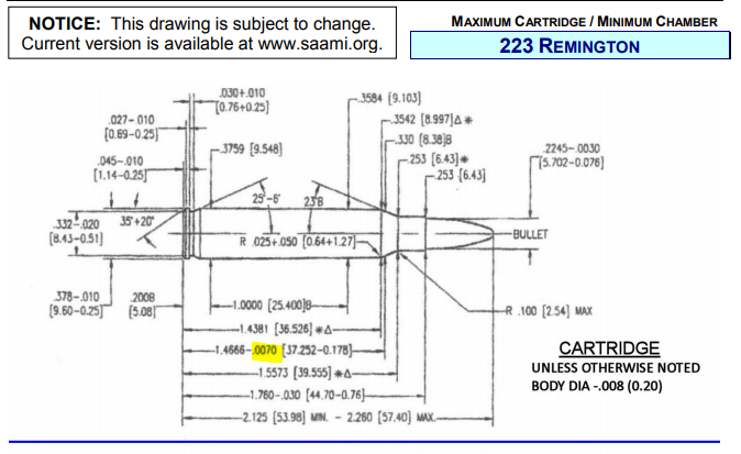

There is a spec of around .007" of play in the cartridge shoulder spec where something can still be "in spec", thats huge for us reloaders who try to limit over working of the brass. (Dont worry about the actual numbers matching this print, your comparators actual measurement number on the calipers will differ, its just the difference in the fired vs sized that we care about.
7102466
The issue is that with a full length die and a fired case thats not quite full chamber size you have a bit of play/empty space in there. If you were to squeeze the base smaller but with the die is situated high enough up in the press so that shoulders are still unsupported inside of the die then those shoulders can move forward on you so that even though it was "sized" the shoulder location has frown and is now too long for the chamber. Think of it as a playdough snake, you roll it around in your hands and it gets longer.
You could also be sizing it waaaay too small also. We choose .002 as it is enough to get clearance without provided more than needed and shortening brass life.
