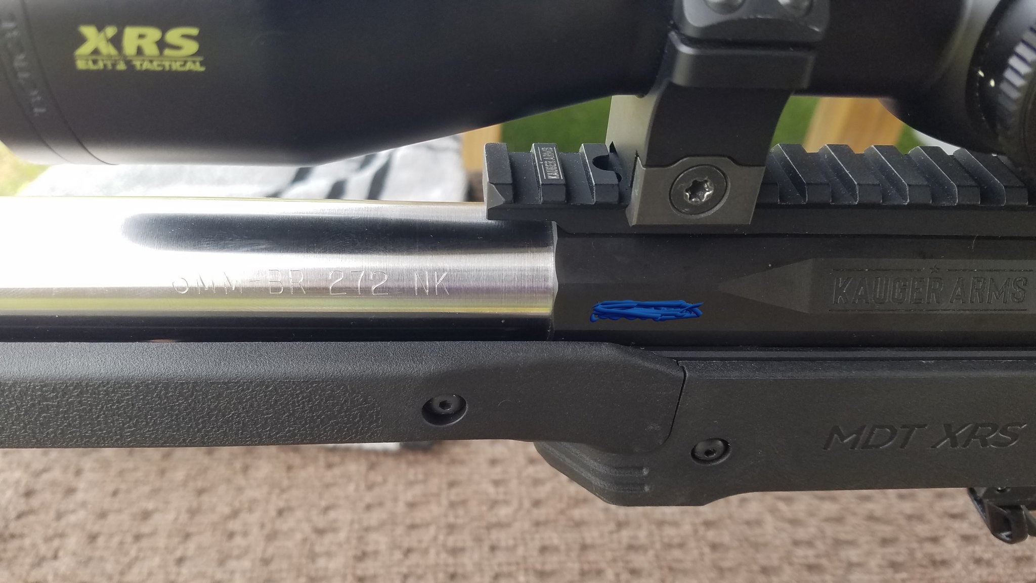

Here's a prefit that I recieved last month.
Gunsmith never even touched the action.
Engraving lines up perfectly.
