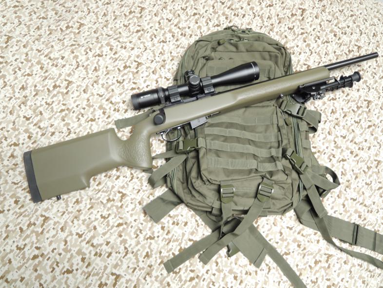

Picked it up monday. It shoots pretty nice.Posted a few pics on the cz tacticool is here thread.
Need to replace the jenky champion bipod(it was a homeless workbench roamer)

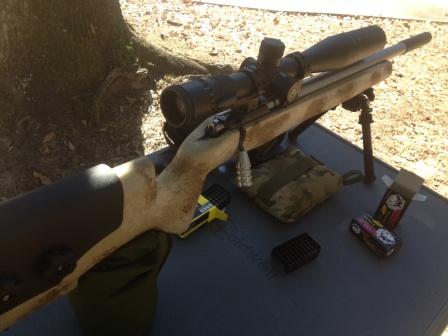

Won this CZ455 at the 2012 SHC. Built by Accurate Ordnance.
Had my Smith install the Badger EFR. Optic is Night Optics M845. SWR Spectre suppressor.
Great setup for 'coons in my backyard @ 50-75 yards at night.

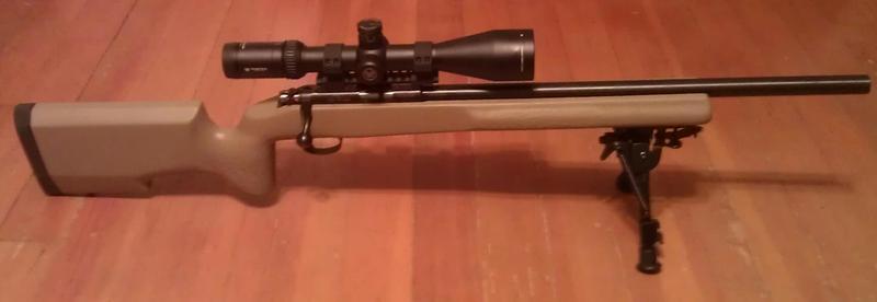

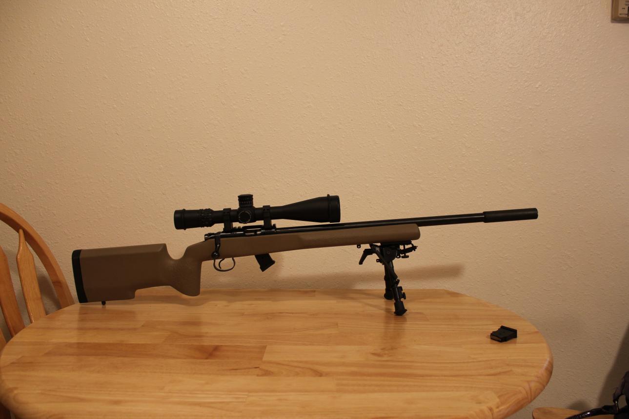

Here is mine. Stats first, then the pics:
455 Precision Trainer
Lilja .920 straight taper, cut to 17.5" and threaded for my Sparrow
Timney trigger
DIP bottom metal
DIP 25 moa pic rail
Harris 6-9 with KMW pod lock
TAB sling
Bolt cocking geometry modified by jbell (MUCH smoother cycling now)
Action and bottom metal bedded by Jbell
Silencerco Sparrow
SS 12x42 mil/mil
Action and BM coated in Coyote Tan
Manners T4 painted "desert multicam"

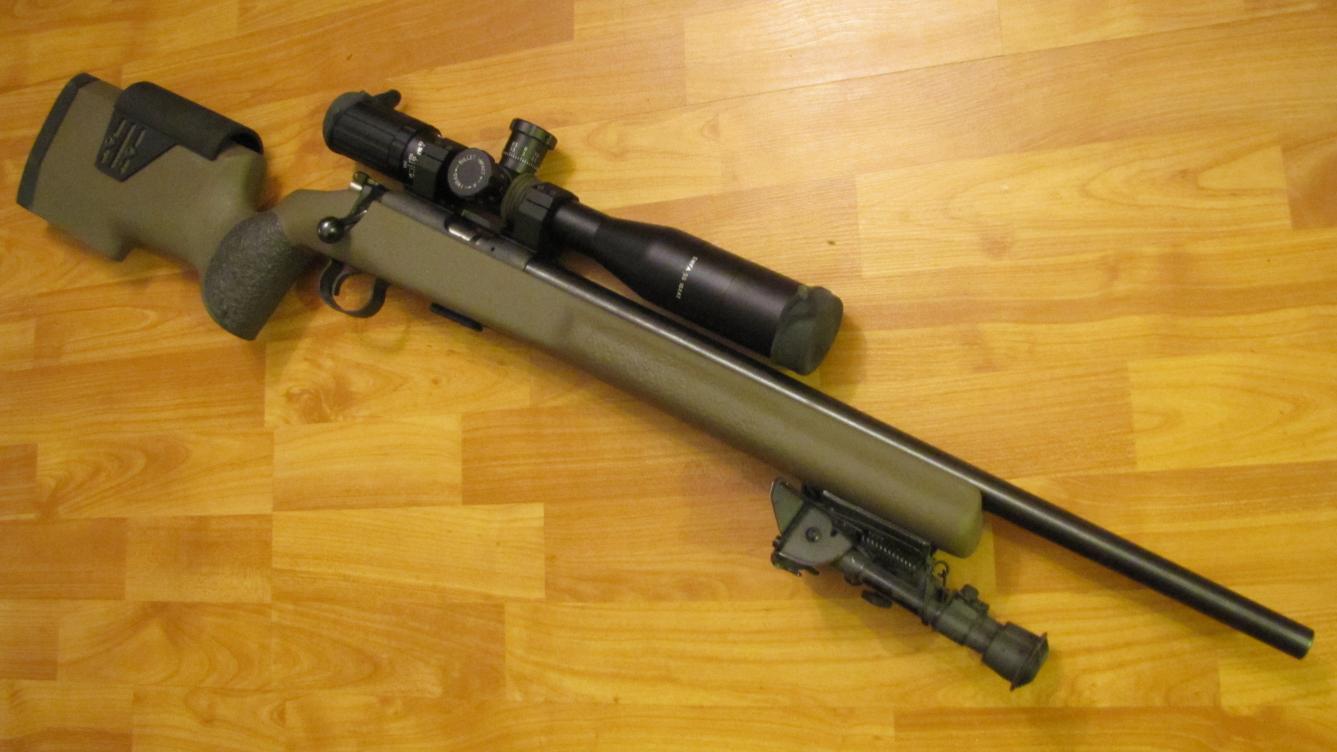

Here is my Lija/CZ 452 on my Hyde Manners stock rebarrelled by John Whidden and some 50 yd targets. I bedded it at put in a Timney trigger. Thinking about a more powerful scope as it seems to be accurate enough to use it. My crappy eyes are curretly looking through a Viper 6-20x. My cheapest scope is on probably my most accurate rifle. I might take the March off the 308 and try it sometime as it has a little higher power and better glass. There must be a bunch more as they sold a lot with the group buy. I like the pictures posted- go beefcake. I just noticed this thread. Thanks to the Hyde for the stock.
