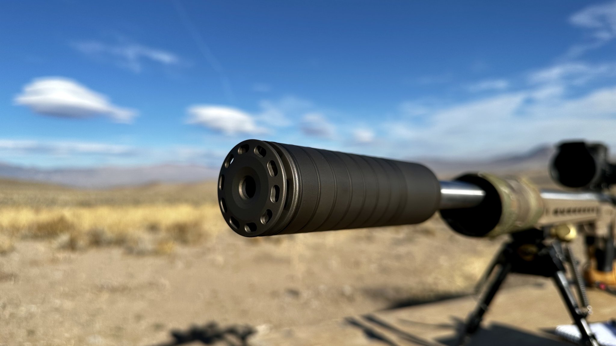

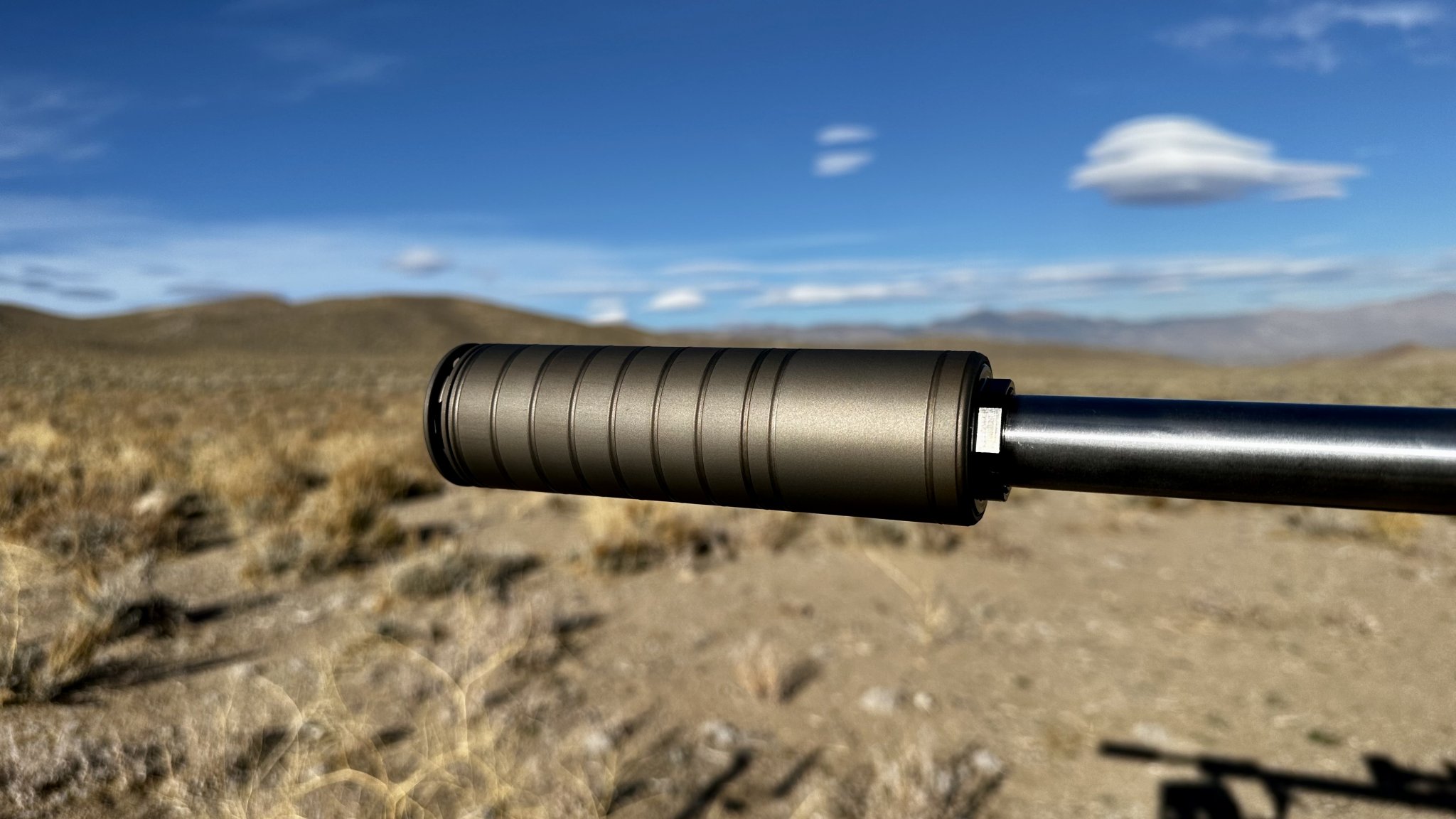

    The Scythe is a 100% titanium can which is 6.16” long, 1.76” in diameter, and weighs 7.3 oz (more on that). Its 300 Rum rated with no barrel restrictions. Thats pretty stout, and after a quick perusal of the web, there are other rum rated small ti cans, but none without barrel restrictions. It comes with a direct thread mount and a single baffle brake. It also includes the bravo tool, a spanner tool, and something they're calling the radial tool.

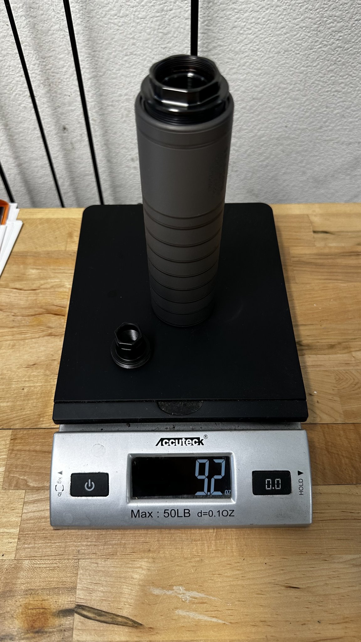

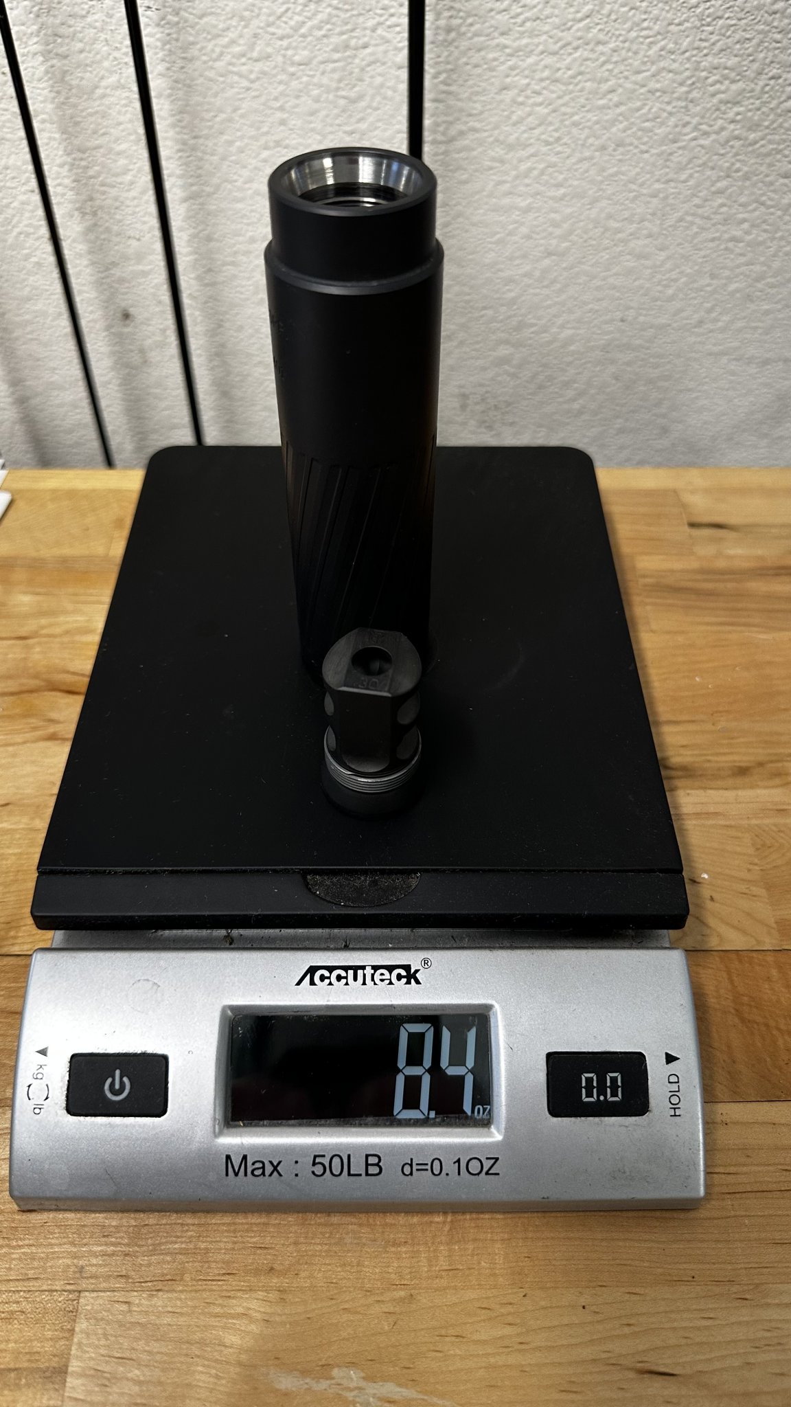

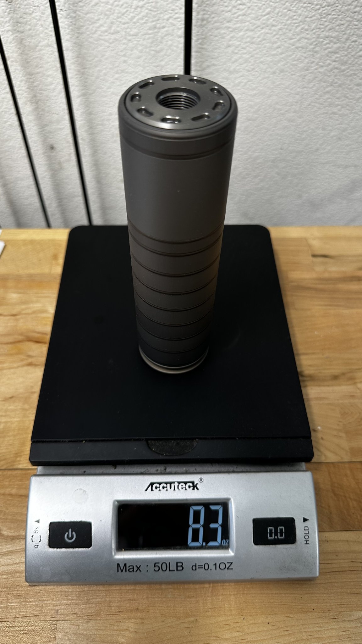

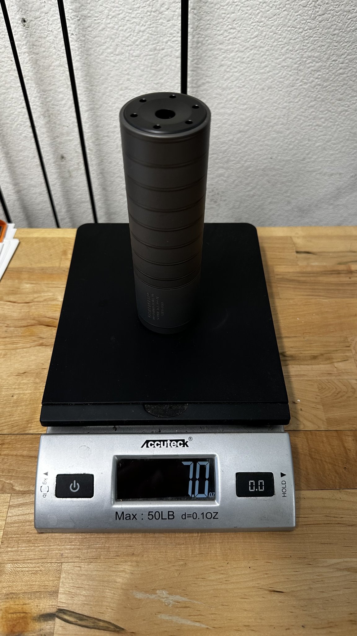

    The Scythe looks very well made. All of the machined surfaces are perfectly finished, including the threads. The laser welds are perfect. There is a slight color variation across the can surface (see below). The advertised weight of 7.3 oz doesn’t include the DT mount. On my scale, the complete can weighed 8.3 oz, with the DT mount weighing 1 oz by itself. Definitely on the light end for Ti cans, but 7.3 oz with the mount would have been awesome. My firing tests used a Ti Area 419 suppressor adapter on their standard steel universal-adapter, which weighs 8.5 oz total.
    Weight with DT adapter and brake.
    Complete weight with the Ti Area 419 suppressor adapter and steel universal adapter.

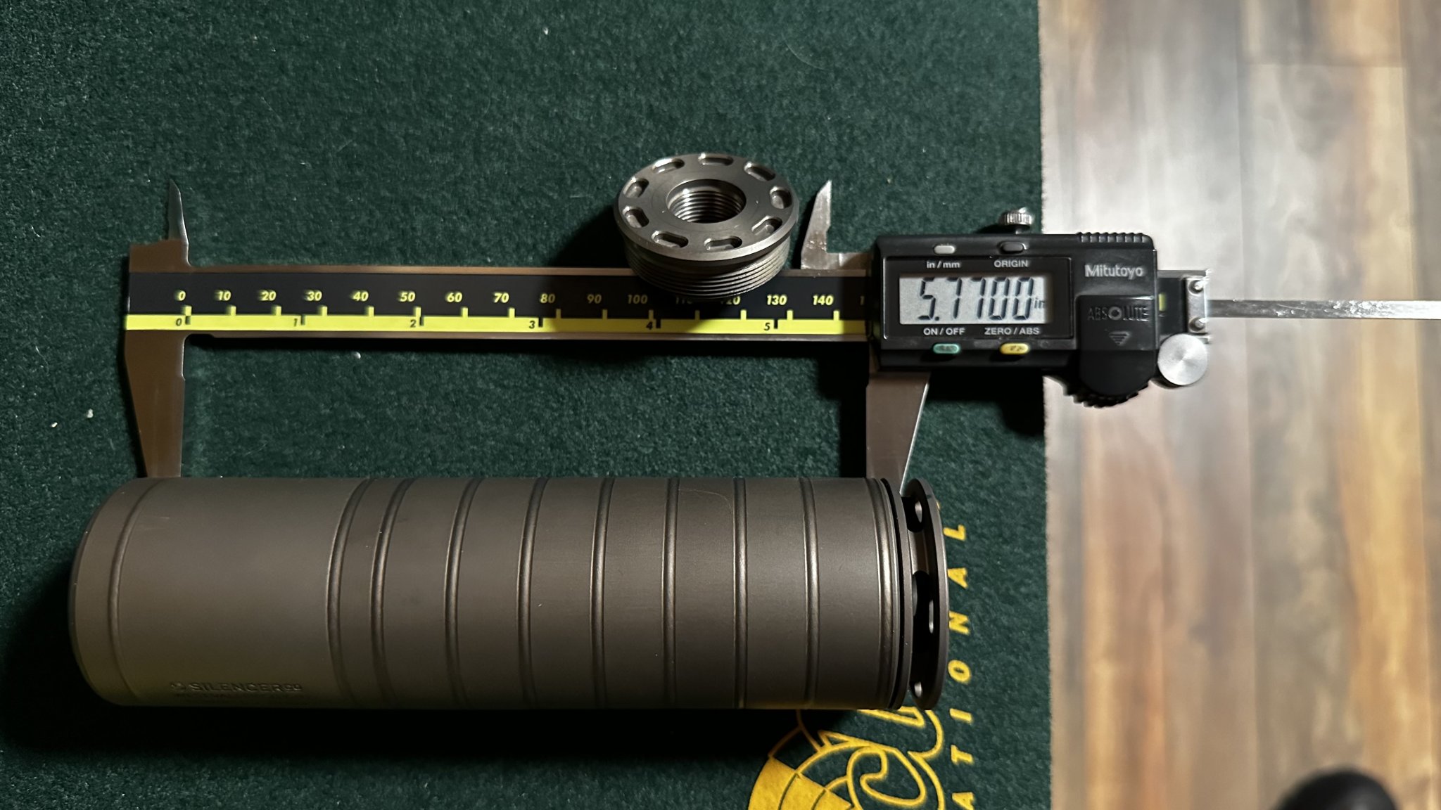

    I cut a muzzle thread in the lathe and took the opportunity to check the straightness with the included DT mount. Measuring from just inside the end cap bore(not the brake baffle), total indicated runout was just under .0035”. This is very good, and basically what you’ll find from Thunder Beast cans.

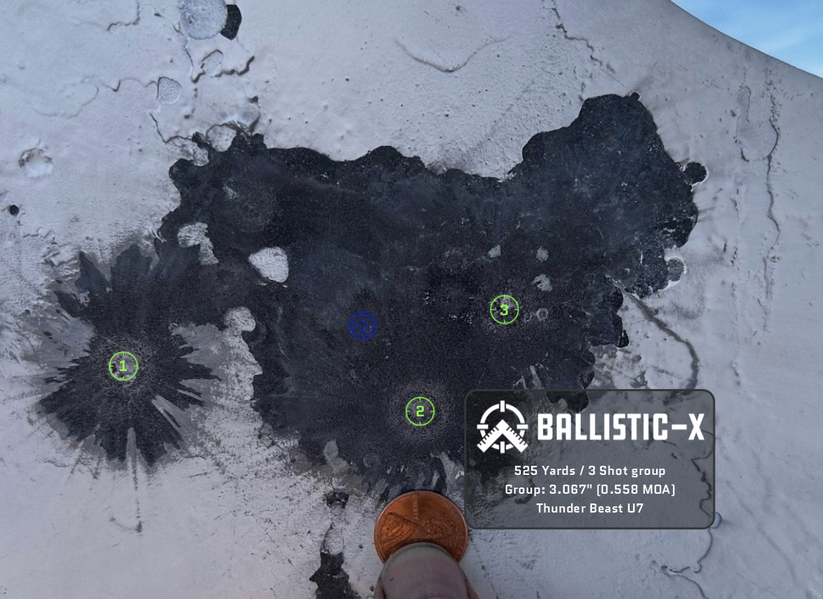

    I didn't go crazy with the the firing portion. I used a U7 Gen 2 30 as the baseline since its zeroed on my 6cm. Two three shot groups with each can on steel at 525 yards, dialed for elevation with no adjustment or holding for wind. Cans were swapped between each group. It was a calm day but the first two groups were affected by some left to right breeze. Very small test, but there doesn't appear to be any meaningful degradation of accuracy or shift as compared to the U7. If you're wondering, both cans shot one .5 moa group and one .3 moa group.
    First group fired, largest of the test, U7 30.

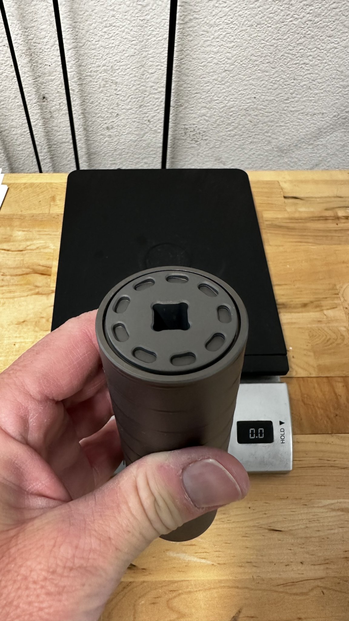

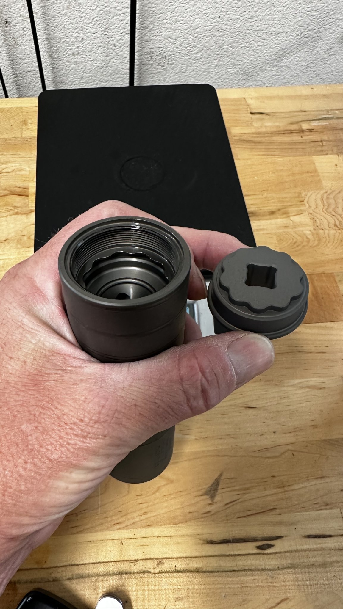

    There’s a downloadable manual on the website which makes mention of a radial tool. It doesnt show a picture, or talk about its use, but it must be this thing. This would allow for tightening the can onto your mount of choice. I like the idea of a soft vice insert for the purpose, but this works too and doesn't require a vice.

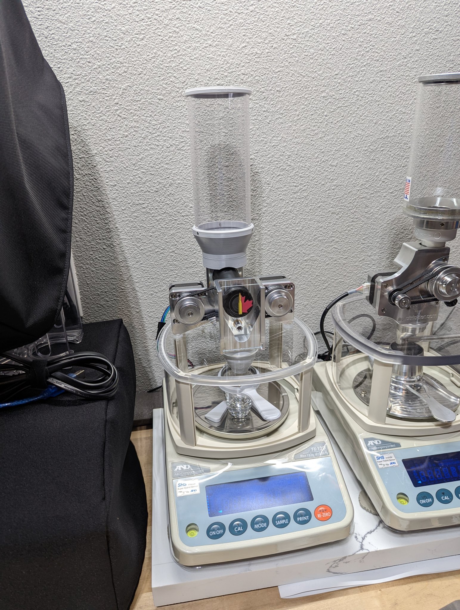

    While the reply is much appreciated, it doesn't change the fact that a few of us continue to tinker with the product to get it to work (level, tape shims, calibration, whatever, etc.). Myself and a few others who use the V4 have overthrows that never existed on the V3. The issue is the small tube causes kernels to clump and then suddenly drop with slow trickling. This is not ideal. I regularly have 20 perfect throws followed by a few throws that are over by 0.5+ grains, for example. The speed of the V3 is significantly faster than the V4. I can post a video to demonstrate this easily.
    I mean, a previous poster demonstrated developing a tip to prevent this issue. So, yes, the issue still exists and persists. I know many local shooters that have similar issues with no solution other than increasing tilt, though it appears to be a temporary one.
    I am no stranger to your units and have used them for years. Not stirring any trouble, just giving some honest feedback.

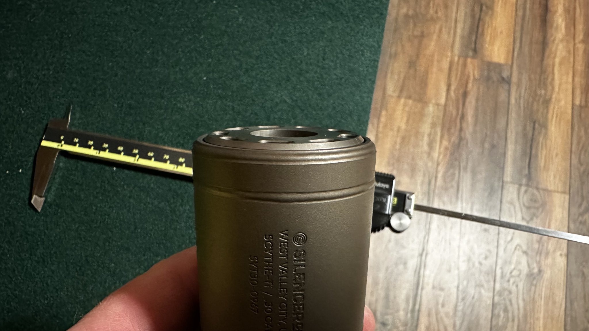

    @Supersubes can you help me with a measurement of tube length not including the brake. I ordered a mirage cover and they need that dimension. I've read 5.8", maybe 5.7" would be a safe dimension to provide?
    I use Cole-Tac covers and order them 1/2” short. So in this case 5.25”. Cole-Tac says order 1/4” shorter for the Python cover they sell.
    Edit: the caliper pic is just the tube length, I installed the DT adapter after. So 5.8” is about dead on if you include it.
