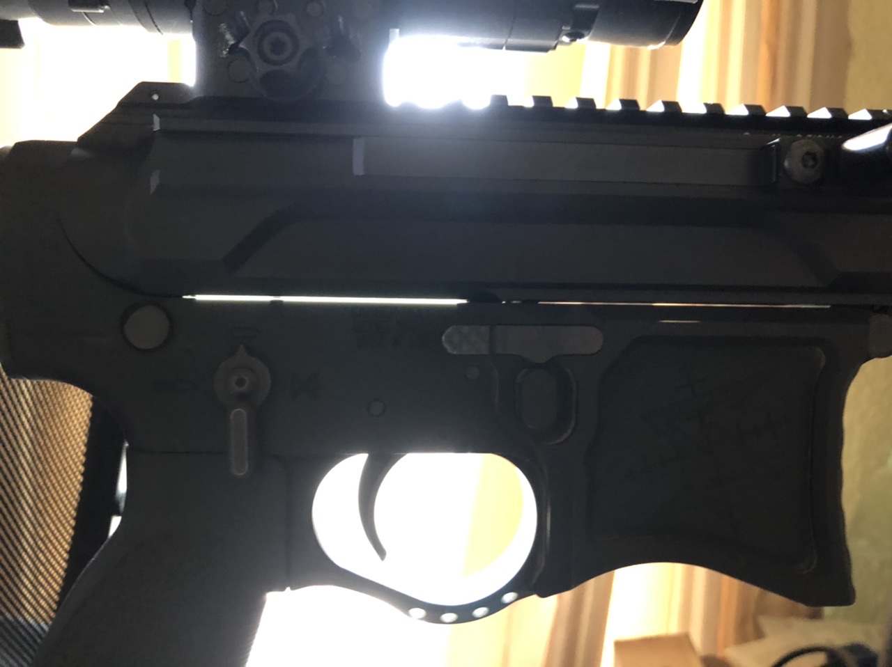

I’ve have/ had two of the Gibbz uppers and was not happy with the fit with either of them. Maybe cause they were lefty but there was a gap all the way front to back between the upper and lower. The second I bought as a set thinking they might hand pick them to fit but same slop. Managed to dial some out of the first with the Seekins tensioner and the other I put on a Radian lower that has a spring loaded tensioner I think. Gibbz said they were in spec...
Looks like a fair amount of gap! Was there a lot of play/slop then? I see that your Gibbz is a right hand charge. Any thoughts too on which is better? Left side or right?

for sure a lot of slop. Gibbz said to use the take down pin tensioner which did tighten it up a fair amount but you can still see the gap. that gun got stolen and I built another thinking if I got a set and asked them to try and pick ones that fit well together I might get better results but didn’t. Probably won’t try again.
Right hand charge left eject for me being left handed. Love the concept just not their product. I think for a right handed fella the JP hits all the high points other than price. Id choose them if they had a right charger left eject.

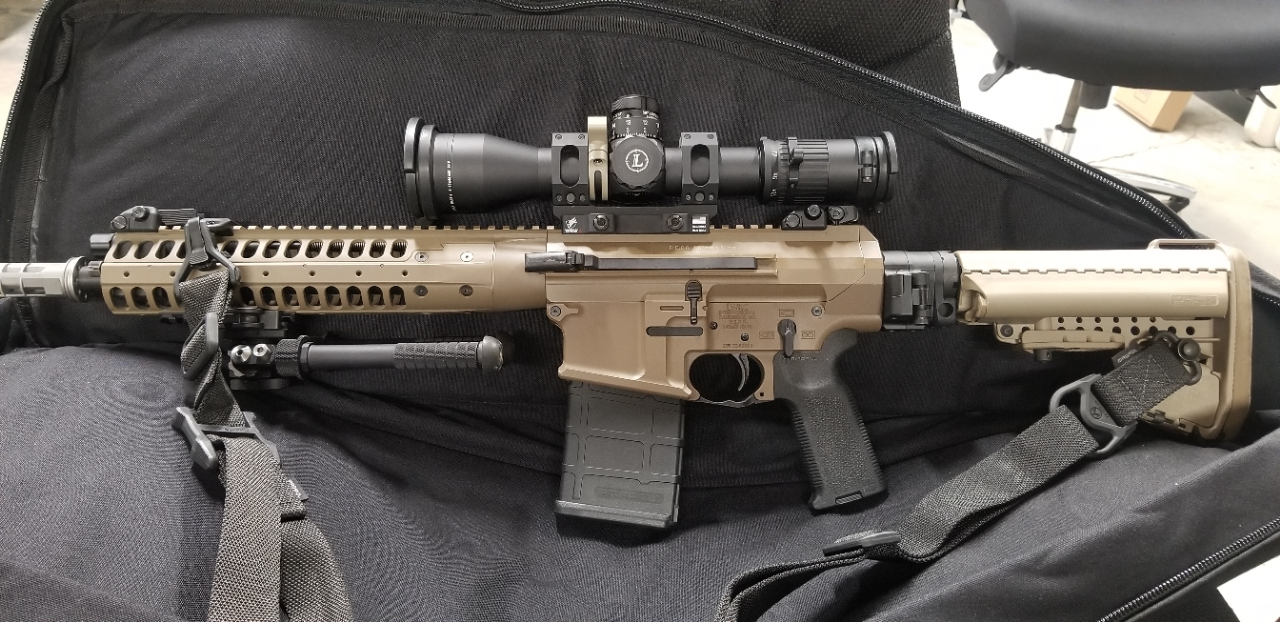

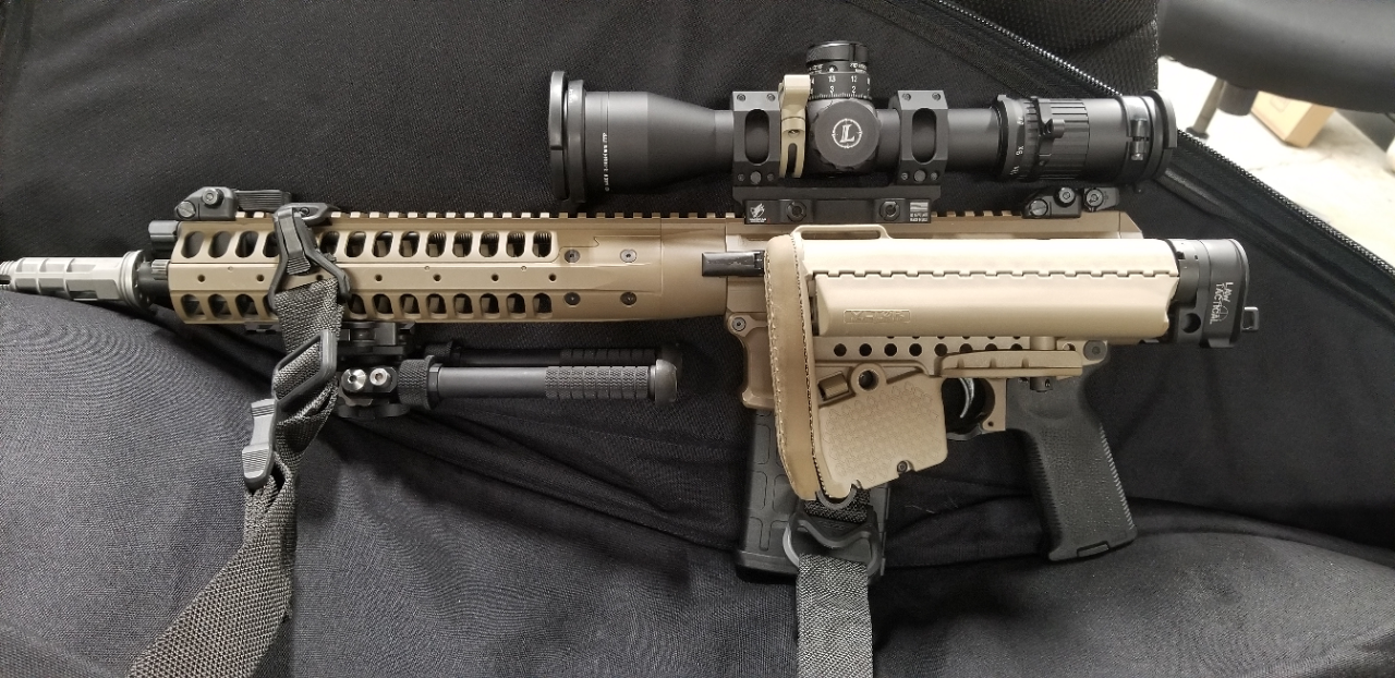

@Mntnman-TF That's the only reason I haven't ever jumped on the side charging upper bandwagon, I can't see getting jabbed in the chest by that large handle when carrying slung. Is your upper a JP or is there some other option out there for a folding handle that I'm not aware of?
If you already have the Izzy forward assist copy handle then this is an option. You do need the rails on there to install this thing. NOn reciprocating, no stabbed chest.
