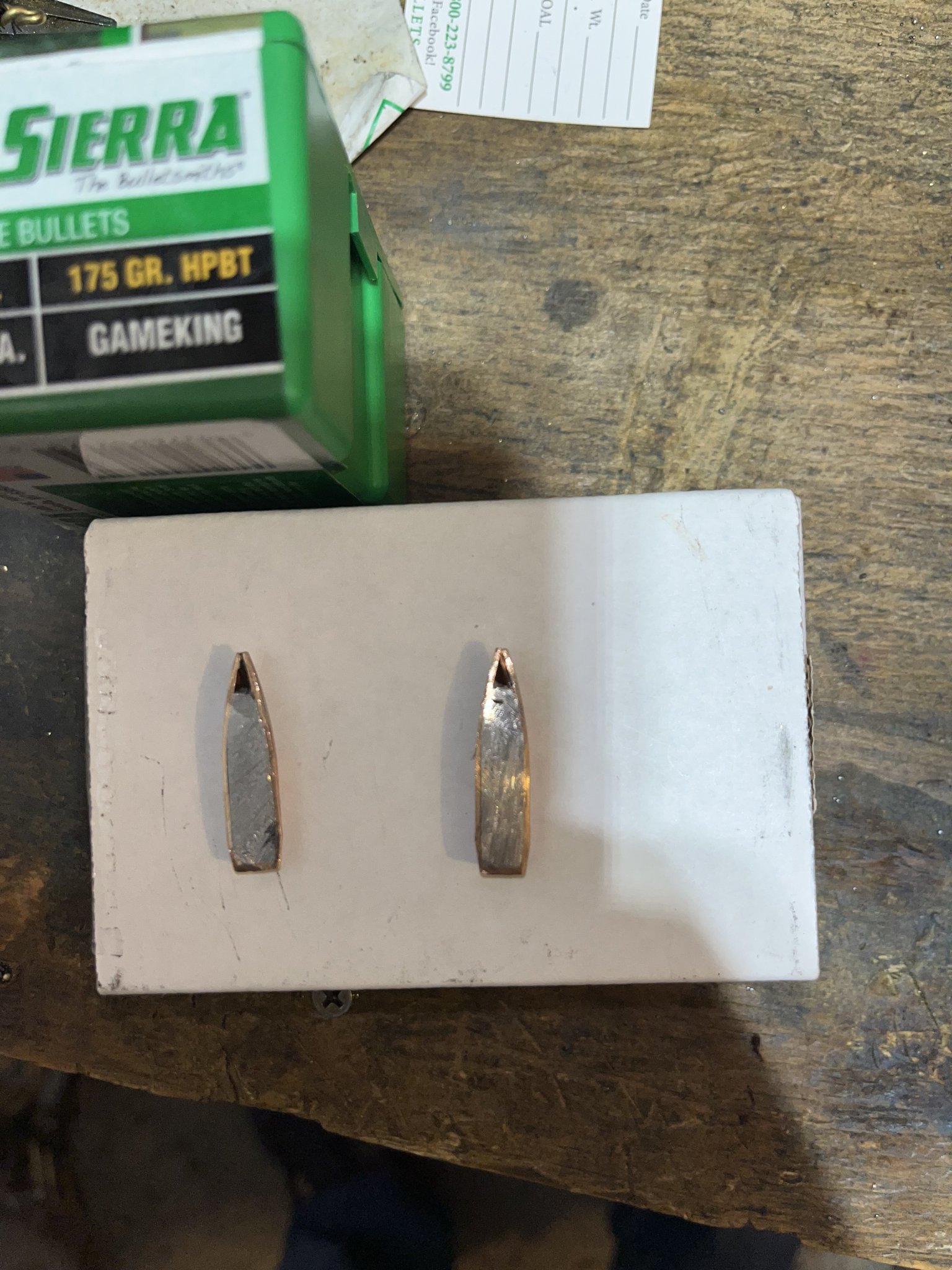

New game king on the left, regular SMK on the right. Externally the only difference I could spot is the hp on the new game king is more uniform and slightly larger diameter. People have been taking small diameter drills to the smk for years, looks similar to that. I only shot them on paper at 100 yards and they shoot just the same as the smk load the rifle is zeroed for.

Barnes TSX/LRX/TTSX bullets are even longer then the Sierra Game/Matchking bullets and don't generally tumble and yaw... why would the new gamekings in particular perform that way?
Nothing to do with length on these. When the smk yaws in the target it is because the nose becomes deformed in a not uniform way i.e. it bends at the point where there is no lead causing it to tumble or veer off course. I have seen them cause incredible damage on deer and pronghorn and I have seen them pencil through on broadside shots.
I think the idea behind these new game kings is get fluid/material in the hp to cause rapid expansion. Likely would not be suitable for body shots on anything larger than a big deer. Just my 2 shillings.
