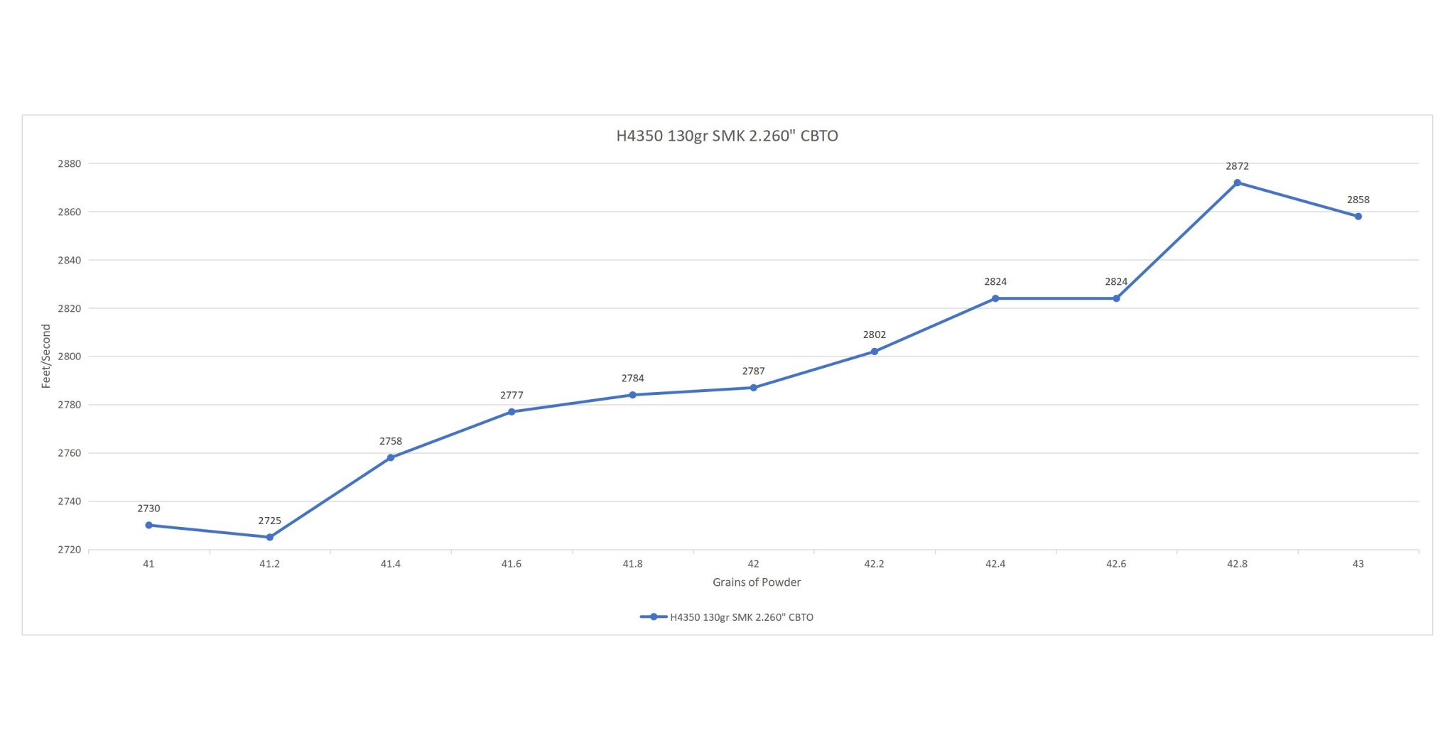

This is data I got today (60* F) with the 130 SMK's in my Tikka Tac A1, 6.5 Creedmoor. There are a couple of areas that I'd like to explore more. With the H4350, I'd like to load up 5 shot groups for 41.8gr and 42.5gr. The 41.8gr node is a wider, but I'd be interested to see the ES and SD of 42.5.

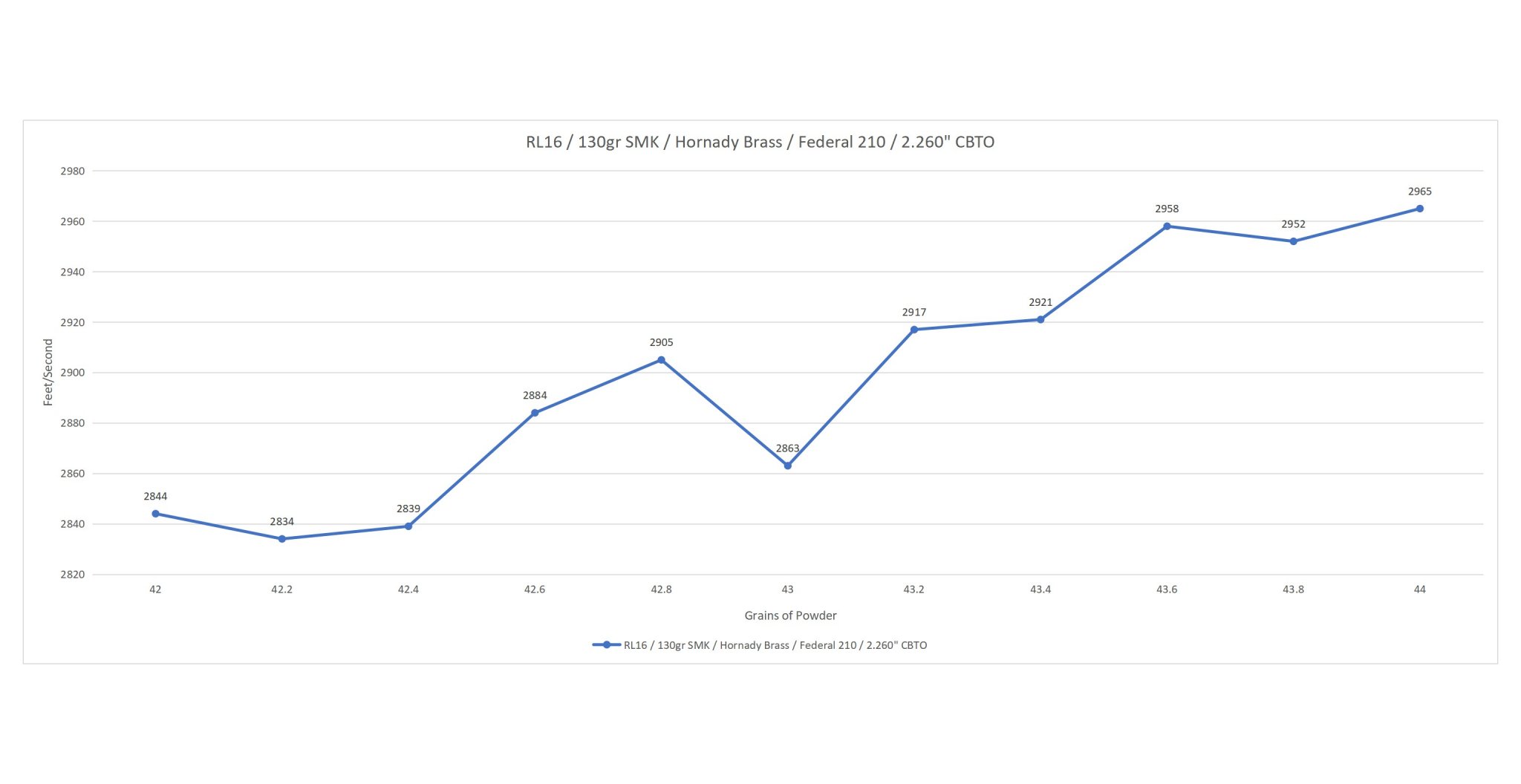

As far as the RL16 load goes, I'd like to do 3 shot groups from 42.8gr to 43.4gr. If that 43gr charge is an outlier (my mistake in loading, etc.), that makes that a very wide node. A difference of 16fps across 0.6 grains. I'd also like to do a 5 shot group at 43.8gr and look at the ES and SD there.

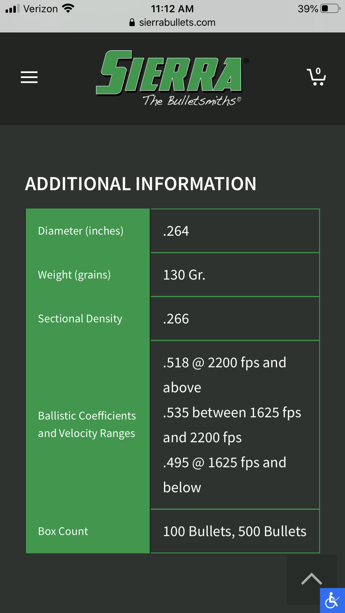

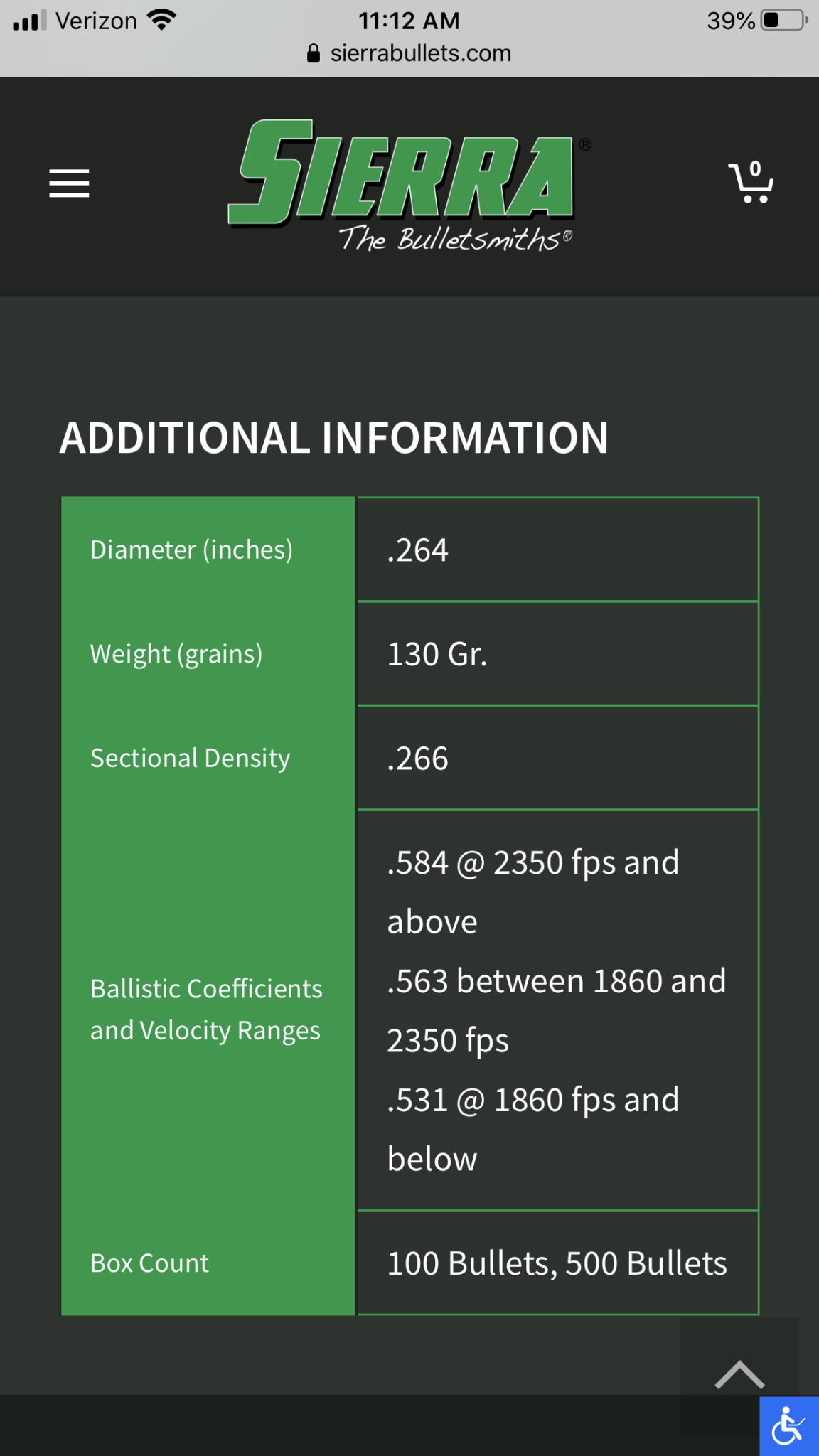

Has anyone trued this up for a solid G7 BC? 130 Hybrids trued to .290-.295 in my rifles, which was a little higher than advertised. JBM's G1->G7 conversion says it's around .290 using Padom's info for the 130 smk. Seems like the 130 hybrid is just as good, and probably better for AR mag length ammo too. Maybe you can push SMK faster though?
Thread resurrection. Just now getting around to running these to distance. Albeit had my chamber throated so going to rework the load. But I'm running them at 2815 out of my 23" tube. .584G1 plugged in AB lite was perfect. Running JBM with .292 puts me at 3/10ths above what I was dialing. Makes me think .290ish might be a little conservative.
