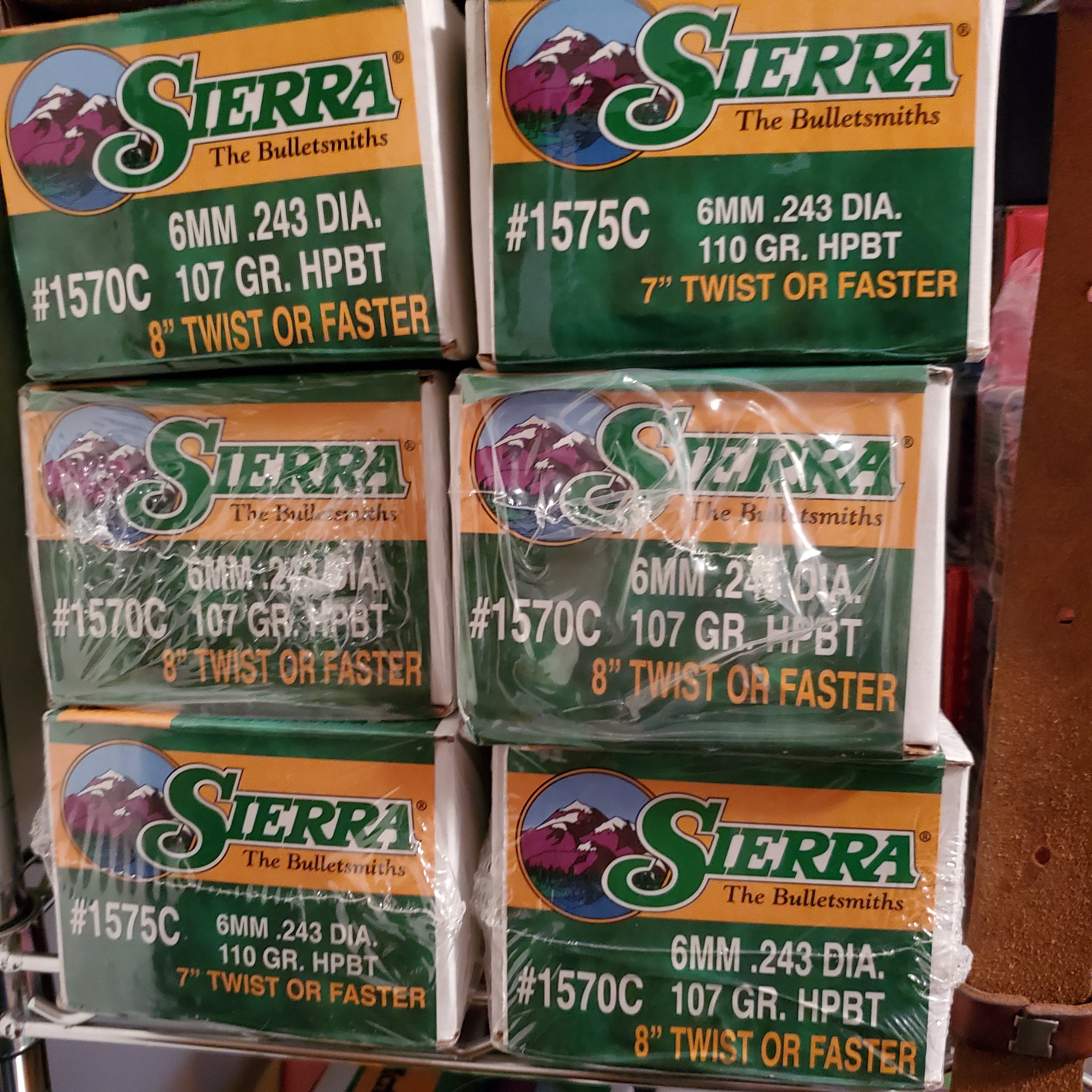

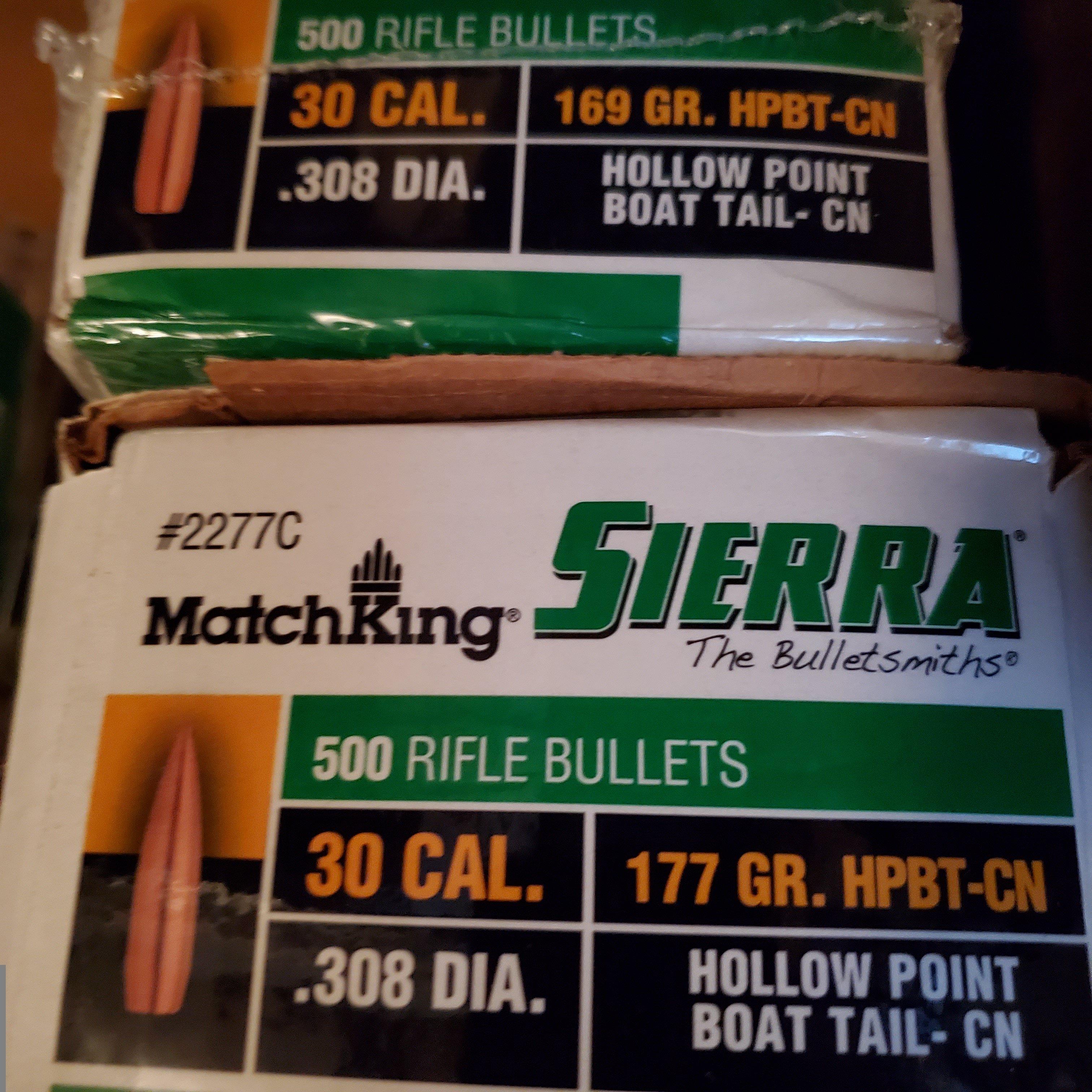

The top two boxes are not closed nose bullets, regardless of the C on the label, but the bottom one has the 9 twist recommendation, and that is the clue,... and it's a closed nose design.
The next two the 169 gr and 177 gr say CN on the box and they are closed nose design.
A faster twist on the box indicating a closed nose design with a long profile ogive...like these 200 gr and 230 gr 308s requires a fast twist.
Get to know thy bullets, and read descriptions when ordering. Old boxes new boxes, big difference in BC, profile, and twist needed in some cases.

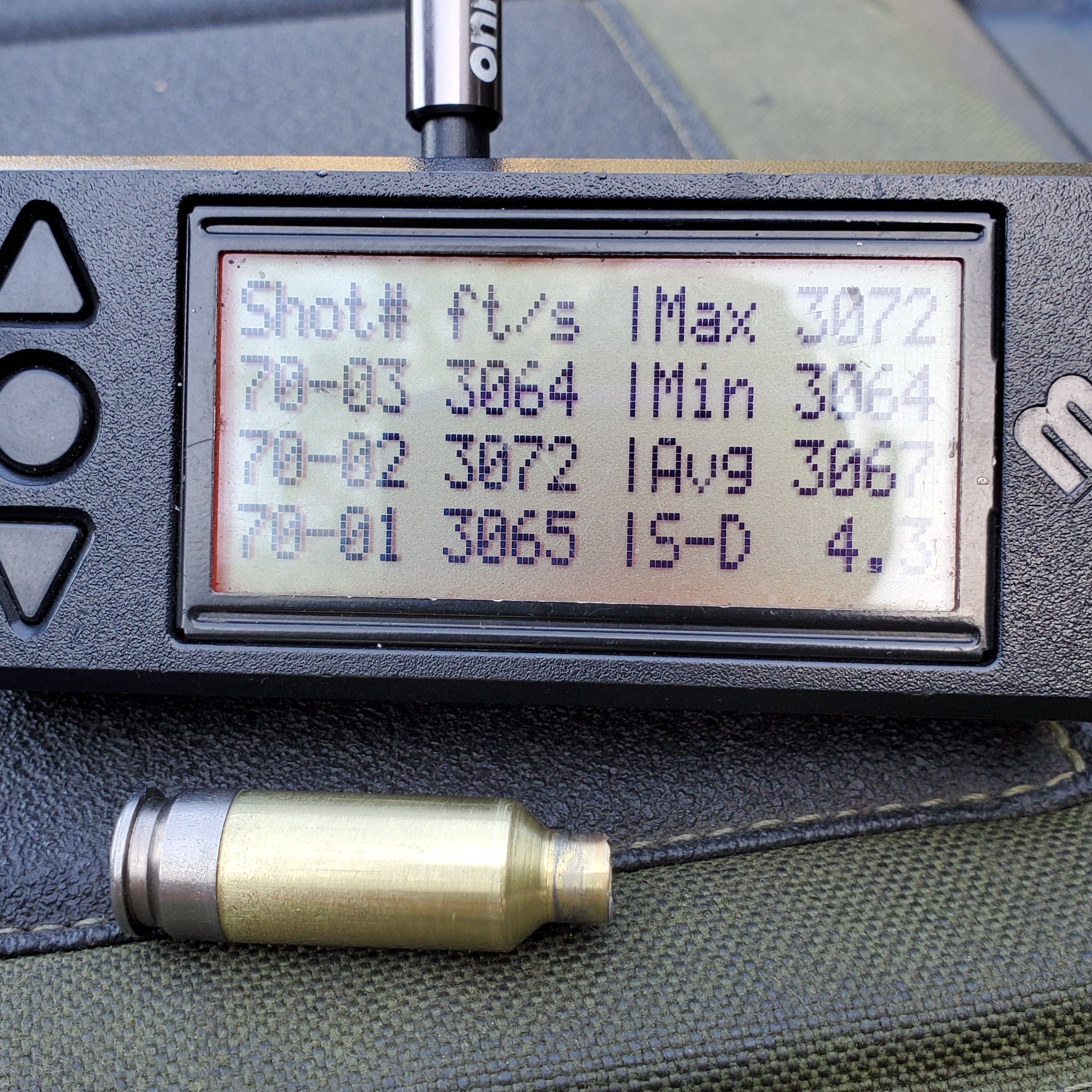

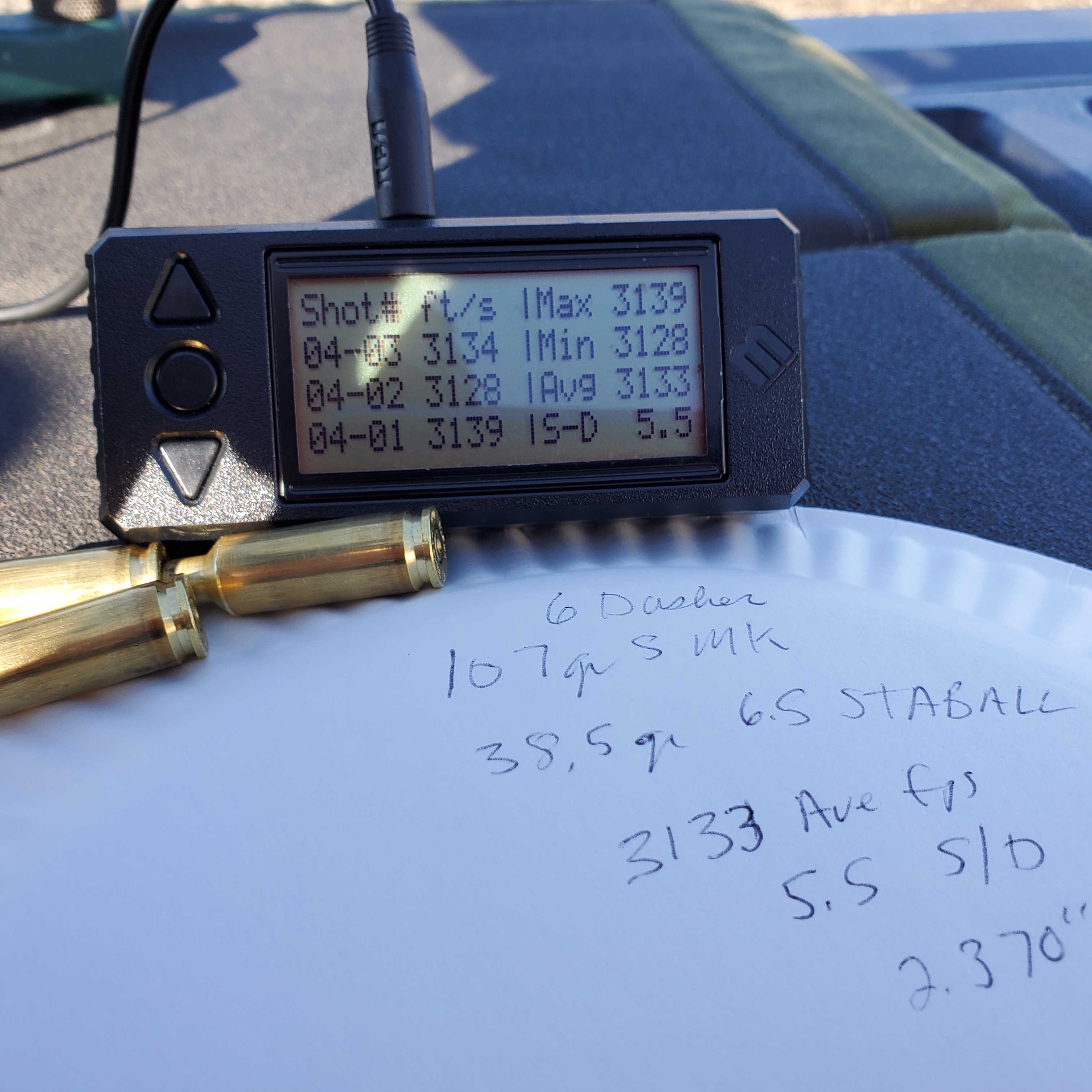

Jumped up Jesus, that's got to be hot as shit! Pretty sure 6 dasher is usually in the 2975-3025fps range. How long after firing until you can touch cases?
Yep, pretty zippy that's Alpha brass....but if ya want to go over 3200 fps with the 107 SMK ya need some hybrid cases with LR primers.

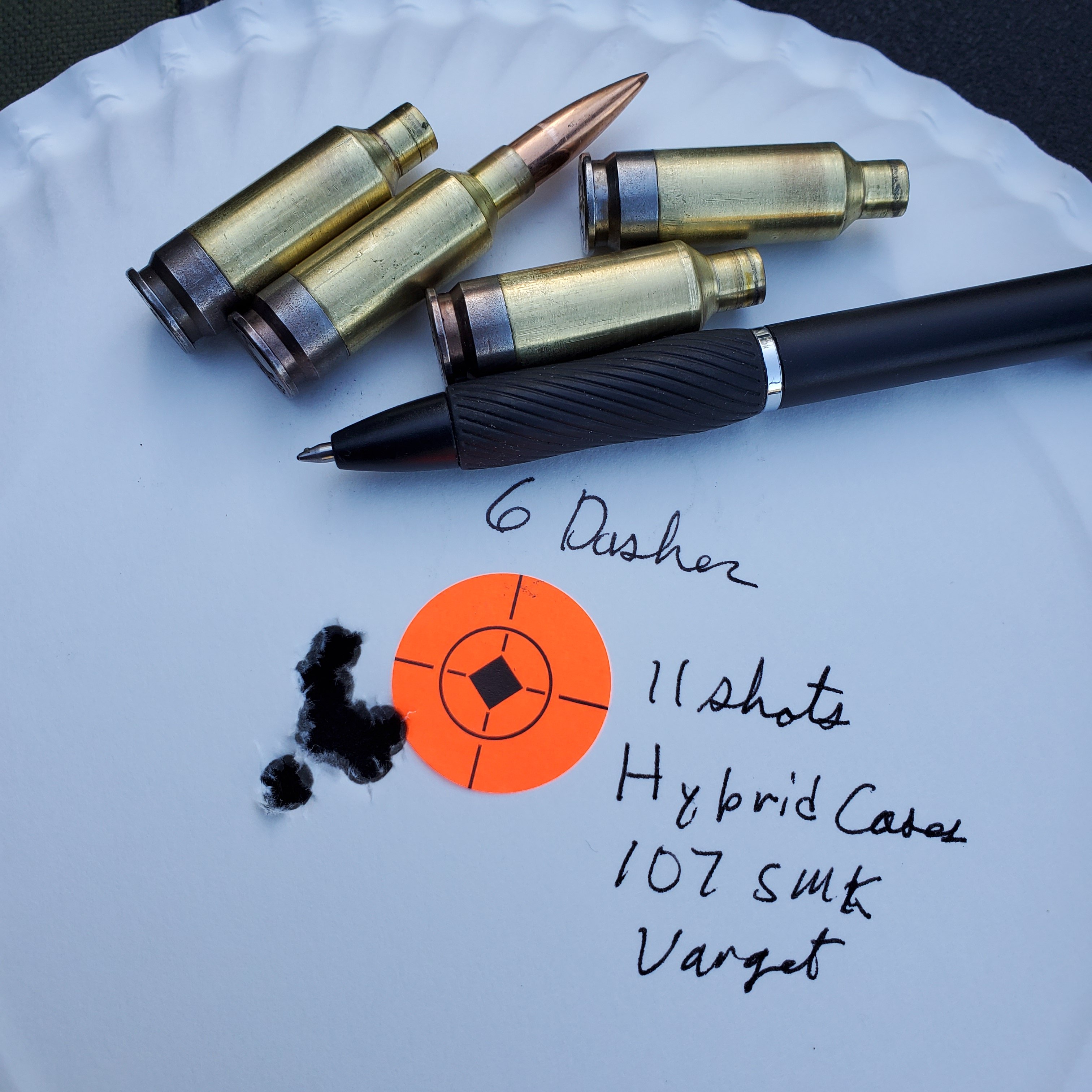

Here are some 6 Dasher hybrid LR primed cases being fireforned with Varget. Probably the first ever successful 6 Dasher hybrid cases in existence...for going really fast.

I can see the hybrid brass as a decent containment vessel for your 75-80k psi loads, pretty sure the alpha brass isn't that strong. Well I should say it's good until it's not good, which could be on any firing.
