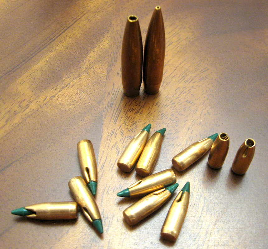

Sierra have a price sheet so you can compare the ¢/bullet to the high quality, commercial stuff, just don't forget to add about 7.5% for the local sales tax. I'd avoid the plastic tipped stuff for LR. I ended up with a lot of mis-shaped tips. Copper ogives were alright, but the plastic tips themselves were pretty bad in .204" and .224" Blitzking flavors, in my limited experience. I use those for cheap varmint blasting inside 300 yards, so as long as they explode on impact the BC isn't very important. Just remember that the cull rate might put you right back at commercial lot prices plus the time to sort out the trash.
If you have a lot of time to sort things, then the full copper jacketed HPBT kind are much more uniform than plastic tipped stuff. Sometimes you get the over-run bin, sometimes you get the tooling setup bin. One thing is you can ask to see what you're about to buy so if it just looks like it's too much of a PITA to sort, then you can pass on it.
I'm not ripping on Sierra. For the record I didn't bother sorting about 15lb of .224" 69gr Matchking and they shot great, well enough that I'm down to my last 250ct that i've been using in the local steel matches (average match yardage is 450-550).
Here's the worst of some .204" 40gr and a couple .284" 175gr HPBTs One's fine, the other has a messed up meplat:
