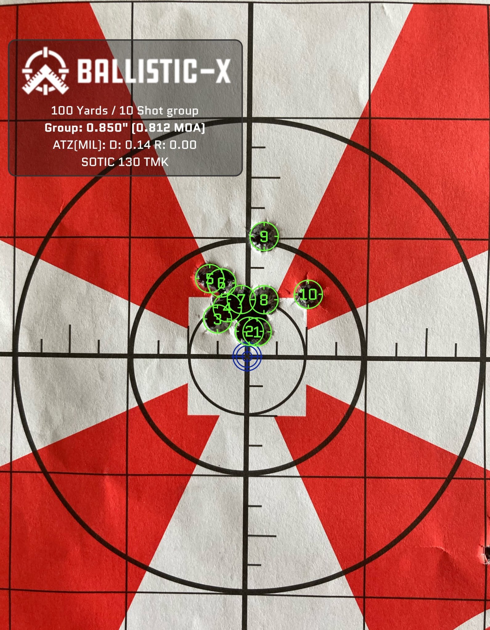

I just loaded some 130 TMK because it's what I could find. I've got some 130 Berger coming, and (I think) some 140s...because I cannot leave well enough alone. Of course, now it's time to backorder something while I can...could do Hornady 140s...because they just flat work in my rifle...or, I could go 130 TMK. The Bergers are for academic purposes...I don't shoot well enough or reload well enough to justify a marginal potential improvement in bullet consistency.
My KRG SOTIC, 22", SAAMI chamber (about .100" of jump), COL of 2.8" COL of 2.811 or so, 43 grains of H4350, and Fed LR primer is what I've got to mess with at the moment. It's around 2865 fps, pending further eval of a larger sample. I didn't read the above before I loaded my first batch, but it would have saved me some time, clearly.
ETA: note to self - don't forget a seating depth test, and definitely don't load 100+ rounds before you do one. I changed my COL in a quest to dial things in a little. I banged out (with a inertial puller) 10 loaded rounds and the re-seated to ~-14 vs. -25 indicated on my Whidden seating die...mostly to see if they'd function (worried about primer compromise). I know Sierra stuff is supposed to be easy to tune...but, my windows for seating depth are maybe .006" wide.
Attached is where I ended up, offered without excuses. I need more time at the range a lot more than I need more time at the bench...though both are required.
