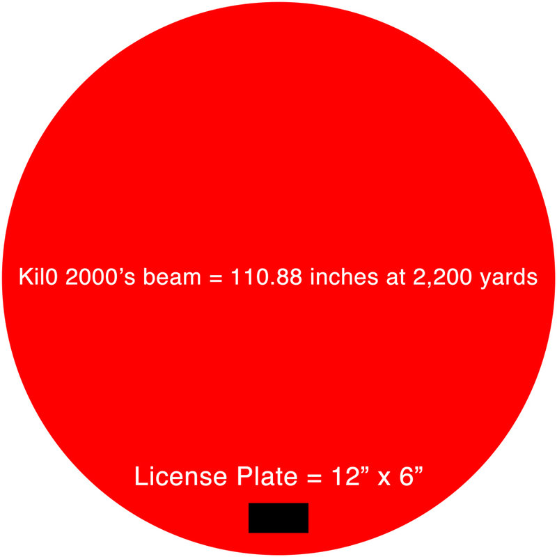

This might help visualizing what I'm actually talking about. And why I find it hard to believe the Kilo can return a reading on JUST a license plate at 2,200 yards. Because the device isn't seeing the license plate. It's seeing everything else around it (i.e. a car). I believe one can range a car at that distance. But I don't believe it when someone says they can range the plate, by itself. If you're hanging a license plate on a pole or from your steel target, I still don't believe it. Farthest I've shot is 1580 yards. And my unit couldn't range off a highly reflective, gloss white, steel target that was 12" x 18". I could range the ground below the target, though. And that's how I was able to range at that distance. But you're saying if you hang just a license plate up on a pole at 2,200 yards, the Kilo can range it? I'd love to see a video proving that. Not calling anybody a liar. I am just very skeptical.
Area of the beam at 2,200 yards = 9655.98 square inches.
Area of license plate = 72 square inches.
That means a license plate takes up only 0.74% of the Kilo's beam. Math doesn't lie here. That's not large enough to return a reading.

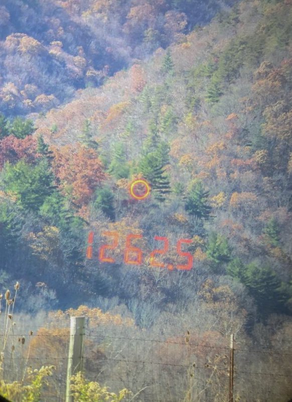

One last thing - an actual picture, taken with my iPhone, of a cedar tree (the only object in the area that would give a return..color wheels and complementary colors) at 1262.5 yards, literally at nautical noon, taken last November. Just offered as a performance comparison, discussions of beam size aside.
