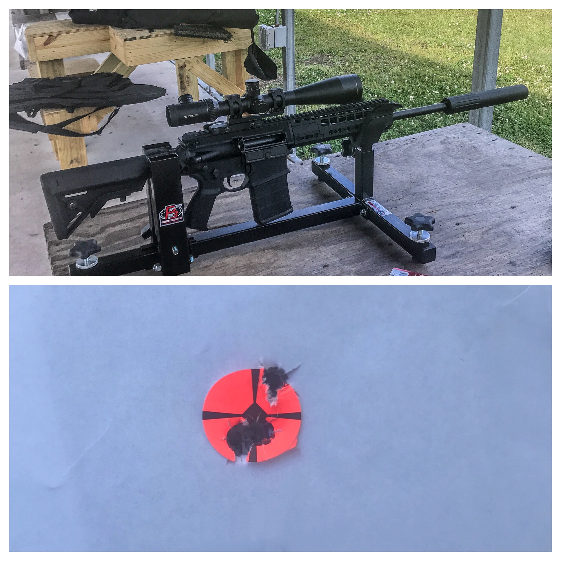

So I just purchased a Sig 716 G2 patrol. I immediately changed the trigger to SSA-E trigger and installed AAC Blackout brake so I can use my 762-SD can with it. Today I took it to the range to test it out and compare it against my trusty POF 308 14.5” setup who has been a hammer.
I purchased 3 sets of ammo to try different variety:
1) Hornady Superperformance Match 175gr
2) Federal Gold March 7.62 NATO 175 GT
3) Federal Gold Match 308 Win 175gr
I used a CTK Precision ultimate gun rest/vise since this was to compare the two I wanted to remove all variables as much as possible. The same Viper PST 6-24x scope was used on both.
The Sig performed poorly. The best group I got was a little over 2” at 100yards with Federal Gold 308 win. The NATO version got worse and Hornady was close to a 3” group. I am just dumb founded on how bad it was.
The POF was a hammer as always. It did best with Federal Gold. Both 308 win and 7.62 NATO were identical in accuracy. All shots were sub-MOA with both. Hornady the group opened up to about 1.5”.
I did have the Magneto chrono and this is how they did. The 7.62 NATO version of Federal good is def loaded hotter cause with both guns it was faster by a good amount. The Hornady was the fastest but neither rifle liked this particular load. Here are the velocities :
POF 14.5”
Hornady Superperformnace Match
2496, 2499,2496
Federal gold match 7.62 NATO
2389,2411,2404
Federal Gold Match 308 win
2347, 2353, 2368
Sig 716 G2 16”
Hornady Super Match
2555, 2552, 2579
Federal gold 7.62 NATO
2494, 2480, 2489
Federal gold match 308 win
2408,2396, 2401
I have attached the target with the Federal Gold 7.62 NATO. I didn’t even bother taking pix of the Sig cause I was kind of sick to my stomach pissed. Do you guys suggest I contact Sig with this ?

None of the accuracy testing was shot using the can. The picture was taken after the accuracy part of the day was already over.
