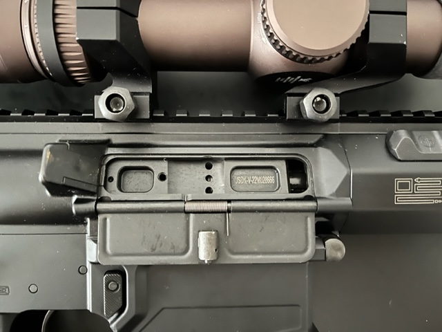

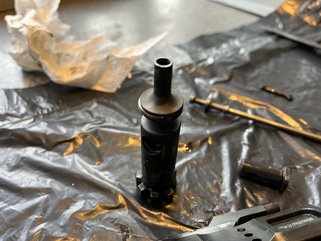

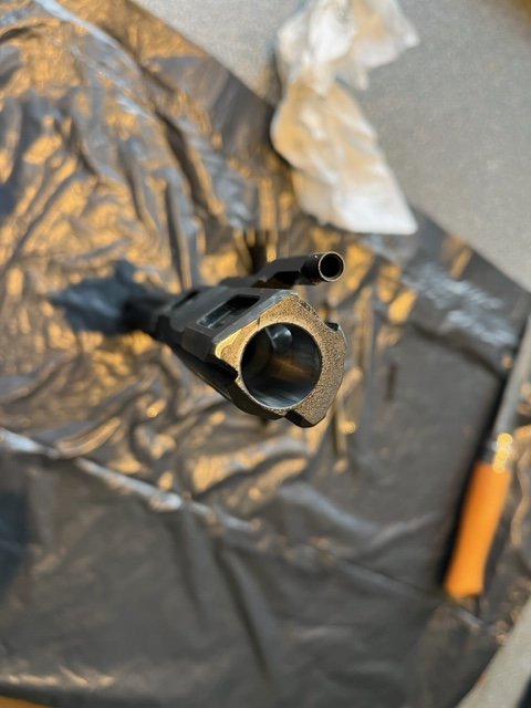

Hi All
I have a SIG 716i Tread that I'm very happy with.
Very accurate (1 MOA with quality match ammo).
However it starts to have a sticky bolt (the internal piston becomes difficult to move) after just 50 rounds,
after 100-150 rounds I will need to mortar the rifle to get the rounds and it will not reliably feed from the magazine.
I usually shoot the rifle with a ASE UTRA Dual 762 short BL low flow suppressor.
I don't think it's creating too much back pressure and the bolt piston does not seem very dirty after firing.
I put small amounts of oil on the gas rings (keeping them dry makes the issue worse).
What do you think could be the issue?

The 716 I have. The bolt interface with the bolt carrier is extremely tight. It might be the gas rings are too tight. Put a good coat of gun grease on the bolt body, the lugs and inside the carrier. Rack it 10-15 times. Check to see if that has loosened the bolt in the carrier. Clean and repeat if necessary. Put twenty fgmm 175 clones through it and it is still stiff but have not had the same issue as the op.
Could be that it's just unusually stiff. I have tried to polish the gas rings and will check if they get smoother
Prefer grease over oils. I like this stuff, but other companies like Boretech make grease for the same application. Smells tasty.

Honestly it's probably the suppressor, you might need to run a heavier buffer spring and keep it lubed to hell and back. It looks kinda dry in the pics.

1000% this I didn't take a good look at the pics but yeah it's way way to dry especially for a gun you are trying to break in.
Clean the bolt carrier where the bolt goes and the cam path and pin and check the barrel extension and wipe any crud out of there. After cleaning You can separate the upper and lower and remove the charging handle and slide the bolt back and forth and check for binding.

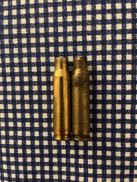

Long time since the last update, but I have finally resolved the issue.
The main fix was replacing the standard SIG gas block. This gas block is basically open and with a suppressor is way to dirty in the internal piston. I replaced it with an SLR 7 0.750"gasblock.
This made a huge difference, see picture below. The left case is after the gas block replacement and the right one is before.
After about 100 rounds the cases were covered in carbon fouling.
The other was replacing the standard SIG helical gas ring with 3 individual rings from Sprinco AR-10.
They do not fit as is, I had to reduce the thickness on waterstones to get all 3 to fit.
